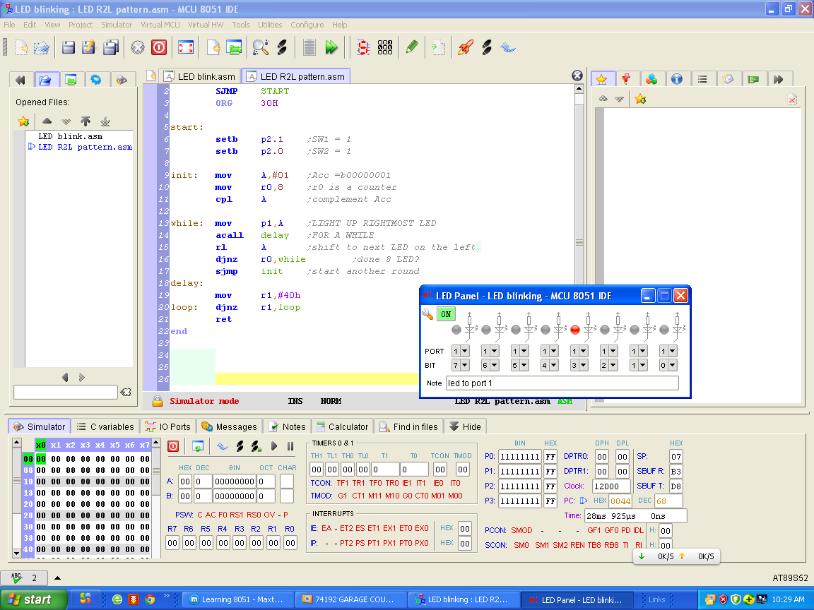

Here's my first program on stepping the LEDs on Port1 from right to left..

Ian, is there any particular reason that you left a hole between 0000h to 0030h?

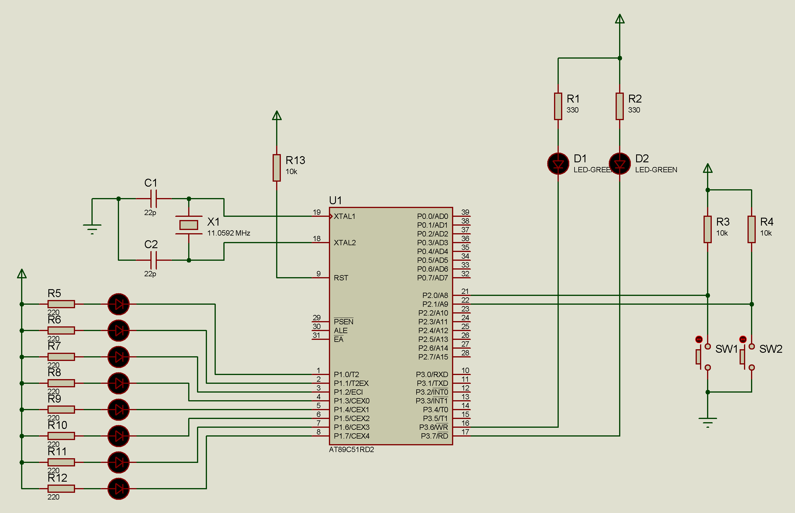

My development board schematic
I have drawn the schematics for my 89S52 development board. It would be constructed on stripboard once the board is layout properly. I'll add a 7805 power supply and the socket for ISP programmer later..

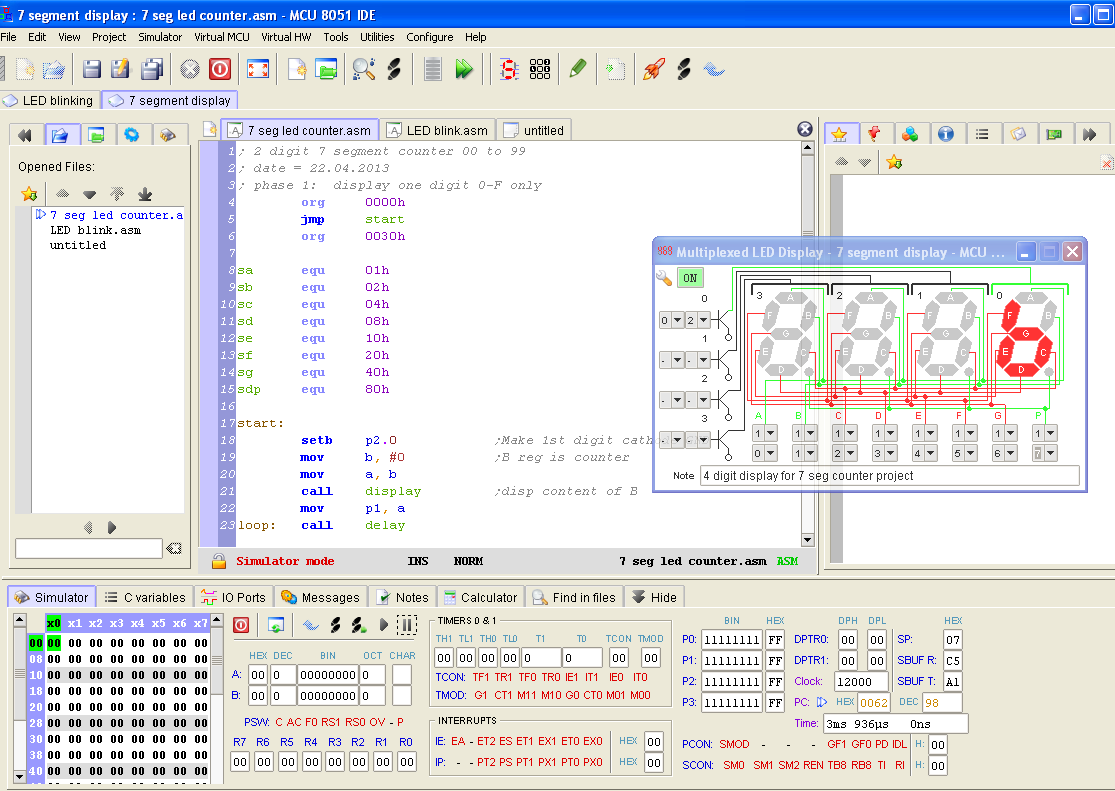

I have made one digit displaying on the 4 digit multiplexed display. The code is as follows:

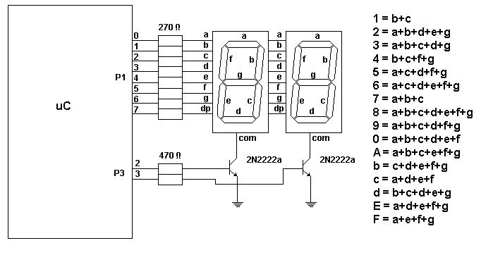

It took me some time to figure out how to change the display from common Anode to common Cathode. ;)
If I want to display 2 digits. How long do I have to let the digit "ON" before switching to the next digit to have a continuous display? Is 20mS enough to fool our eyes?

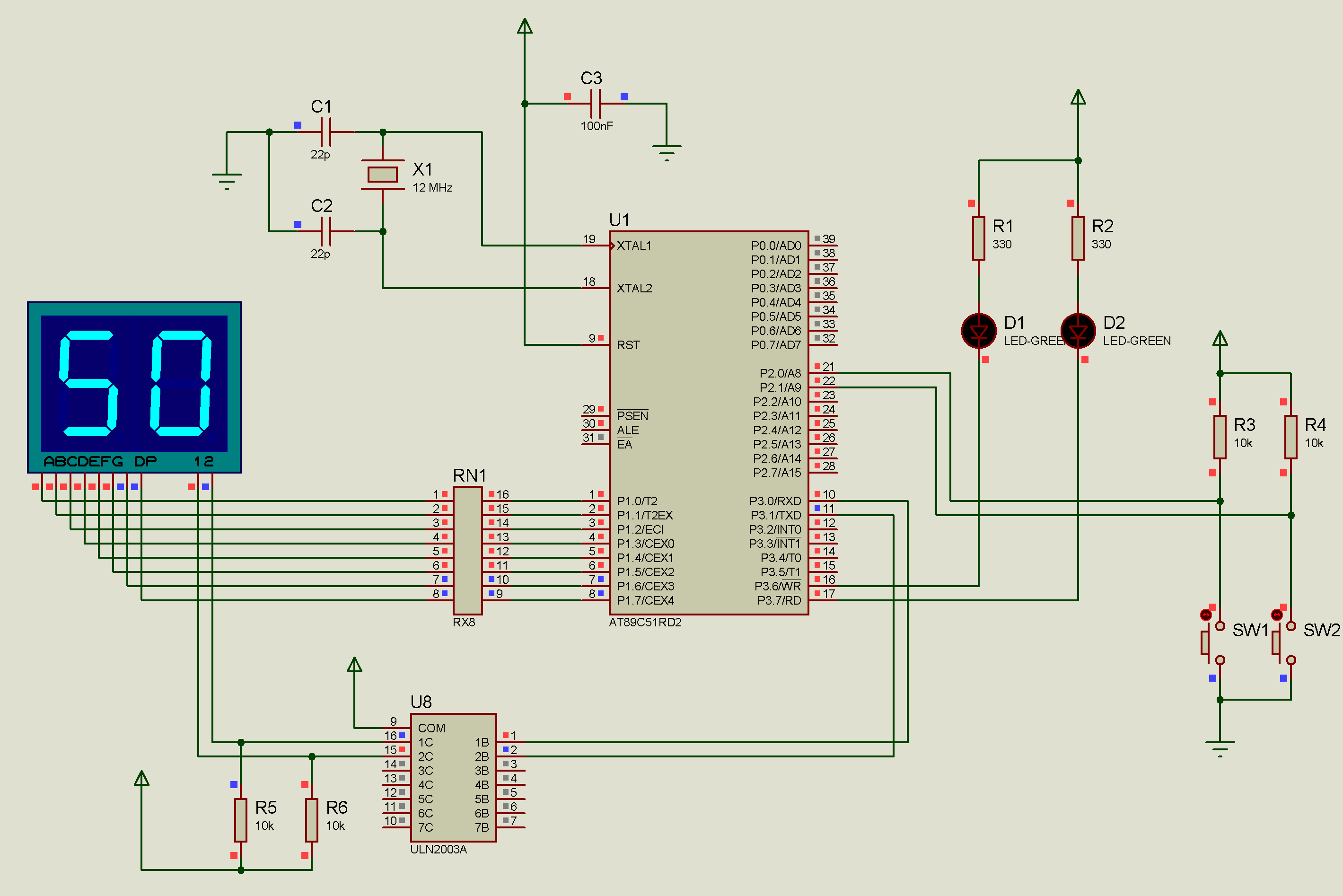

Dual 7 segment display is ready

The above code is for dual digit display but the output doesn't look good on simulator. I'll try it on real hardware when my PCB and chip are ready.

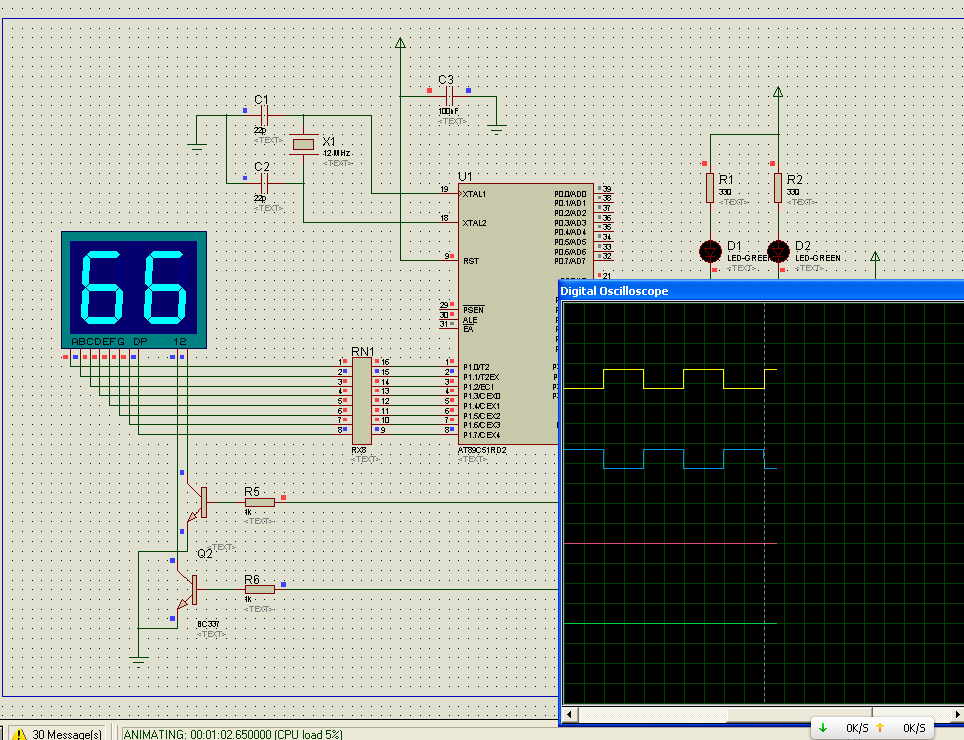

I am stuck with my interrupt driven 7-segment display. And this is my approach:
First I'd create a 10mS interrupt using timer 1. And since there are 2 digit to display, I will make them display alternately - 10mS for unit digit and 10mS for tenth digit. In that case I need a single bit variable called 'D_Flag' defined at 20H.0 of the RAM.
On entering the interrupt , it will be toggled. If it is "0", then unit digit would be displayed, and "1" the tenth digit would be displayed. The main loop would be just just incrementing the counter, converting the digits to 7-seg patterns and store it. How does it sound? Would this scheme work?
Here is the ISR code:
T1_ISR:
PUSH A
PUSH PSW
PUSH DPH
PUSH DPL
clr TR1 ;stop timer1
mov TL1,sav_tl1 ;restore t1
mov TH1,sav_th1
setb TR1 ;start timer1
cpl d_flag ;toggle d_flag
jb d_flag,upper ;1=upper 0=lower
lower: clr p3.0 ;switch off both digits
clr p3.1
mov p1,unit_dig ;get new value
setb p3.0 ;turn on lower digit
sjmp isr_exit
upper: clr p3.0 ;switch off both digits
clr p3.1
mov p1,ten_dig ;get new value
setb p3.1 ;turn on upper digit
isr_exit:
clr TF1 ;clear timer1 flag
POP DPL
POP DPH
POP PSW
POP A
reti
Allen

Here is the complete code. It compiles well but crashes after a while . I haven't found out the cause yet ...... Could it be due to my ISR giving the problem?

But on simulation I found that both the ubit and tenth digits displayed are the same. May be it was due to the simulator was too slow and cannot catch up with the display rate. Anyway I will wire it up on a breadboard to test it on the real hardware.
Allen
You delays are WAY to small.... about 130uS to be precise...
I've uped it a tad.. Its now watchable...

Ian, thanks for the fine tuning of my code. I just simulated it again and it displays perfectly.
Thanks again for helping. My next project would be to let it do the multiplication tables as I have mentioned in my previous post. I want to learn how to use the "MULT" and "DIV" instructions.
BTW, how would I access the the RAM above 0x7F? Do I have to use R0 and R1 in mov A,@Ri to access that area of RAM? That would be very troublesome and would take a lot of instruction cycles in order to access on those RAM locations.
Allen
