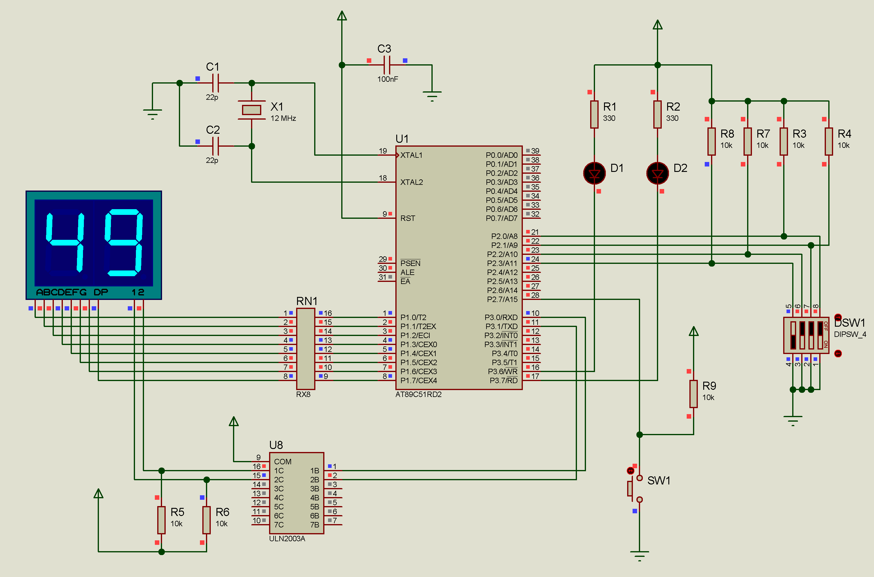

I attach here with the circuit for doing multiplication.
The DIP switches on P2.0-P2.3 are used for the multiplier in binary format. The button at P2.7 is used to step the multiplicand from 2 - 16. For each push of the button, the multiplicand would increment by 1.
The result is displayed on the 7-segment LED. If the result is greater than 99, it would stop. I am not sure if a reset button is needed. I would know this once I complete the flowchart.

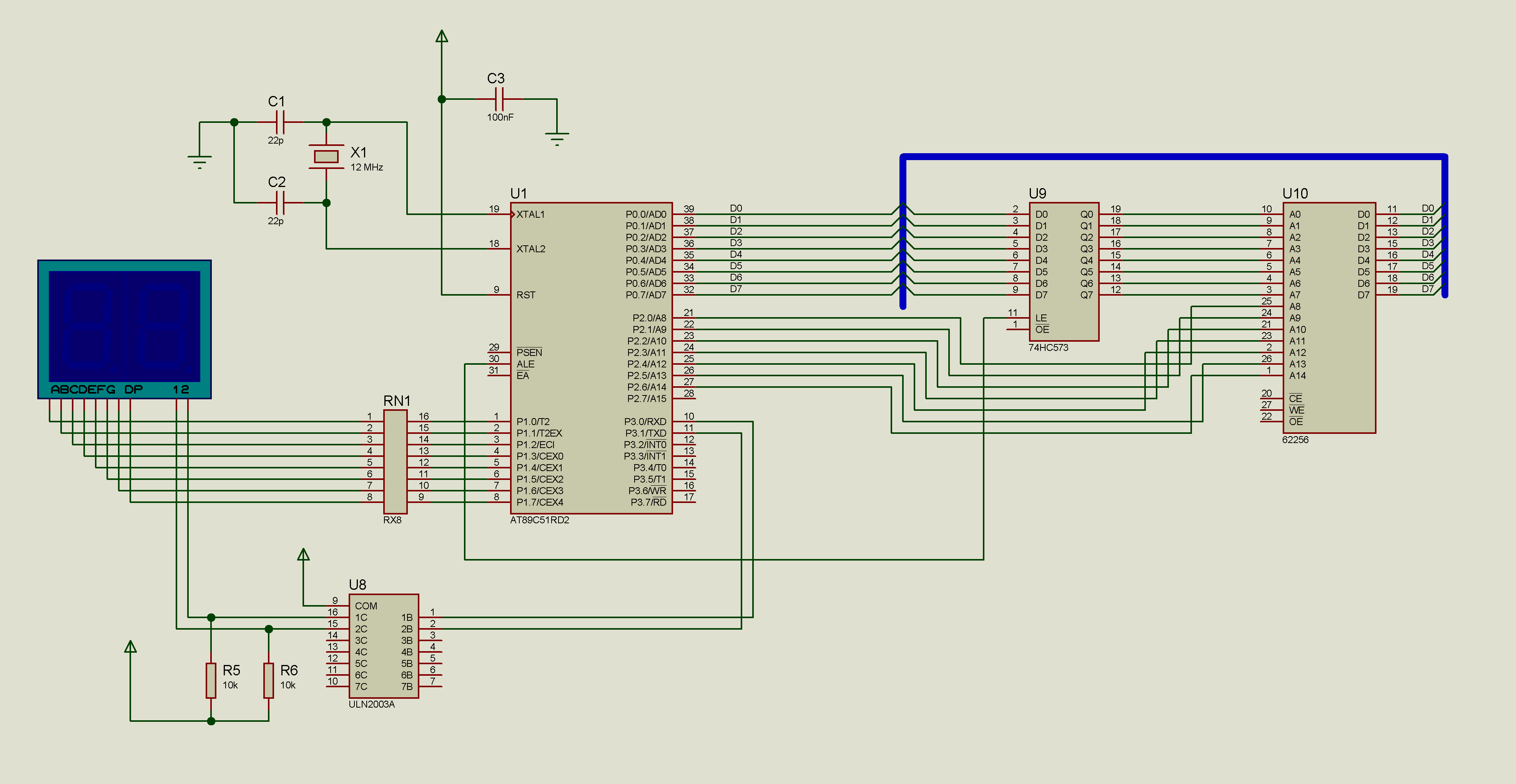

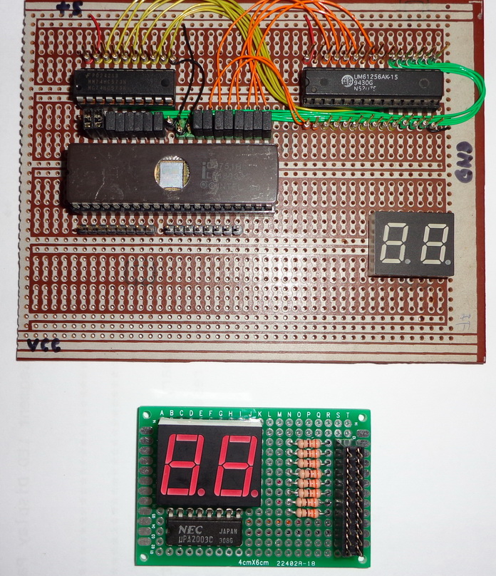

Next I would include a 32x8 SRAM interface to the 8051 P0 & P2 using 74HC573. My 89S52 just arrived yesterday and I am busy working on the PCB.
Allen

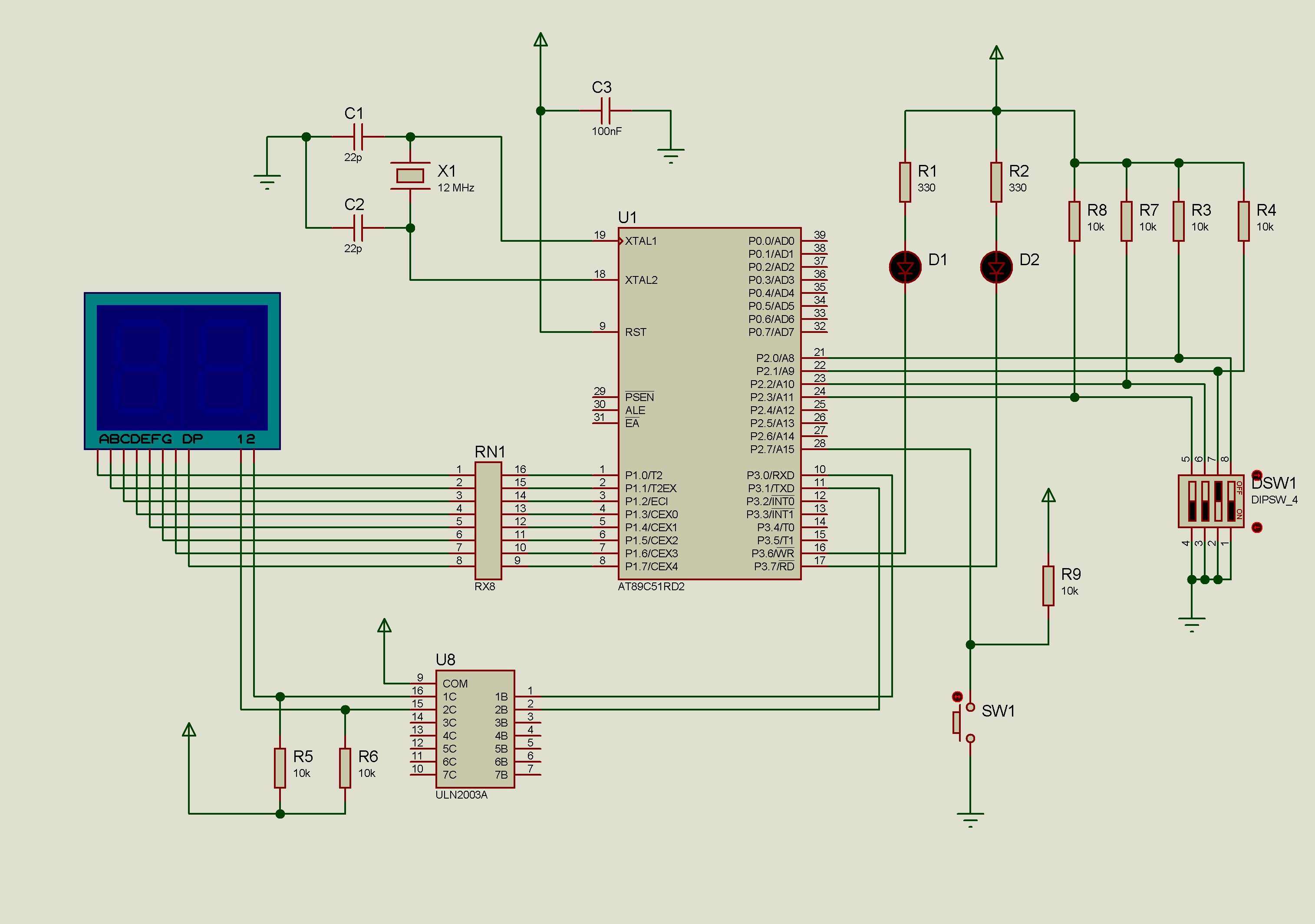

I'm working up a code example for you right now. Is your segment display common cathode or common anode?
Thanks for helping. They are common cathode display as in the schematic attached.
Allen
OK...this code does not contain anything that will drive the display yet. But what it does do is convert a value that is in the accumulator (ACC) to BCD, stores the 3 BCD bytes in registers HUND, TEN and ONE for the hundreds, tens and ones place digits, then converts them to LED display segment data and stores the segment pattern data for each digit in registers HUND, TEN and ONE. You will see that a look up table for the segment data was used to convert BCD to segment data, while the BCD values were used to call the appropriate table line for each digit's segment pattern data -

setb TR1 ;start timer1
cpl d_flag ;toggle d_flag
jb d_flag,upper ;1=upper 0=lower
lower: clr p3.0 ;switch off both digits
clr p3.1
mov p1,unit_dig ;get new value
setb p3.0 ;turn on lower digit
sjmp isr_exit
upper: clr p3.0 ;switch off both digits
clr p3.1
mov p1,ten_dig ;get new value
setb p3.1 ;turn on upper digit
isr_exit:
clr TF1 ;clear timer1 flag
POP DPL
POP DPH
POP PSW
POP ACC
reti
; 7 segment pattern table
table: db sa+sb+sc+sd+se+sf ; 0
db sb+sc ; 1
db sa+sb+sg+se+sd ; 2
db sa+sb+sc+sd+sg ; 3
db sb+sc+sf+sg ; 4
db sa+sc+sd+sf+sg ; 5
db sa+sc+sd+se+sf+sg ; 6
db sa+sb+sc ; 7
db sa+sb+sc+sd+se+sf+sg ; 8
db sa+sb+sc+sd+sf+sg ; 9
delay_200ms:
mov r4,#0ffh
sjmp delay
delay_20ms:
mov r4,#1
loop0: djnz r4,loop0
ret
delay:
loop2: mov r5,#04Fh
loop1: djnz r5,loop1
djnz r4,loop1
ret
end
Allen
Attached is my 8051 development board with 32Kx8 SRAM 61256.
Where do the 3 wires on the SRAM ie. /OE, /WR & /CE go to?
Can I leave the /EA & /PSEN not connected? I know I need to put 10K pullup resistors on port 0. The schematic is done in a rush.
Allen
