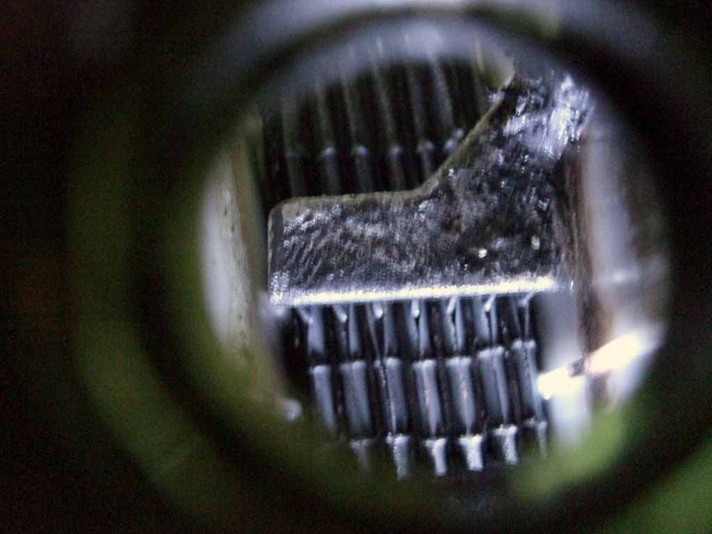

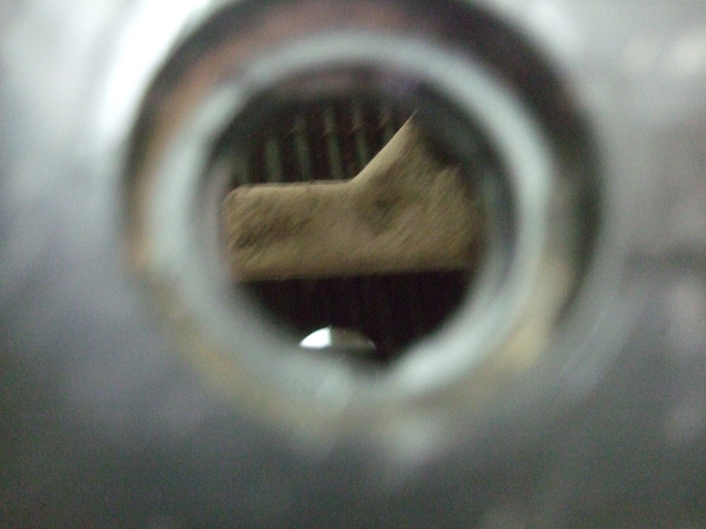

Here are the before and after pics of the worst cell's (cell #2) negative busbar. The changes are similar across all the others.
BEFORE
AFTER
The white 'glare' on the lower edge of the bar is due to the lighting on a smooth metallic surface causing an image 'bloom' note that this effect is mostly absent in the matte 'snowy' sulphate coating of the first pic. I achieve lighting thru the white translucent side housing of the battery. black batteries don't allow that flexibility.
There are still small bits of white salts here and there...on the surface of the bar. Usually these will dissolve once the battery is placed into proper service and properly maintained...equalization etc. Since the top of the busbar would receive the least improvement as it is out of the direct pulse path circuit, I would think that the plates are in better shape, sulfate wise.
I will take one more pic of the bar AFTER a full discharge/recharge cycle, to document any more improvements. The recharge will NOT be a pulse charge but a normal unit.

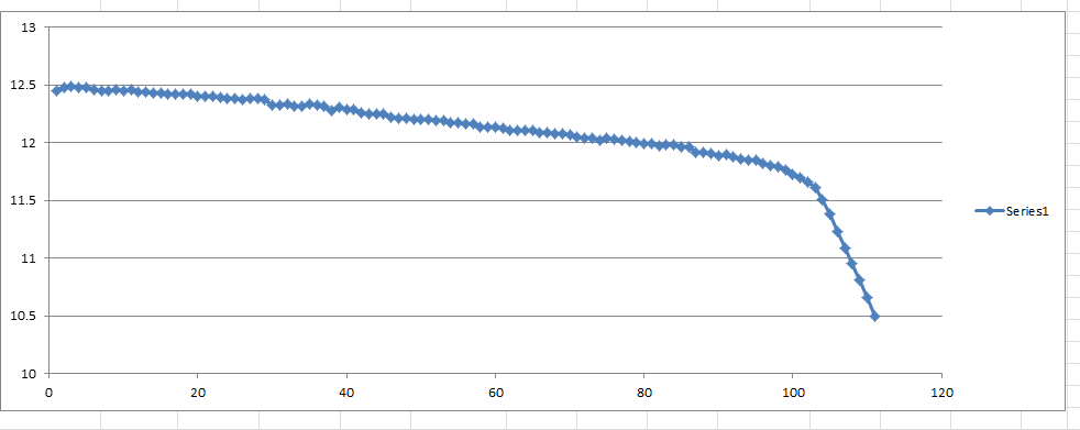

The full discharge Ah rating of the recovered battery is 27Ah or 65% capacity. It'll prob. achieve 30Ah after a couple charge/discharge cycles improves the amorphous nature of the grid paste plates, this was compromised by the crystalline sulphation. Not bad for a basket case battery, it is suitable for a sub/compact car application as those come with 30 to 35Ah rated batteries when new. There is some corrosion on the internal anode pole and bus bars but nothing major.
Discharge curve,Y = Voltage, X axis is # of samples (225 sec each). 3.8Ah average discharge load.
