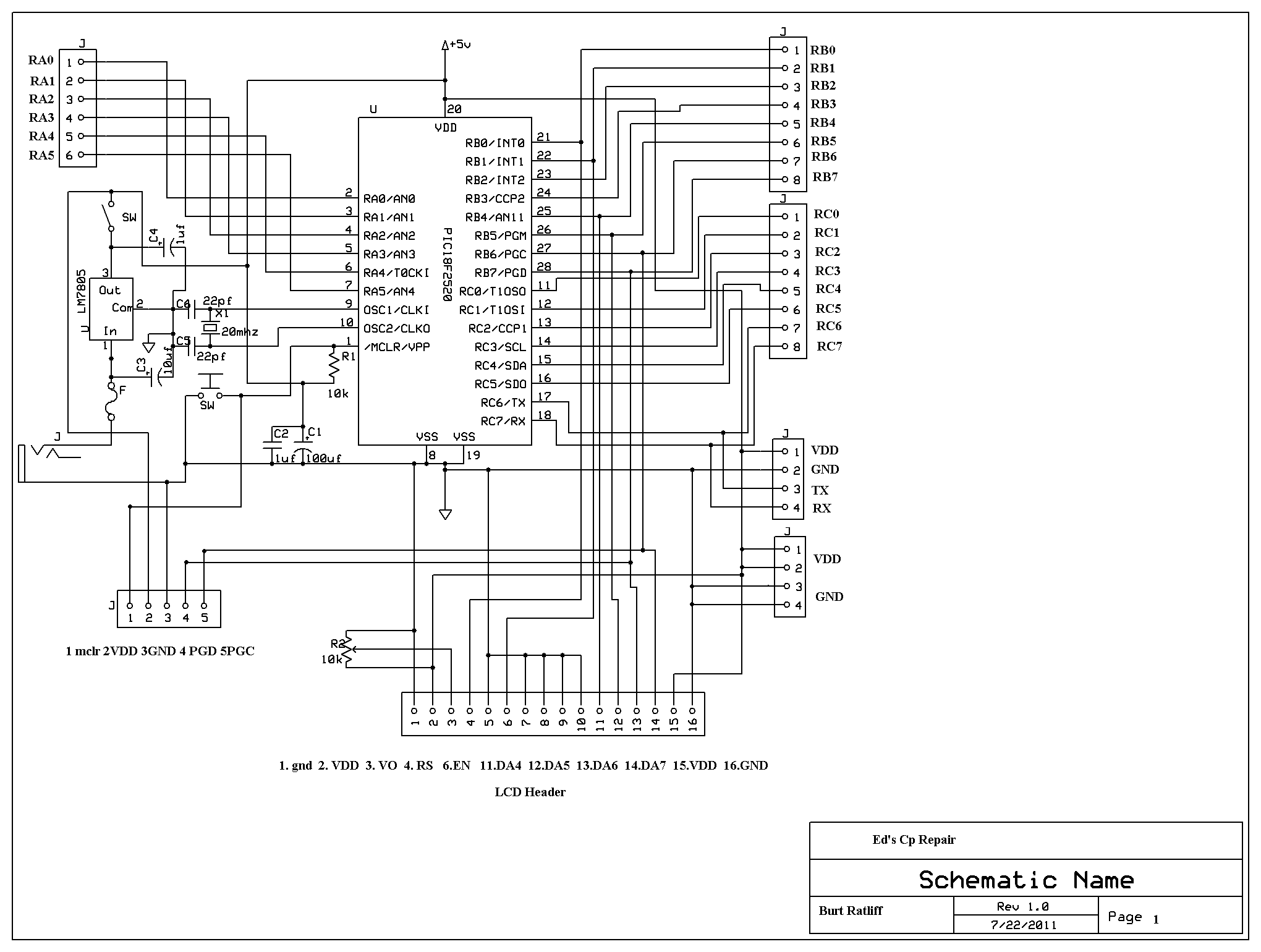

You hook the LCD up like this
Portb.0 to lcd data4
Portb.1 to lcd data5
Portb.2 to lcd data6
Portb.3 to lcd data7
LCD_RS to PORTC.5
LCD_EN to PORTC.6
LCD_VO to a pot center tap top a VDD and Bottom at GND
LCD_VSS to GND
LCD_VDD to 5 volt
LCD_backlite A to 5 volts
LCD_backlite K to GND may need a 120 ohm resistor some have one on the LCD
And gnd the unused pins RW, Data0, Data1, Data2, Data3.
Only difference I have is a 330 ohm resistor on pin 15 and the unused data pins are not connected to anything.
I have had this display working along time ago.

Tested everything but still?
My next trick is --start over. Build a new LCD board then start from scratch
MrDeb I did this last night have a look it's a simple board you should make one something like this.
It will save you some headaches

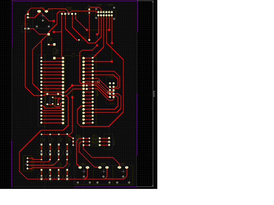

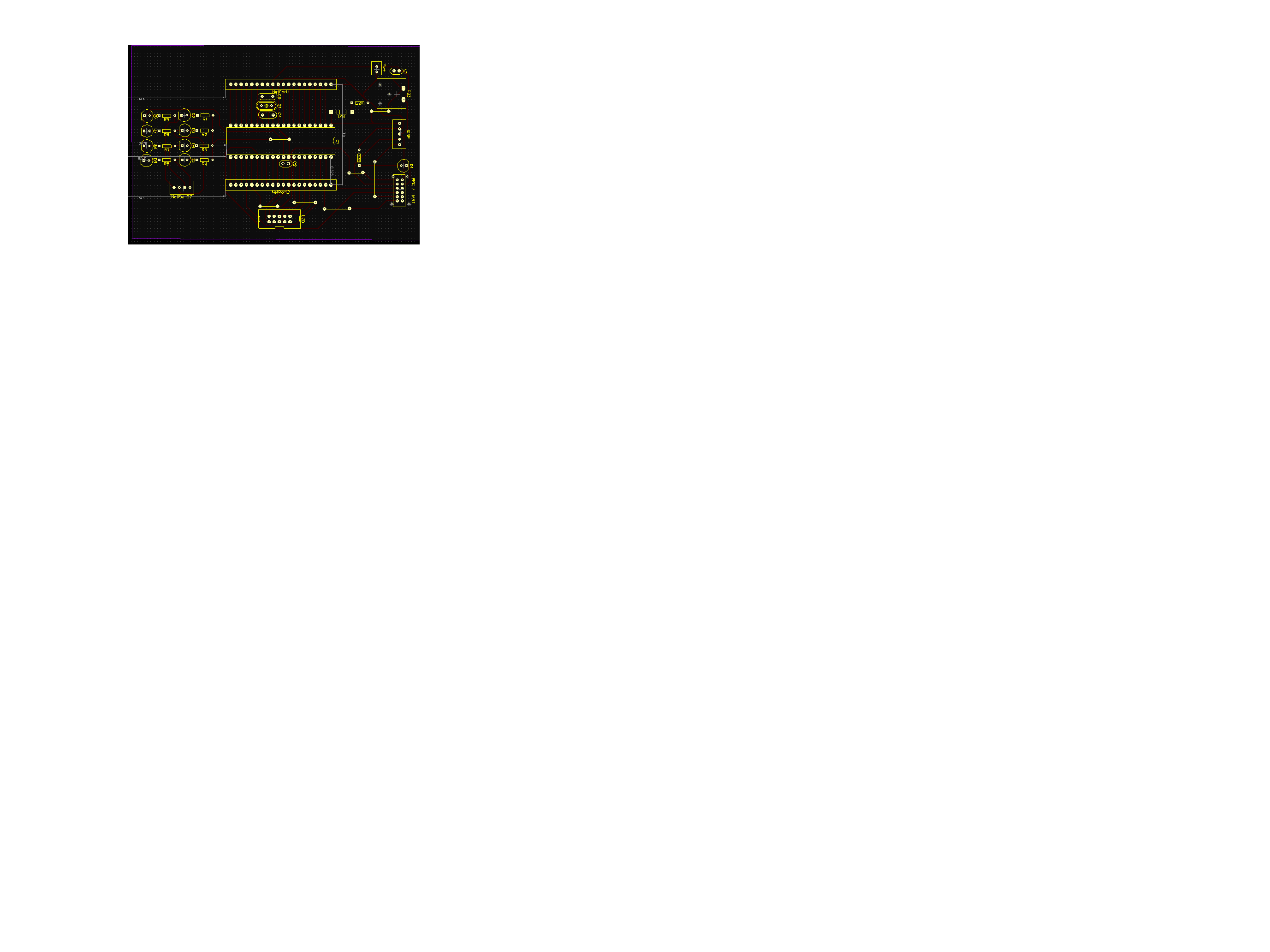

Here is my simple board
Been using this board as well as the Tap-28.
Very simple but it works (I think my LCD woes are between the board and the LCD)
Using the Tap-28 I need a bunch of jumpers. Been contemplating using the Junebug to test the LCD.
This simple board has provision for testing port outputs (8 LEDs ( 4=LOW and 4=HIGH)
An LCD header
a UART switch that I have to get the bugs out of?)
I will copy schematic if I get time?

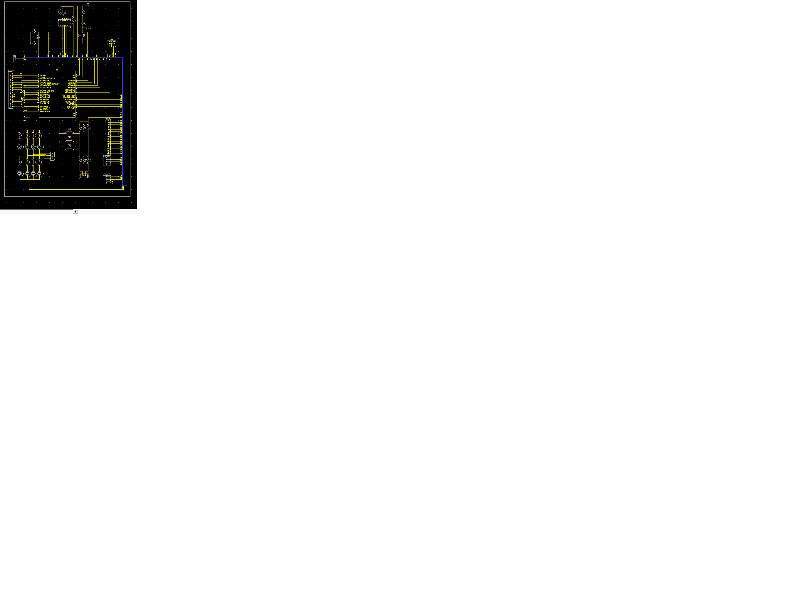

schematic of dev board
Here is my latest design
Very easy
