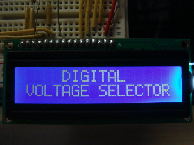

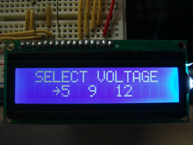

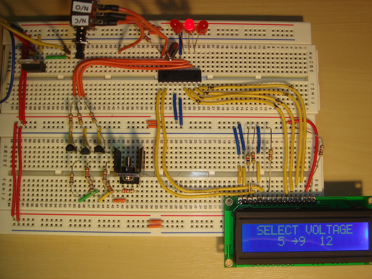

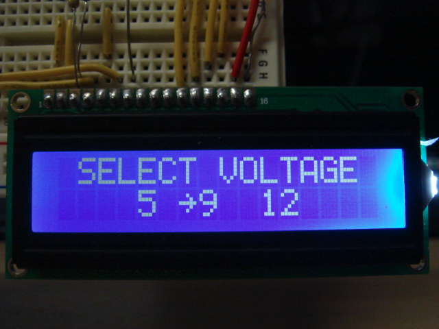

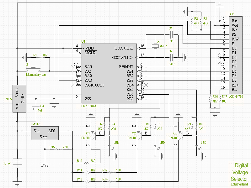

Here is the schematic and the .ASM file.
This was one of my first program and has not been updated so please excuse the flaws of the program.
(The LCD is ran in 4bit mode, just so you know)

Nice circuit Jake! Might I suggest with controlling the LM317 you could have used 2 transistors and a default resistor, instead of 3 transistors.
Besides being simpler it would have a safety advantage, as if the PIC fails or resets (any condition where PIC pins go open circuit) the voltage would be fixed at 12v. With your 3 transistor system the LM317 goes to max output voltage if the PIC is in reset or glitched as it's adj pin loses any reference to ground.
