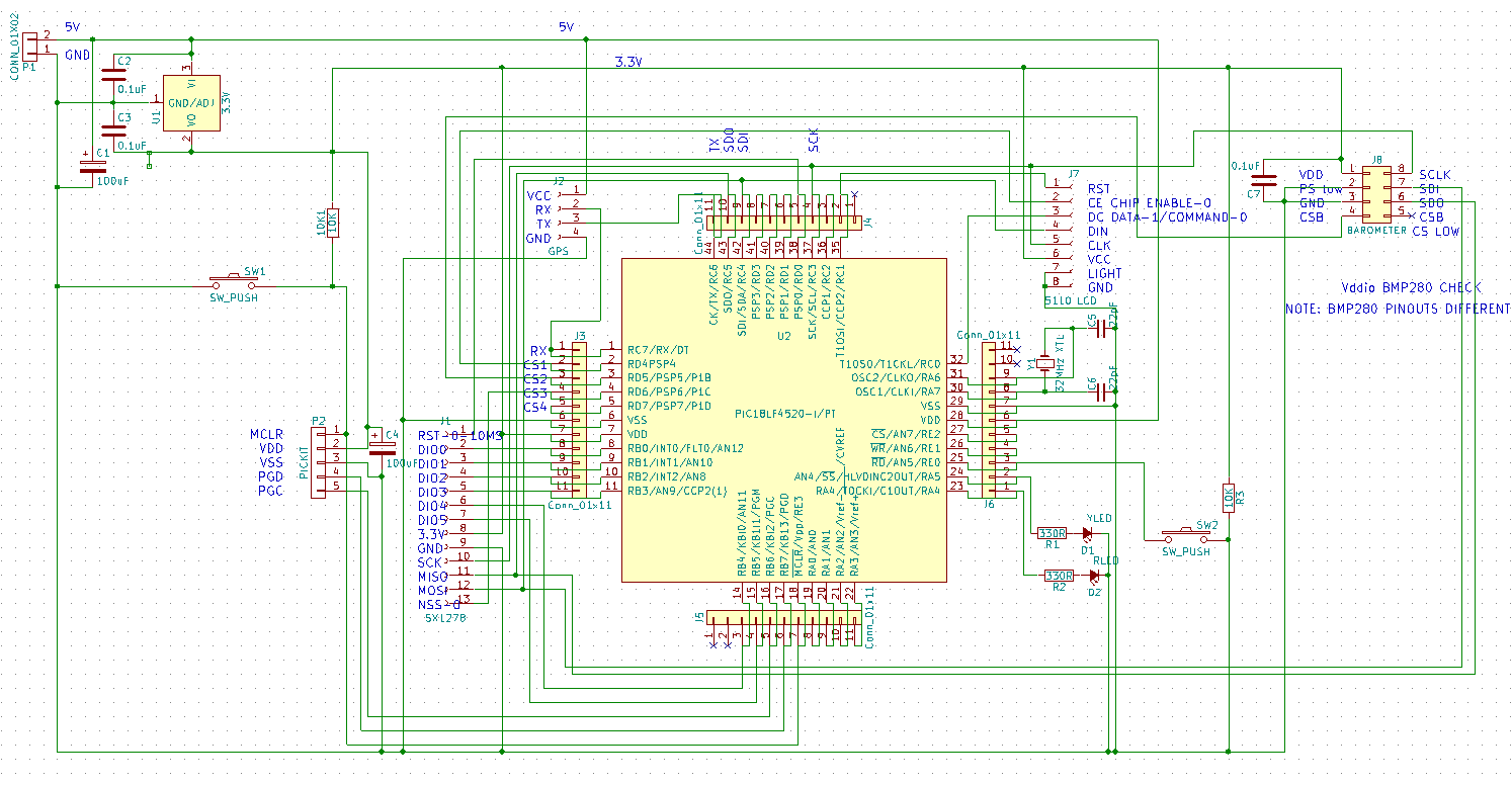

Here is a schematic of the latest 18LF4520 TEST PCB.
As usual check for faults, please.

Seeing that you used 3.3v, I decided to try resistive dividers 2k2/3k3 between the 5v powered UNO and 5v powered TFT, on all 5 signal lines.
All three LCD modules now work OK, with HW and SW SPI.
It looks as though the onboard HC245 level shifters are not working as expected, perhaps getting 'punch thru' of the 5v signal levels.
Now its back to the 18F4520, added the resistive dividers to the development board.
Eric
Now have the 9225 LCD module working with Oshonsoft Basic, programmed into a 18F4520 PIC.
Both the PIC and LCD are powered by 5v, series 2k2 resistors in series with the 5 signal lines, are required for stable operation of the LCD.

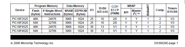

hi I,
I got some 18F4620 for SD card projects.
