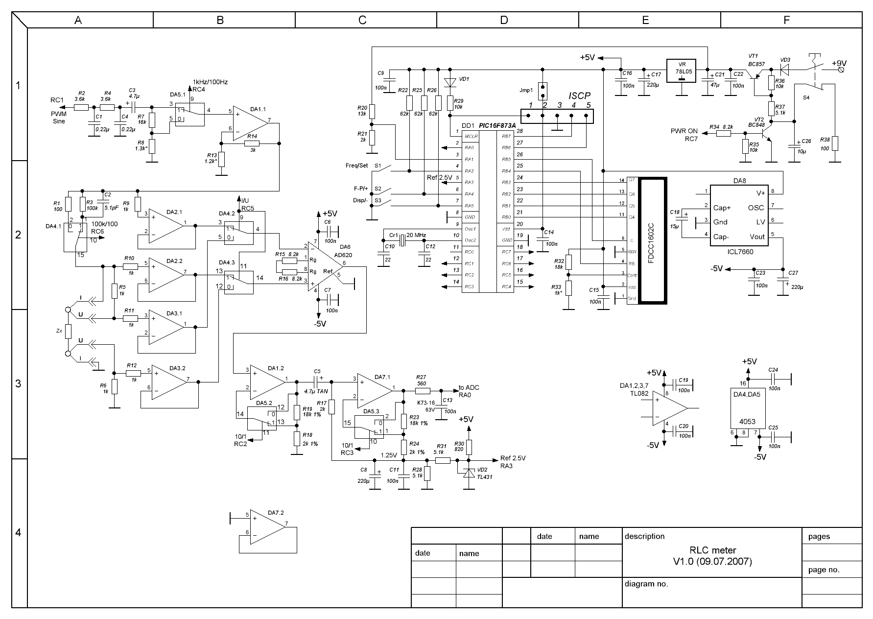

Nobody???
Then, PLEASE, let me know if somebody knows the source (documentation) for LC/ESR (I think) meter - I have attached a schematic of this device - I have no other information!
Also, if somebody know the link for this meter in this forum let me know - I can't find it with search.
TIA!

I would suggest your requirements are pretty impossible, particularly for a homemade device - I would suggest you reconsider what you need, rather than what you imagine you might need.
I would also suggest you look at the Peak range, small and reasonably priced, two of them should do most of what you want
https://www.peakelec.co.uk/acatalog/jz_instruments.html
especially in VERY LOW-inductivity range (it must have capability to measure a 1 turn-air-core inductor, or even small piece of copper wire, whether a low or high Q!) with fairly good resolution and tolerance;
Dream on baby!
Accurate measurement of low value inductors is not the sort of thing where I would use a PIC or any other microcontroller.
For such low values of inductance, you need to be considering resonance methods such as a Q meter working at high frequencies.
