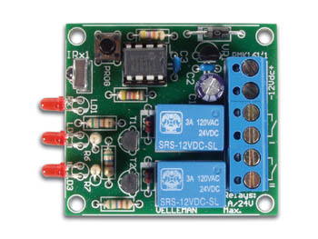

Hi thanks so much for the help so far it has been really appreciated.
I managed to source an actual kit but I have to order a lot of them before they will post to the UK, this is not convenient for a prototype.
Would anyone be able to take a look at the circuit kit below and possibly take a guess at what components it contains please? It's asking a lot but would you be able to sketch out how you think the basic circuit would connect them up so I could try and build it here in the UK?
If you don't have time just ignore this post I am very greatful for the help so far. Cheers :)
That is an incredibly crude circuit, no discrimination or lighting compensation - it will be switched by any form of illumination above the threshold set on the preset pot, not just a laser.
They will be virtually the same as Gary's circuit in the first post in this thread, but with the 100K and LDR swapped (and an adjustable preset in place of the 100K), but with more LEDs and to work on 9V.
There is a rather more sophisticated (but still working from any light) type on ebay at £24 for a pack of ten kits:
They have a relay that can control a separate light or sounder of some sort.
There are a lot of other light operated switch modules, but most turn on with no light - that has the option to to turn on when light is detected.
I'd put a section of plastic tube around the LDR with anything like that, so only light from the direction of the "shooter" can get to it, rather than all ambient light.
Agree completely. Looks like a CdS with you setting (turning the pot) the trigger level of a comparator...simple enough so that even I could do it. Still, the OP would likely benefit from building it and it probably works well, within obvious limitations. If you want to learn a little and do some soldering and end up with something you can play around with, it is not a bad option in my opinion.
