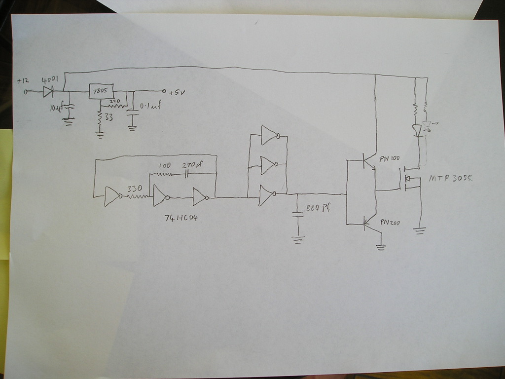

Jammer circuit

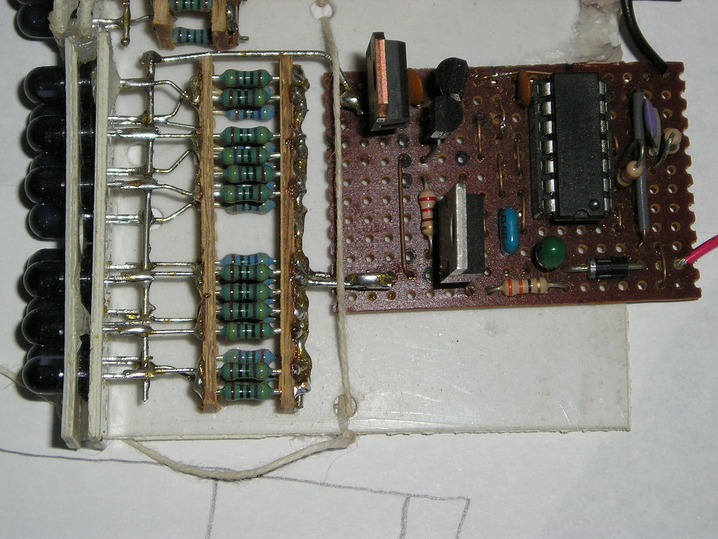

I have a commercial laser jammer,a Blinder brand unit.It consists of 9 IR LEDS driven by a 4 MHz driver circuit.
This unit does work as evidenced by the confused look from several cops as I drove past them,after each had tried to get a lock on my vehicle.In one case the cop tried to ping me for the entire length of a 800m straight,he couldn't even register that I was doing the local speed limit.
I have also had it tested against a Lidar unit owned by a local Radar detector retailer.
I wanted a second unit,so I decided to back engineer the original and I came up with this circuit ( see attachments )
The mosfet will switch several LEDs in parallel at 4 MHz.In the one pictured there is 12.A hex inverter is used as a square wave oscillator.
A previous post stated that to jam Lidar the output of the jammer needs to exceed the power of the cop's Lidar.This is incorrect.It is only necessary to exceed the power level of the echo or reflection that comes back off the target.
I used information from Traffic Radar Handbook by Donald S.Sawicki to find details of traffic Lidar operation
www.copradar.com
The Unit shown is the prototype
The LEDs are driven at 80 mA via a 220 ohm resistor each

interesting work. your design seems to be on all the time. Does the blinder unit only activate when it detects laser first? Also, i believe the blinders have several sensors/jammers...would your unit take care of just one of those?

Yes this unit is on continuously.This is not a problem as they are not illegal here and most cops here are not bright enough to know why their Lidar isn't working.Also they believe their own propaganda that radar detectors and jammers don't work.

The commercial unit is on all the time too.Some later designs detect the lidar and switch on the IR source,Obviously for jurisdictions where jammers are illegal.
The unit doesn't need to point at the lidar accurately,it isn't using lasers they are just IR LEDs.It forces the Lidar to try to detect it's echo in a very bright IR light source.Like trying to see a candle next a spotlight from 1000m
