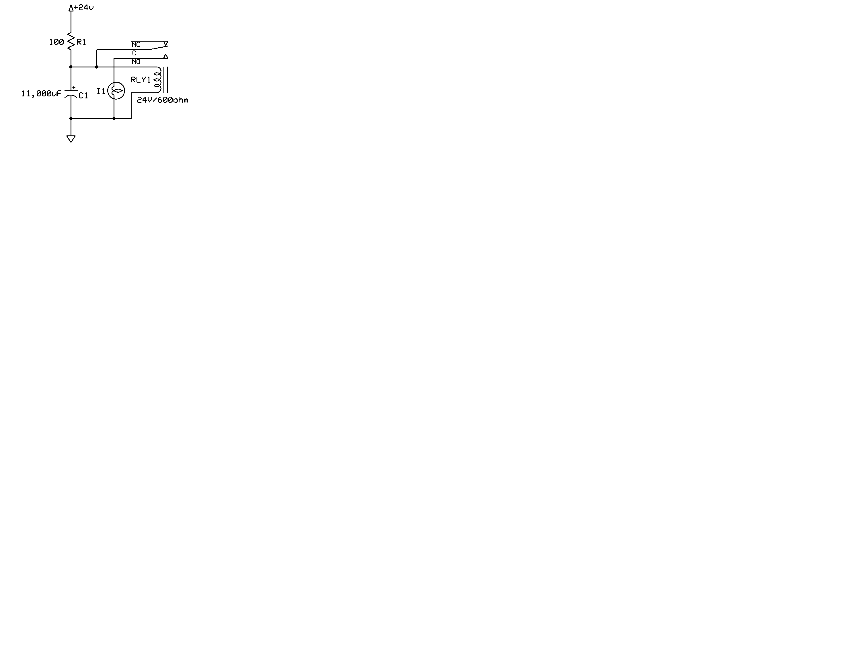

I have some reed relays with 1K coils but with a 100 ohm coil you could change R to 100 ohms and C to 1000 uF

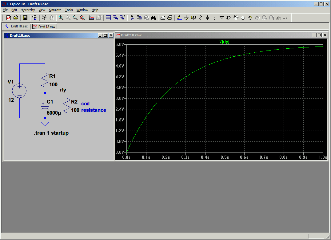

With a 100Ω coil and a 100Ω timing resistor, the coil voltage will reach a maximum of 6V. How many 12V relays will pull-in with only 6V on the coil?
With a 100Ω timing resistor, how big would the capacitor have to be to produce a delay of say ~1/2s? About 5000uF...

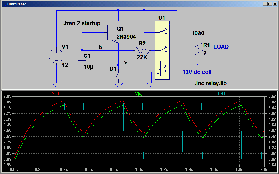

Here is a more practical circuit which relies on feedback from the relay contacts. You can also do this with an electronic (two transistor or 555) multivibrator circuit driving the relay coil (or not) without using feedback that comes from relay contacts.

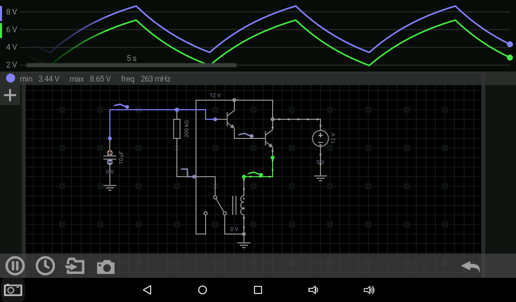

I do think MikeMI's addition of an emitter follower to drive the relay is an excellent augmentation, a low power MOSFET like a 2n7000 used as a source follower could permit even bigger resistors and hence longer delays with large capacitors or permit much smaller timing capacitors to be used.
Version with Darlington emitter follower. The Blue trace is the capacitor voltage and the green trace is the relay voltage.
What simulation software are you using?
Love your cat's face.
Its called Everycircuit.
It is free and available for PC's ( runs in Chrome browser ), iOS and Android. I use it on my Android tablet, Whilst its not as good as something like LTspice it can be more convenient to have on a mobile device.
Thanks for the compliment about the cat picture, she is no longer with us, but I think that was the best picture ever taken of her.

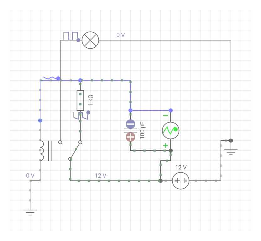

It can be done.
I have seen old weld sets that have a burn back timer of a second or so using a similar method allbeit with high impedance relays.
This isnt a 'good' circuit but it proves a point:
