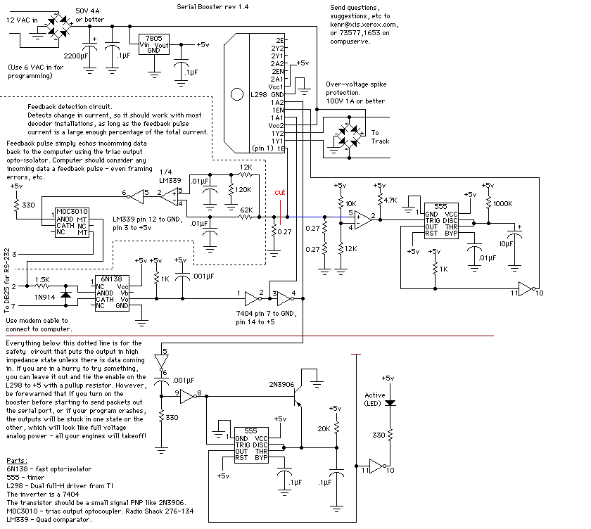

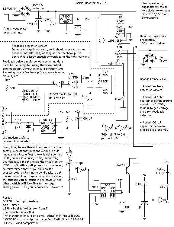

I've just recently completed a DCC (Model Railway Command Control) Booster Circuit of which I can successfully control my DCC-equipped trains from my com port. A schematic of the circuit is here: [See attachment: 941202_s.gif]
I've realised one huge issue though... if the tracks happen to short then things start either cooking or exploding; which, as you could imagine, is not the result I'm after...
I'd read the information on page 3 of this document [See Attachment: 1681.pdf]
and attempted to apply it between '1EN' and the L298 but to no avail...

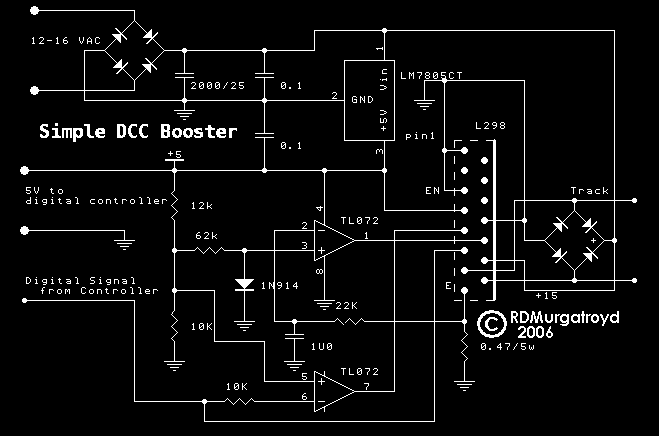

I then saw a similar circuit here: [See Attachment: bstr-1.gif]
that ties the 'current sense' pin to ground with a huge 0.47/5Watt resistor but also feeds it back into a TL072 to disable the input (although it doesn't seem to control the actual '1EN' pin?)
Due to a lack of knowledge though, I have no idea how to combine this into the current schematic as the 'current sense' pin is already tied to the feedback circuit and the '1EN' is tied into the 555 timer to only enable the output on data input...
I imagine I need a way of combining the 555 input into an AND gate of some form? Or something similar to only enable when the current sense is minimal? 3-4A would be a good current rating... but anything above 1A is great.

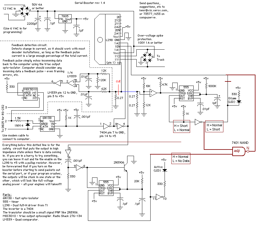

Ok, based on the original circuit above.. I have added in your trip circuit. It seems that if i remove the 'feedback' portion to the left of the sense pin 1 and just take that pin straight into your circuit then I can't get the L298 to enable.. even though there is ~3.9v outputted to pin 6 (enable).
But... leaving that feedback side connected and then joining on your trip circuit (with both the 0.47R to ground in the feedback circuit and then another two 0.47R in series as I don't have 0.5R and one 0.47R would cause it to trip too early on your trip circuit) made everything work...
I don't totally understand the implications of now having pin 1 brought to ground with the original 0.47R + 2x0.47R in this additional circuit... but I imagine it raises the 'allowed' amps through.
I'm going to leave this for tonight and might make more sense of it tomorrow... but so far so good, even if I am just applying guesswork :(

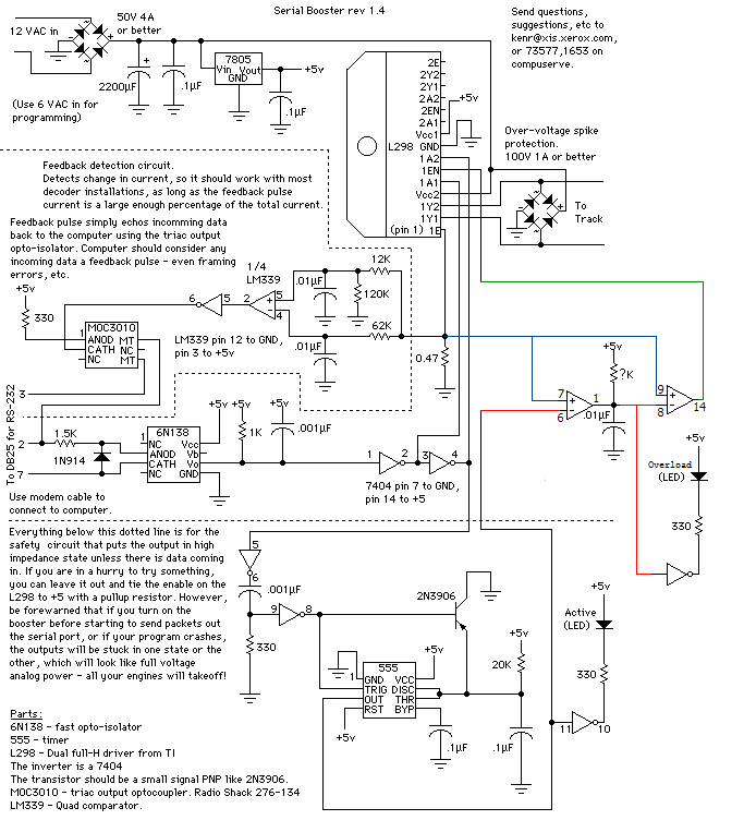

Hi again,
I think you should redraw the schematic you are using now, as the old one
isnt the same now. Also, in that old schematic i see that two of the
comparators (at least) are not connected correctly for the operation you
want.
Here's the latest.... cutting the circuit at the line marked 'cut' will stop the enable pin from working... i.e. the whole trip circuit just stays tripped for some unknown reason... it could also be that i'm not bringing the enable pin high enough due to my use of incorrectly valued resistors... since it turns out that my 0.47 resistors are actually 0.27R/5W... I tried adding in another 0.27 in parallel to the 2x0.27 (i.e. 0.52 in parallel with 0.27) as that's what i'm cutting off when i remove the feedback circuit but that didn't help either.
I need to source some 0.47 resistors from somewhere :(
On the up-side... everything still works great when both the feedback circuit and trip circuit are connected... I get the ~1.1s timeout and then it all comes back to life... no arching (well, buzzing) from the shorted item when across the tracks anymore.

Hi again,
You see that LM339 pin 2 that is connected to the 555?
That section needs to have pin 5 and 4 swapped.
That is, connect the sense resistor to pin 4 and the
resistor divider to pin 5. Test with that circuit alone
as you did before, that's a good idea.
You should see your train or whatever run normally until
there is an overcurrent, and then it will appear to shut
off. If it shuts off when the train starts to move,
that means the current sense is too sensitive. You
might try paralleling some 0.47 ohm resistors (or whatever
you have on hand) to beef up the current trip point.
This also keeps power dissipation in the sense resistor
low too, but if that's not a problem (sense resistor does
not heat up) you can also adjust the resistor divider a bit.
Before you do that however try to get this working with
one train alone.

There is also the possibility that when the train starts up
the surge current trips the current sense. We'll have
to deal with that too if that happens.
What power rating are your sense resistors?
You might not believe it, but that's the way I actually wired it up, as opposed to drew it :)
You might try paralleling some 0.47 ohm resistors (or whatever you have on hand) to beef up the current trip point.
2 0.27Ohm/5Watt resistors did the trick!
BTW, with that 10uf cap instead of 1uf you might get more like 10 seconds...
Another typo on my diagram, it is indeed 1uf.
...you can connect an LED to a 2.2k resistor to +5v (anode toward +5v) and connect that resistor to the output of another inverter...
I've just been playing with this tonight.. and it works great.
There is also the possibility that when the train starts up the surge current trips the current sense. We'll have to deal with that too if that happens.
this was occuring, but the parallel 0.27ohms seemed to drop the resistance sufficiently?
0.27 Ohm / 5 Watt
And now, the latest schematic... with my attempt at AND'ing with available components.... 7401 NAND Gate. It seems though that I'm not getting a 'full' High from the NAND... it's not pulling enable high :(
edit: Seems that my outputs from the NAND are backwards ((H(good state)/H(good state)) == LOW) and running that back through the 7404 inverter doesn't work :) I'd imagine there is no source in the 7404 to provide vcc high? it just 'floats'?
edit2: I've just **broken link removed** that the outputs of the 7401 require pullup resistors... Now i'll try and determine the values, but i'm stabbing in the dark... I might just source a proper 74hc08 (I think that's the code) tomorrow and stop screwing around.
Hi again,
Ok, sounds like you are making a *lot* of progress here, and that's good that
you caught the current surge problem already so we dont have to trouble
shoot that. That's great.
Now there's the thing about adding an *AND* gate. Note that this has
to be an AND gate, not a NAND gate. If you want to use a NAND gate
though that's fine, but you have to use an inverter after it (on the output)
so that the whole construction boils down to an AND gate again.
The pullups, if you still want to use them, can be 2.2k but many times for
stuff that doesnt have to be super fast (nanoseconds) a 4.7k sometimes
works too. From what i read on the web that 7401 is an 'open collector'
so you are certainly right that it needs a pullup on the output, even if
it is connected to another gate, and keep in mind that after that you
still need an inverter (7404) so that it becomes an AND again.
I think you will soon be done with this thing, and perhaps happy with it too :)

MrAl,
Could I just get a few pointers on this circuit...
I had 6 trains running great on it, though if they all tried to start from stopped at the same time then it'd trip the circuit; obviously too much current at once.
There are also accessory decoders which seem to suck a bit of power at startup (they have caps to store a bit of current, it seems, since they usually power solenoids which like a good kick)...
So, to test I threw the acc.decoders on and bypassed the overcurrent check... as soon as the power was fed in I enabled it in (the joys of a breadboard) and they functioned perfectly.
So, I was wondering... instead of screwing around with the sense resistor (parallelling my 0.27R 5Ws I have on hand..) I was wondering if there was a method to allow short bursts of current before tripping... i.e. can you put a delay on the 555 so that it doesn't trip instantly? or a cap on the feed line to the lm339 to allow it to soak up a bit before sending anything along?
Thanks, Steven.

Ok, gotcha... I'll be testing this out tonight.
As for results of shorting... I had the initial circuit (before we started extending it) on my model railway and it was shorting out without me realising (I thought it was just dirty tracks...) Before I knew it there was a plume of electrolytic smoke coming out of the box and everything was overheating. I had no spare components at the time and still haven't checked if any of the parts in that setup still work.
The 2200uf cap was the obviously casualty... I'll test out the other parts, like the L298, when I have the time.
Anyway, back to work, but thanks again for the assistance!
Right, after twisting a few resistors together (as the 2K2 was too high, it seems) the 'sweet value' for 2 trains and 2 accessory decoders is 1K4.
Now I just need to make sure I incorporate a heatsink on both the 7805 and L298.
Thanks again.
