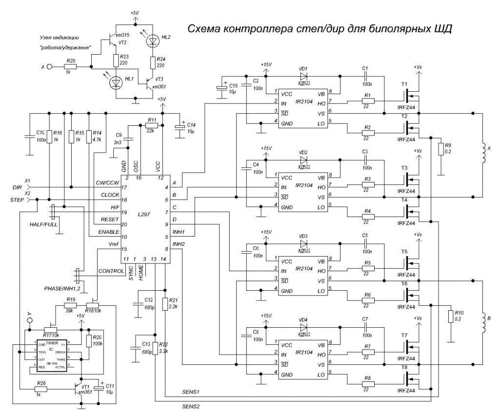

My bipolar stepper motor has 3 ohm winding resistance. I want to run it at 40-48v, so amp will be b/w 13.3A-16A.
I also have L298 L297 driver but it can work max 48V but not with 13.3A-16A. Am I right?
I found the driver attached in the image. Please guide me, whether this driver can work at above volts & amps.
You can suggest any other driver schematic for this application.
