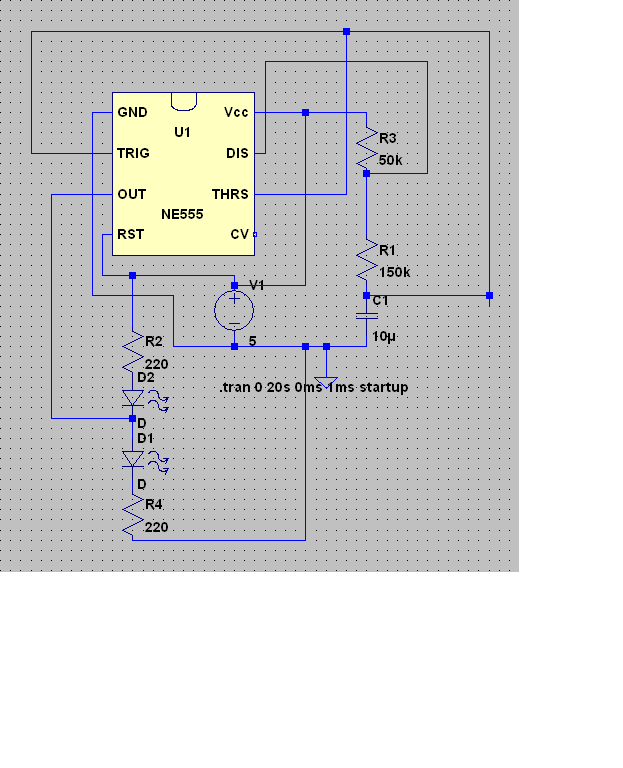

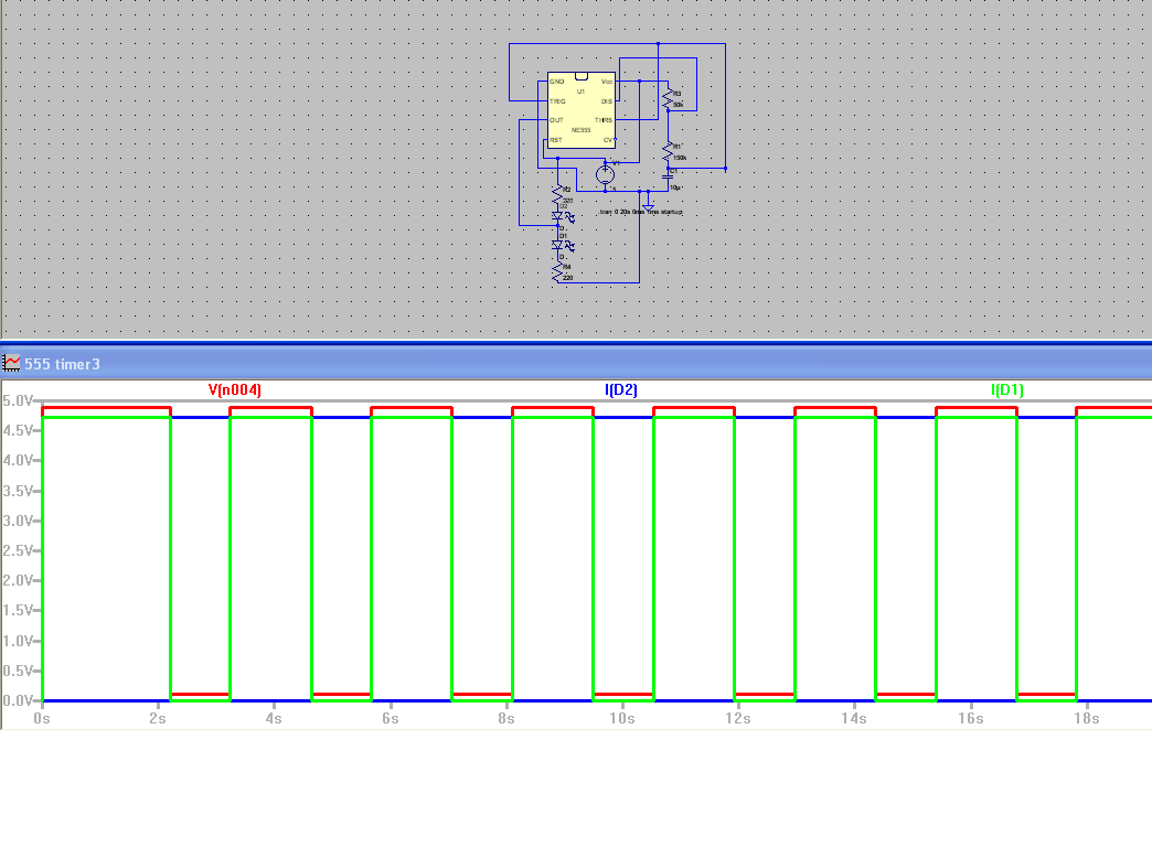

why when I simulate this circuit - two LEDs connected to 555 output, the LED to ground shows current flow but the LED connected to Vcc to pin 3 output shows no current.
why doesn't it show current when the 555 output goes low?
maybe a reference to ground?? issue.
I think the simulation program is stupid.
When the output of the 555 goes low then the upper LED should light.
When the output of the 555 goes high then the lower LED should light.
The simulation also shows an output voltage that is too high when the output of the 555 is high.
I will enlarge and straighen out
but regardless the led connected to Vcc to pin 3 should show a high when the 555 output goes low.
the led connected to pin 3 to led to ground shows a high when the 555 goes high.
Dang it now it works??
All I did was straighen out the schematic
Could this be why?
The schematic is poorly sized with tiny parts and miles of wires between them so it is hard to see what is connected and what is not connected.
To which you replied:
I will enlarge and straighen out but regardless the led connected to Vcc to pin 3 should show a high when the 555 output goes low.The led connected to pin 3 to led to ground shows a high when the 555 goes high.
It points out the value of careful drawing. Not only does a bad drawing make it difficult to spot your own errors, but most people don't even try to read bad diagrams so getting help is difficult.
Hopefully you now understand that LTSpice cannot correct your errors, even if your diagram is too messy for you to find them..
