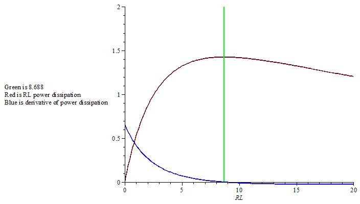

How hard is it to see where the derivative of Power in RL=0?
Why would anyone care what the derivative is at RL=0? I would think they would be more interested in the value of RL where the derivative of the power dissipation is 0.
You never answered about having to use Thevenin to even know that there is a max power transfer theorem?
It is a trivial problem in differential calculus to determine what the RL value in relation to the source resistance should be in order to maximize power transfer. Thevenin's theorem is not needed for this.

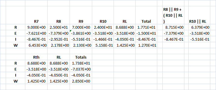

Rachit,
I did do some calculations ... but not the current loop methods. Attached is the spread sheet where I filled out, via KVL and KCL, what values went where. Yes, I use superposition to get the Rth.
I also have a simulation program where I could have stepped the load resistance to find the maximum power ... or I could have used excel to find it.
You are correct, if the problem stated to use the current loop method, then by all means it should have been done. I did what I did to see the bottom line (RL at max power) to quick check everything. That's when I notice the abnormality in your posting ... which was something I hadn't noticed in any of your prior postings.
Let me try that sentence again, this time with ():
How hard is it to see where derivative(Power(RL)) = 0?

Not hard at all. Any general purpose equation solver can easily find the current in the east loop to be -9000/(11112+1279*RL) symbolically in terms in RL. Likewise the derivative of (I^2)*RL set to zero quickly simplifies to RL = 11112/1279 = 8.688... . You have no doubt seen the plot of the power of RL and its derivative in my last post.
