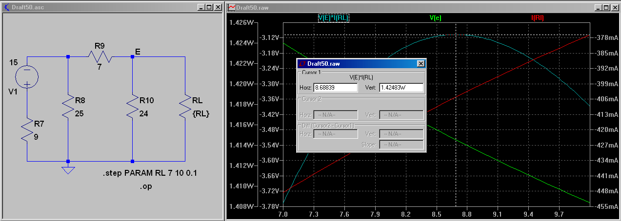

I got a Rth of 8.688 Ω so the RL should not be 32 ohms for maximum power transfer. The Max Power pdf could not open so I have no idea what the OP has for RL.
Joe is right; Ratch=Bzzzzt.
Look at the blue trace which is power in RL as a function of the value of RL as RL is varied from 7Ω to 10Ω (the independent variable of the simulation, dependent values are voltage at node E and the current through RL).
To the OP. Simulation is not what you should be doing right now, but you should take away that it can easily solve a system of equations in several unknowns based solely on an input of a circuit, and that the max power point occurs when the derivative of power goes to zero...
