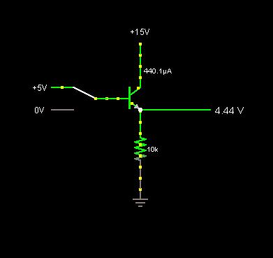

Try configuring the transistor (am guessing NPN switching transistor) in an Emitter follower configuration. Easier than using two transistors. Try about 10 K on the emitter. You will lose the forward voltage drop of the transistor but I doubt 700 mV will matter, you should have plenty to turn on the mosfet fully.
Ron
Is this what you mean :
That will give me less than 5V at the emitter..
That should give you 15 volts - about .7 volts (the forward drop of the transistor) when the transistor is fully turned on. Where did you get that sim from? Unless the 10 K is way too high. If that is a sim try 1 K then 470 ohms. The problem I think is the current I see is so low with 10K in there. This part sure as hell isn't my forte. :)
Ron
I can explain.
Consider the loop consisting of base and emitter. 5v(from uC) - Vbe = 4.3V across the resistor (4.44 in the sim).
The value of the resistor does not matter, the emitter voltage will follow the base voltage with a difference of 0.7V. Thats why its called emitter followr :)
