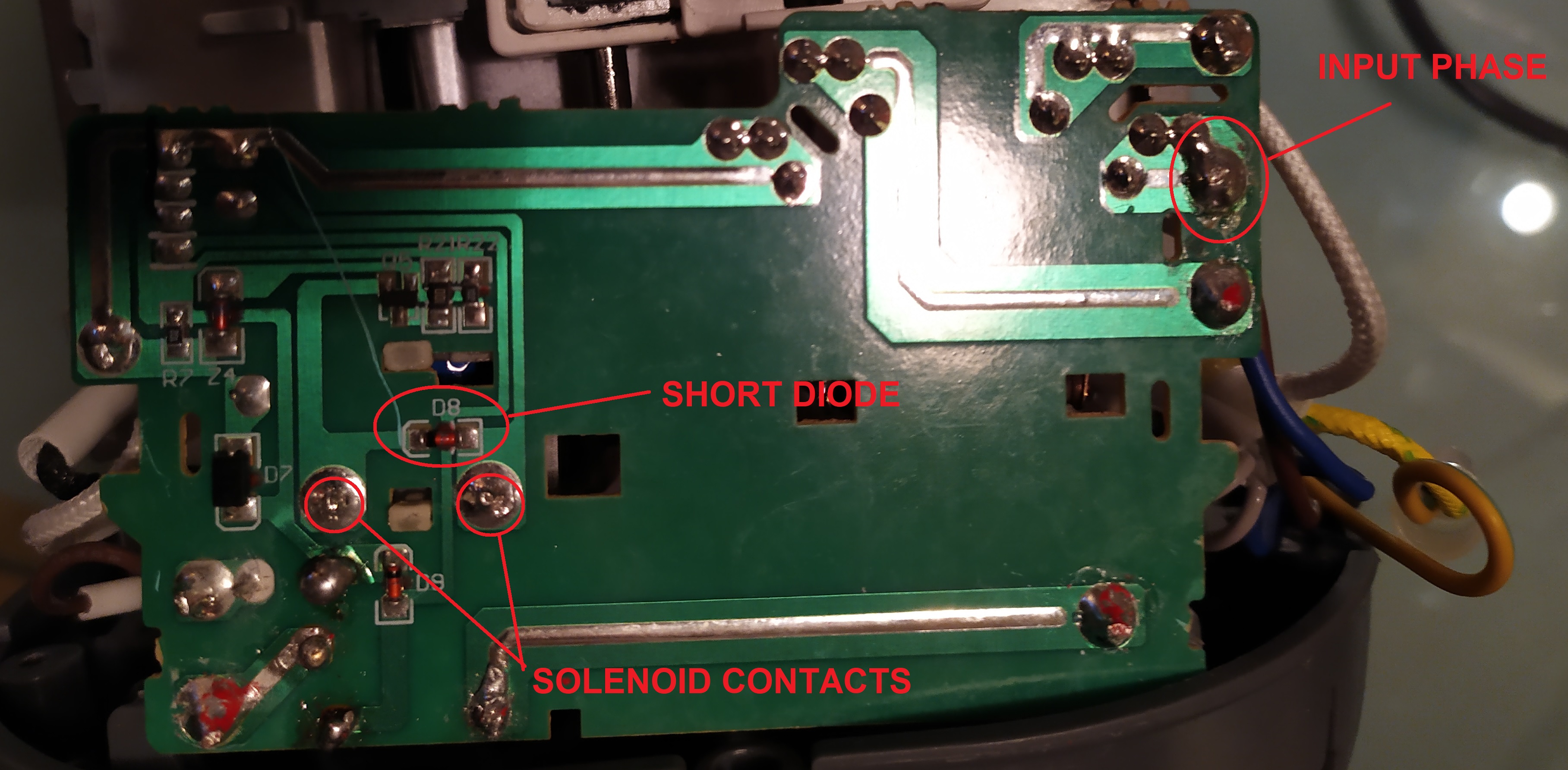

I have verified that when the lever is down, both metal contacts close.
then when the contacts are closed, I checked for voltage on the solenoid and found out that both the solenoid contacts close 220VAC with the input phase.
I then checked the diode between them (D8 marked in the attached) and realized that it's short.
I guess this is the reason for the malfunction...
1. anybody knows the value of the diode I need for replacement?
2. any chance someone can share the board schematic? I searched everywhere, couldn't find it
The diode is across the solenoid (to prevent the transistor been killed by back EMF), so you can't test it in circuit, as you're reading through the solenoid. It's almost certainly NOT faulty, those diodes never fail.
I wouldn't expect any schematics to be available?.
Thanks. so what could be the reason that the solenoid is not powered? could it be that if one of the heating wires is broken, it would prevent the solenoid from powering?

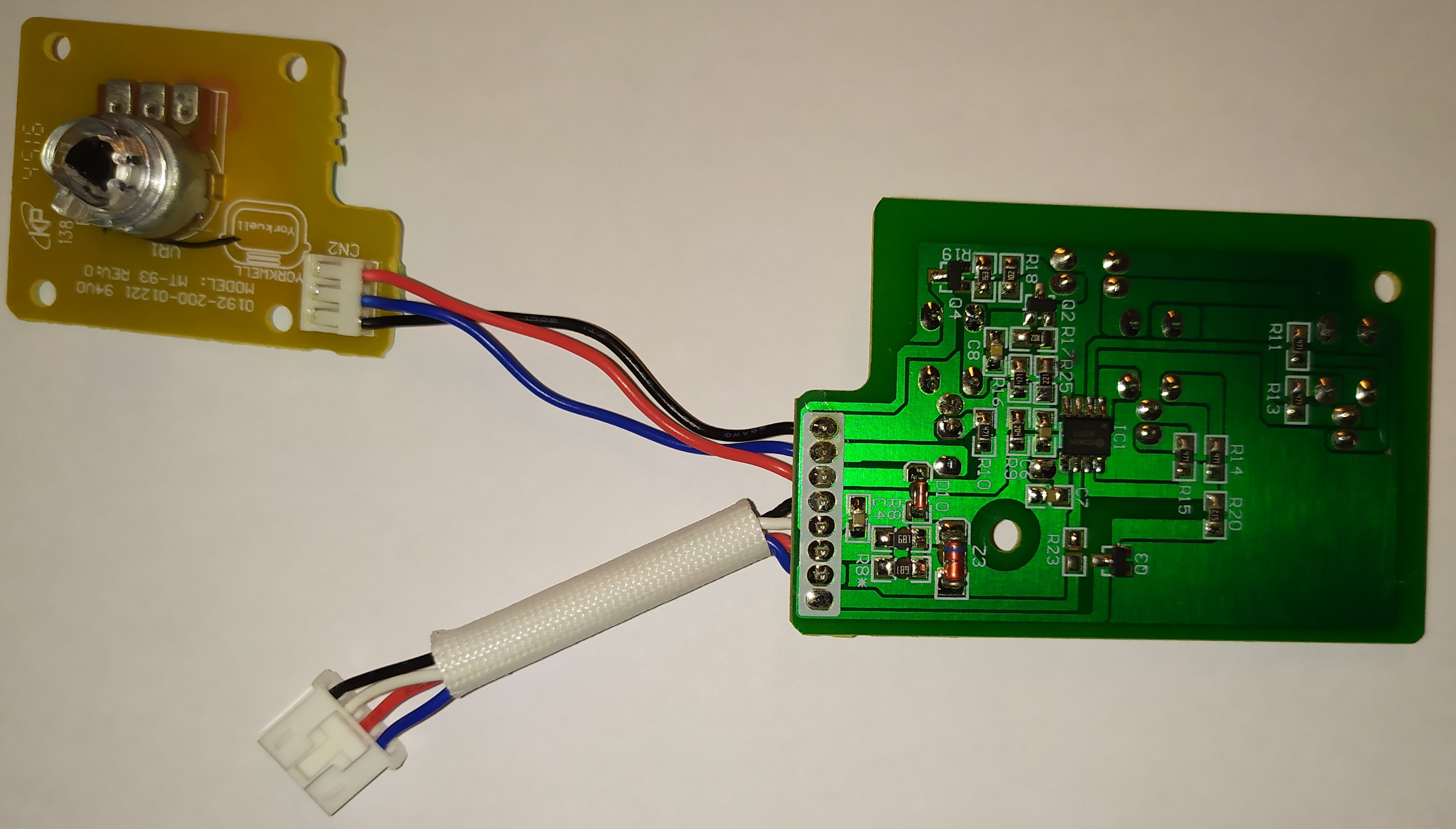

Hi guys,
thanks for the help so far. so I fixed the break in the heating wire and now the heating elements are heating, there is power to the timer circuit (led is ON) but still, the solenoid is OPEN.

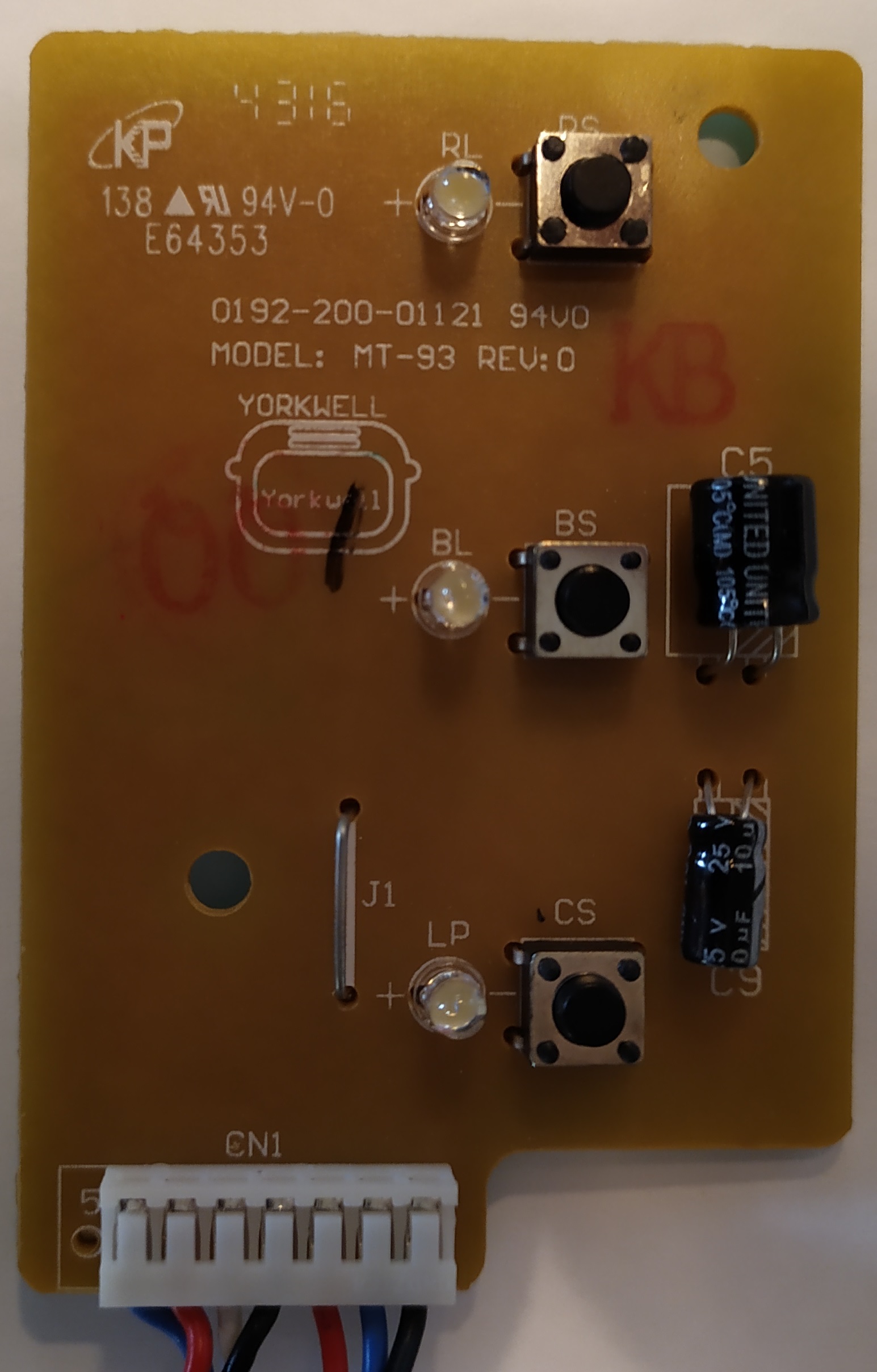

So I moved forward to work on the timer circuit + potentiometer board.
potentiometer looks good. checked resistance between contacts as I turn the knobs...

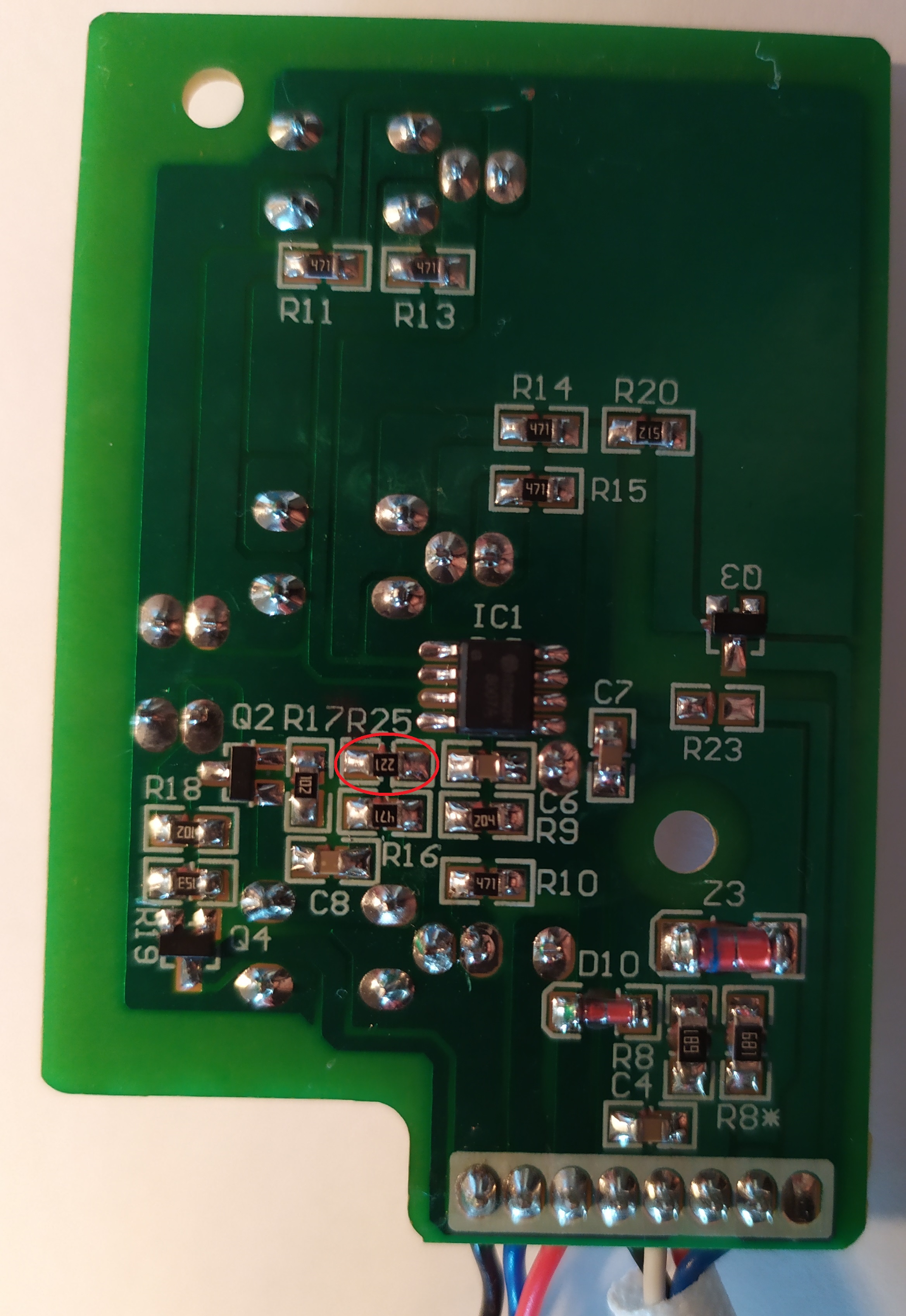

moved on to the timer PCB..
first of all, I understand its some kind of generic PCB but following the coding on the back couldn't find anything
.went over all the resistors...all give good readings accept one which looks suspicious...R25 should give 220ohm but it looks like a short (I could assume my meter is bad but given that all other resistors gave values around to expected...)
as for the transistor or MOSFET, tried to read P/N but couldn't find any trace online...looks like RT2002H...or RT2602H....
I guess I could just try to replace R25 and see what happens...
but just in case someone has better knowledge of the chip pinout so I can test if its OK or FALSE
As before with the diode, you can't just check components in circuit - the resistor is pretty well 100% NOT faulty - it's incredibly rare for resistors to go low in value. It reads 'short' because there's something else across it that your meter is reading through.

Hi
That's exactly what I was doing...started by acquiting the two metal contacts. I then moved on to the power relay. then I went over to the solenoid which led me to the timer circuit.
current update is that after testing again with the timer circuit connected to the main board, suddenly the solenoid started working and reacting to swiveling the timer knob.....so bottom line is the only fault was the break in the heating element....really dont know why it didnt work at the first time after I fixed the element.
