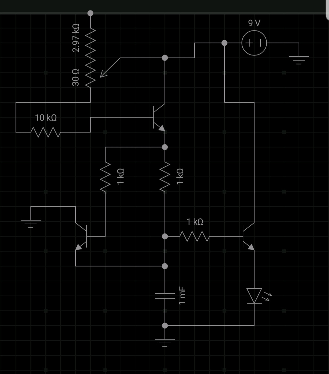

I'm an electrician but not great with small electronics so I could use some help designing a circuit. This is what I would like to accomplish: When a thermistor temp is raised by my hand an LED slowly increases brightness. When my hand is removed the LED dims to off. I measured the thermistor. At room temp it is 10k ohms, when touching my hand it lowers to 7k. The LED has a forward V of 3-3.2V.
I believe the schematic would work but I can't figure out the appropriate resistor values. I would prefer it runs on a 9V battery but that can change
No that wont work

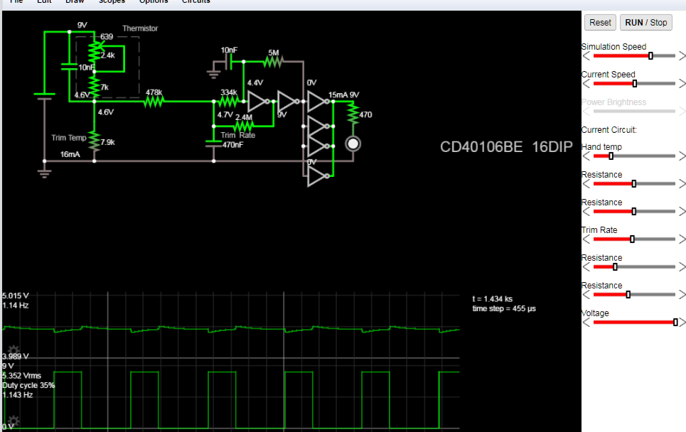

This seems to work with some added features.
When it starts to blink at a slow heart rate speed, it speeds up as it gets warmer.

It is not clear from your schematic which part represents the thermistor, or what the function of the left-facing transistor is.

AnalogKid - the thermistor is the potentiometer and 10k resistor in the top left. Doing the best I can with my program. The backwards transistor is to fade out the LED. Otherwise the cap discharges too quickly to notice the effect

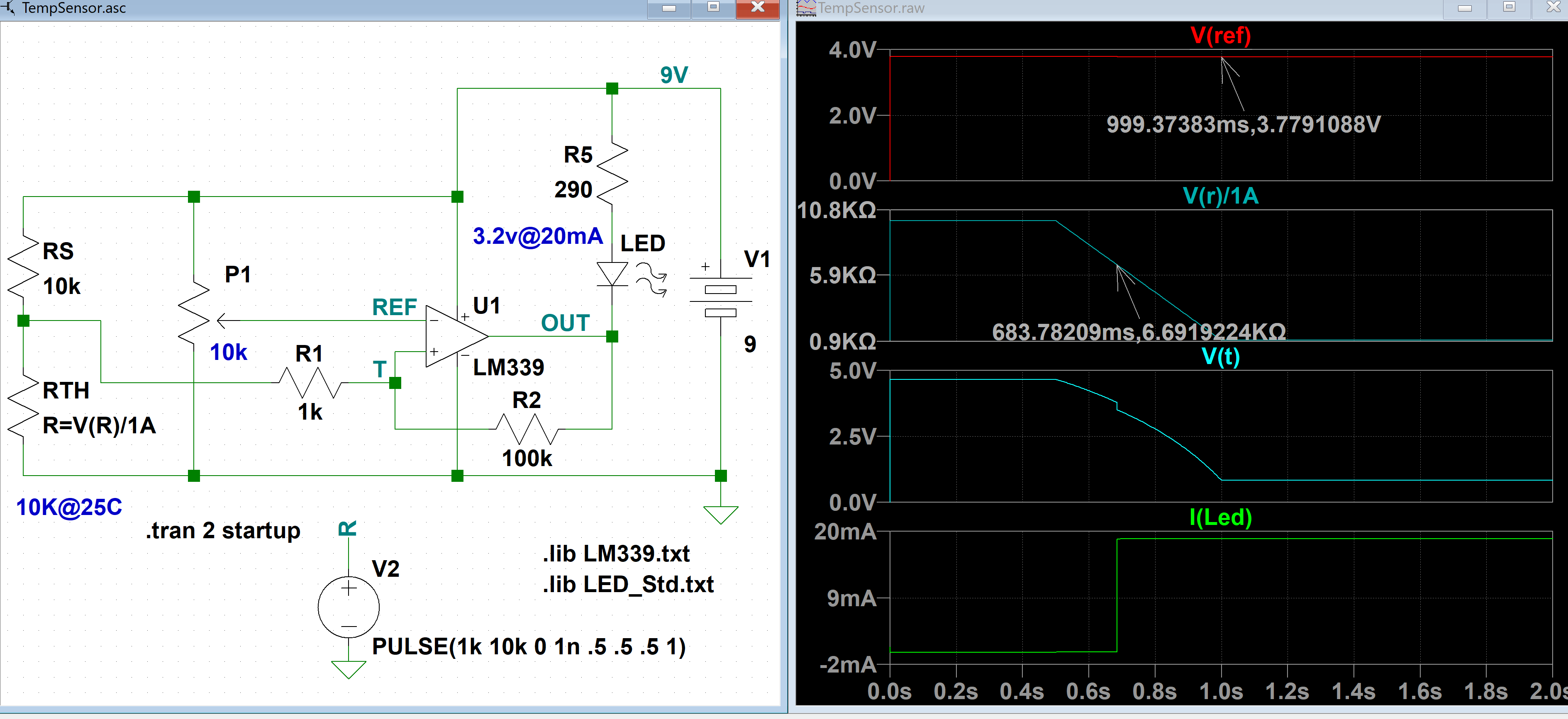

Perhaps we can change the design and use a comparator as level detector to light an LED. The LED could be a one that flashes on its own, or lights steady on. Your choice. :)

This is a first pass just to show the concept.
The comparator does what it sounds like.. :) It compares a voltage on the (+) terminal with the voltage on the (-) terminal.
When the voltage on the (+) terminal is less than the (-) terminal, the output turns "on" (meaning it "grounds" the output).
The LED turns on when the output of the comparator is at "ground".
Potentiometer P1 sets the threshold for turning on the LED. Its set to about 3.7 volts so as to turn on the LED when the thermistor resistance decreases to below 7k. The threshold is adjustable.
Let me know what you think..

AnalogKid- ideally I want the light to fade on when the temp is above a threshold and fade off when it is below the threshold. However I'm a beginner when it comes to electronics and I'm limited on the parts I can get. So I'm looking for something simple. A light that simply turns on above a temp threshold is good enough for now.
eTech. Thank you. That's simple and adjustable. Perfect. Couple questions. I'm assuming "RTH" is the thermistor? What is "RS"?
Rs is a current limiting resistor. It prevents the thermistor from overheating which would affect its accuracy.
