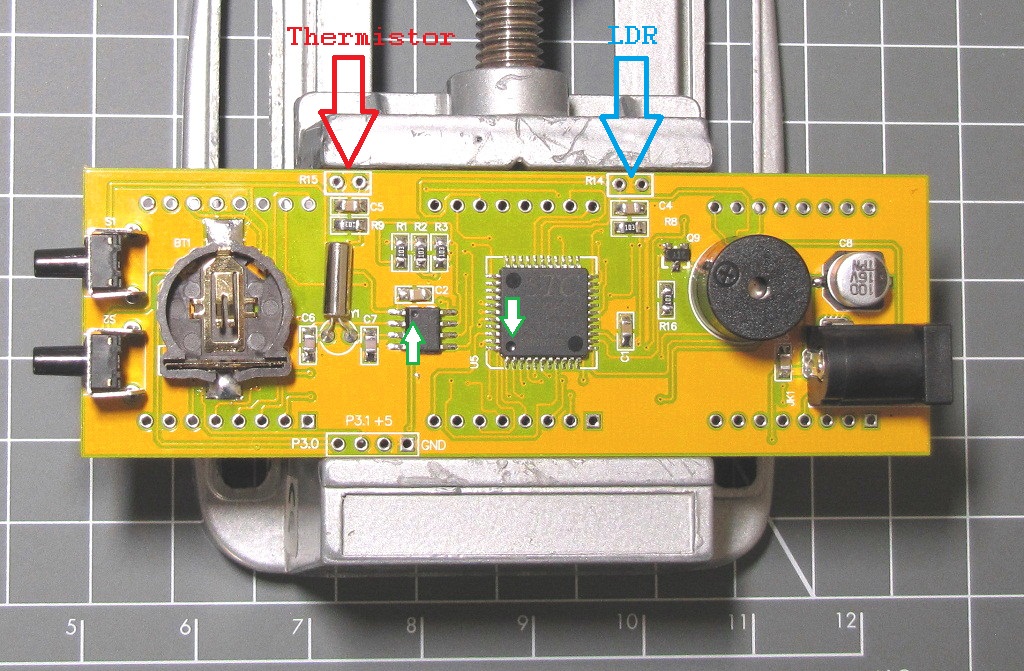

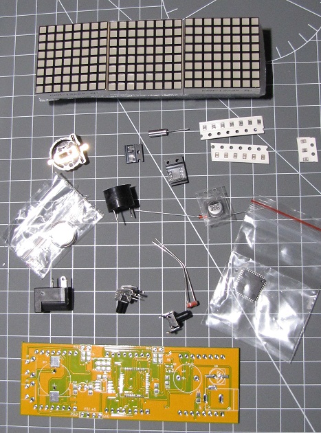

My clock project not off the desk yet but just out of curiosity I got one of the led clock kits from Banggood to see what was supplied...
mcu is a STC15F2K16S2,(TQFP) RTC is DS1302 with xtal and battery a couple of transistors, a buzzer , an ldr , NTC thermistor a couple of tactile switches, various caps and resistors, 3 8x8 led matrix. PCB plastic box parts and power connector.. ( mostly SMT parts )
Operational but no build instructions included , presumably you follow the screen print and component list. (document has a few translation or typo goofs ) “ avoid to resist digital tube affect beautiful “

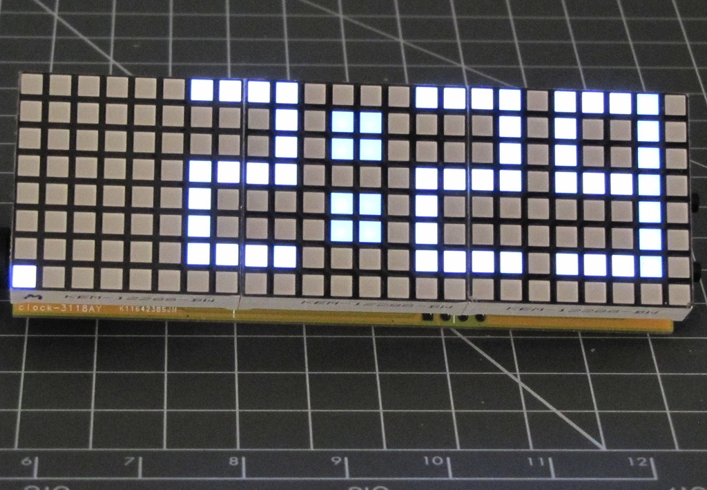

This is the 'BG' assembled clock , one or two Errrr ... moments. Instruction 'manual' as mentioned needs re-translating its pictures are c**P, no mention of some resistors / caps , Thermistor and LDR numbers swapped. But 8/10, good that spare R , C and Q 's provided . LED's don't have any drivers ,(a 7x4 font ) so I guess some PWM going on , so a line of 7 all ON changes the brightness a shade. Fun on a cold winters day. :D

Edit: Its now 22:31 Clock, temperature and alarm work.. But something wrong with the time setting, does not go from 9:00 to 10:00 or above ? goes back to 0.00 then minutes will not advance correctly, will have to wait for tomorrow to set time before 10:00 am , rating now 5/10 ...

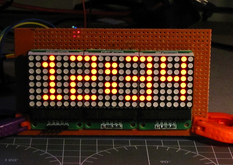

My matrix clock has taken shape, with 3 MAX7219 led drivers an RTC module and a PIC24FV32KA302 , the led matrix and driver were pre-assembled , so I mounted them on some strip board, driver circuit is bit banged with common Clock and Load with the data daisy chained in-out-in-out-in . I thought it was going to be easy sending an array 3x8 16 bit words . I worked out the code for each digit , stuffed the array , but result was not 12:34 , just a mess. some time before I got to this result . ( LEDs are RED ! ). Thought wrong again !
The clock is not being sent to the display yet this was a dotty test I need to work out best method for loading array from the BCD time .
The Banggood clock post #30, is running OK , but lots of complaints by builders to BG web site re, the time setting fault , emails to BG are taking an age to respond, if it is the mcu F/W , not sure how they are going to resolve it.
Very nice, grandad :cool:.
Admit it, you're having a ball, aren't you!?

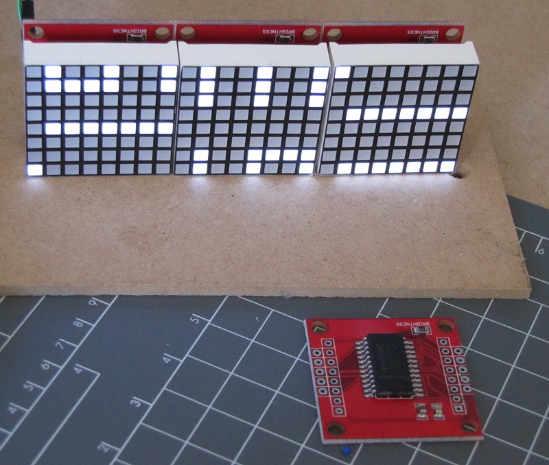

Having spent some time and 'hair' coding my clock with red dot matrix, I decided to change to a square 8x8 white led , taken from the failed banggood kit, also got some smaller MAX7219 driver boards from 'hackspark' , so it would fit a 'hammond' plastic case.. was not considering the fallout of such a move :eek: my clock is now showing Egyptian hieroglyphics (12:31) so some more C time looming .... ( how long should projects last...? )

All else being equal (but, really, is it ever?), probably a pinout difference.
