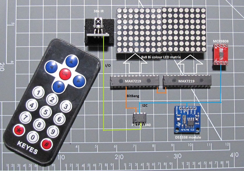

Eric , I like building clocks ! I have 8x8 bi dot matrix and SS leds waiting for some solder . also a couple of max7 ??? drivers. thinking PIC24xxx , clock, alarm, temperature , all with IR control .... used a DS1338 module last time on the Greenhouse environment controller / monitor ,< this is progressing have remote end in garden GH, still in prototype mode. will up-date the thread,

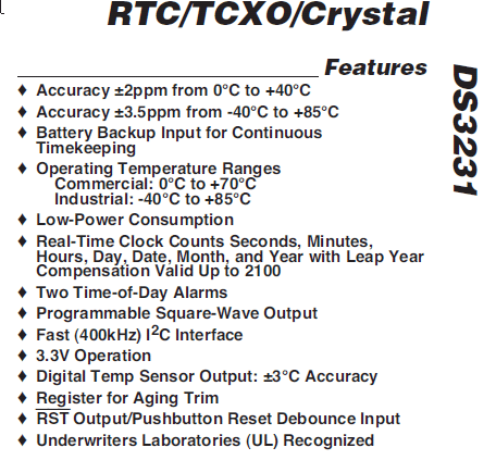

Have a look at the DS3231, far more accurate than the other types - as it uses an internal crystal and temperature compensation as well.
Thanks to your help I've got mine working nicely now on my PIC24 :D I'm also using the sqw output to trigger an external interrupt every second to initiate reading the clock (and to run a seconds counter, to trigger various events).
hi G,
I agree with Nigel, the DS3231 is far superior to the DS1338, it also has a inbuilt thermometer.

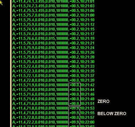

On a COLD test it updates faily well down to ZERO, it then shows a decrementing low value.
This is my program as I did not expect my house interior to get to zero.!
I will modify my program and rerun the COLD test later today.
E
This image is a log from TeraTerm, ignore the values other than Temp and Temp.

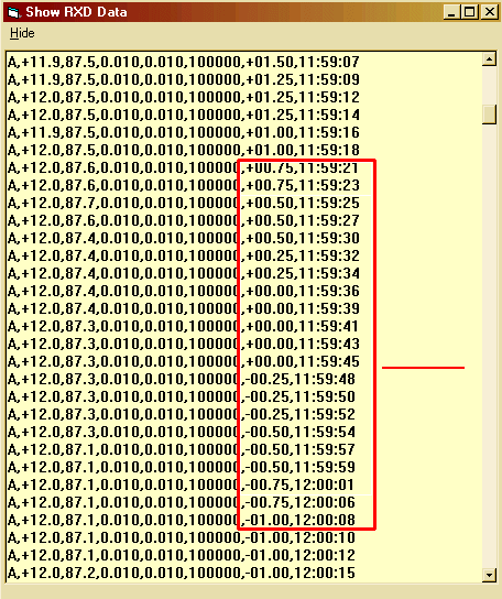

Hi Ian,
As your log doesn't go negative when the temperature does, presumably you're not checking bit 7 of the upper byte, where a one signifies a negative temperature.
Also, what happened to the last fractional digit?, and how did you get .9 at the end, when the only possible fractional values are 0.00, 0.25, 0.50 and 0.75?
My problem with negative numbers is the twos complement situation, some sites say you need to do it, and some say you don't.
I like your idea with the frozen food packs - although my current setup wouldn't make it very easy for me to do it - I'll have to arrange a different payout and try it some time.
As for serial terminal programs, I've found and started using Termite 3.2 - which is nice and small, requires no installation, and is very easy to use :D
hi Nigel,
Its me Eric, not Ian...:rolleyes:
I have modified the program to give negative temperature values from the DS3231, I will program a PIC and recheck it. [post what I get]
Ref the fractional part, I used rounding, you can see it changes in steps of 0.2 or 0.3 , which is accurate enough for me.
Frozen sprouts give the best results.:nailbiting:
E
hi Nigel,
Below is a clip from my Oshonsoft Basic program for the DS3231
I had to use a bigger poly box and 3 frozen packs of milk to get the temperature down -11.75 degrees Centigrade
Temperature is the 2nd column from the Right of the text listing.
The temperature was checked against a glass thermometer and a Tenma electronic thermometer.
Attached is the data Log from the PC, also a clip showing the +C to -C transition.
Eric
