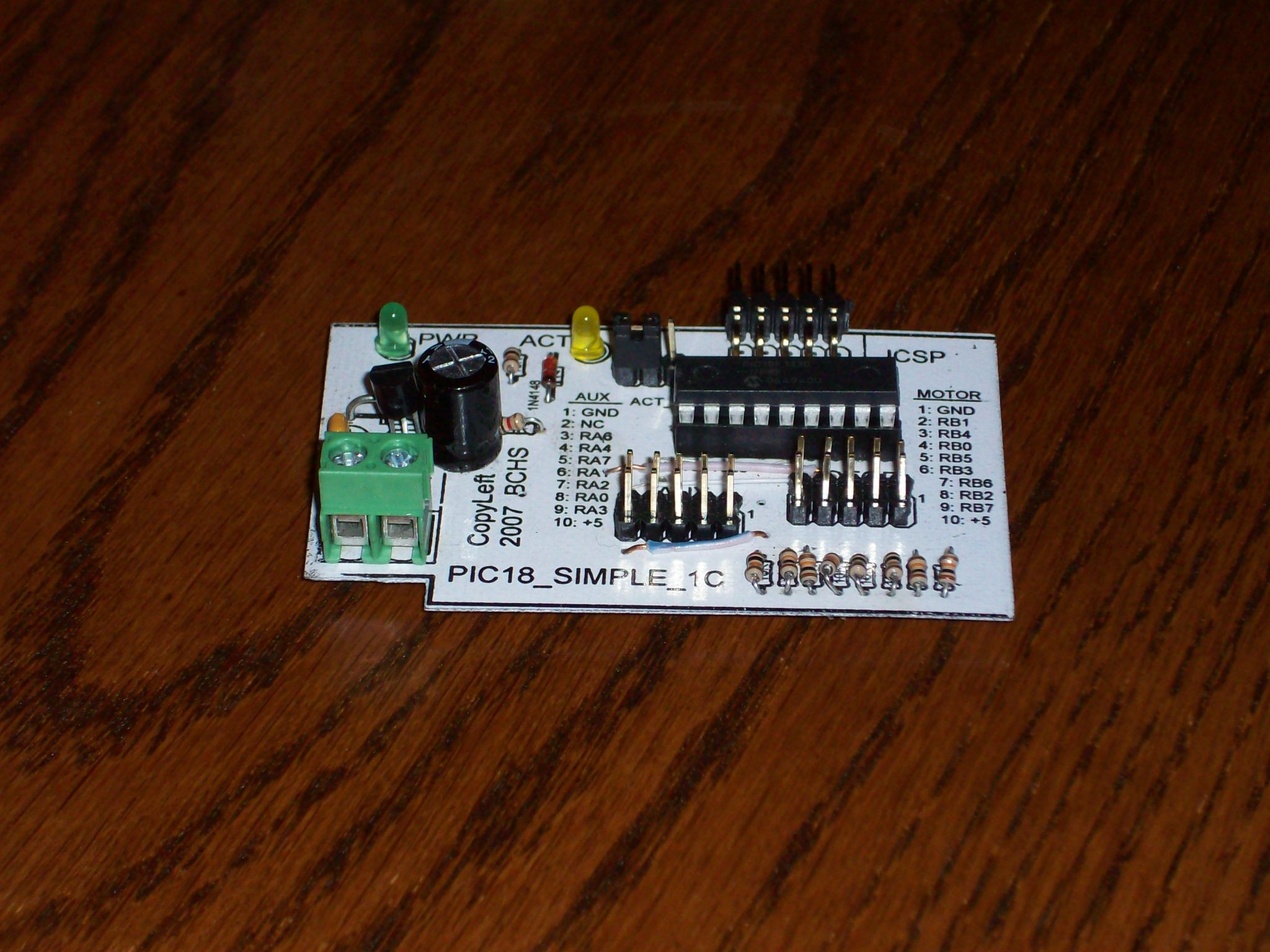

Junebug PORTB header mod
Oh yeah futz you should make a tutorial on picture taking... with like lighting and stuff... This is the best i can do and i really like yours tho.. so feel free to share some tips.

Hey futz look.. I liked your portb mod so i made one :D
Will hot glue soon! But try to make it small amount
By making a PortB mod, it makes the ICSP almost irrevelant. I enjoy using a target board where all the I/O are brought out to 2x5 headers.
