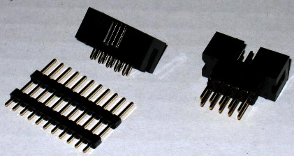

I put this breadboard connector together. I pulled the pins out of the 2x5, cut the long pin connector into two sets of 5. Squeezed together in a vice.

Here it is:
Ugly but useful
Off topic my Power Circuit... (and test LED)
