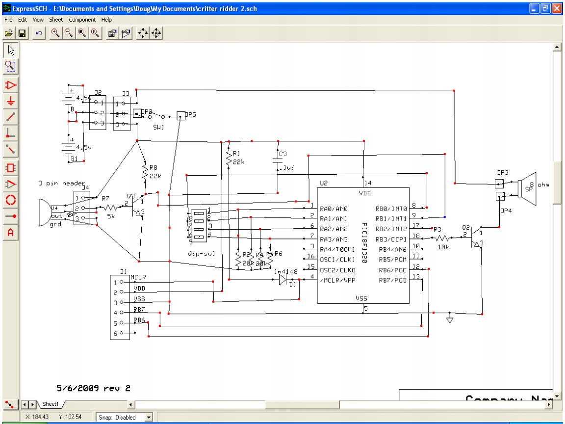

schematic copy of your circuit??
this is hopfully the circuit you have working??
but using just a 2n2222 instead of the lm386.
not real sure about using the LM386 but maybe??

That schematic should work. How long is your cable ICSP for programming I have found that if it longer then a foot I get cross talk.
cable is only 6inches
Am almost certain the PIC needs to be erased
it had same results after programming with 2 different program codes.
I ran the PIC using pickit2 , erased then entered code.
the circuit worked as planed.
don't know why it is different than before??

redid circuit as per be80be=we have liftoff
the thing works.

QUESTION for be80be=in your photo you have 5 resistors tied to the dip switch?? only need 4??

The pic draws lol the fifth resistor is the one that pulled the switch high that I was using as the pir. The PIR it high going low on trigger because that's how your code is.
so I pulled the switch high when trigger it pulls to gnd.
