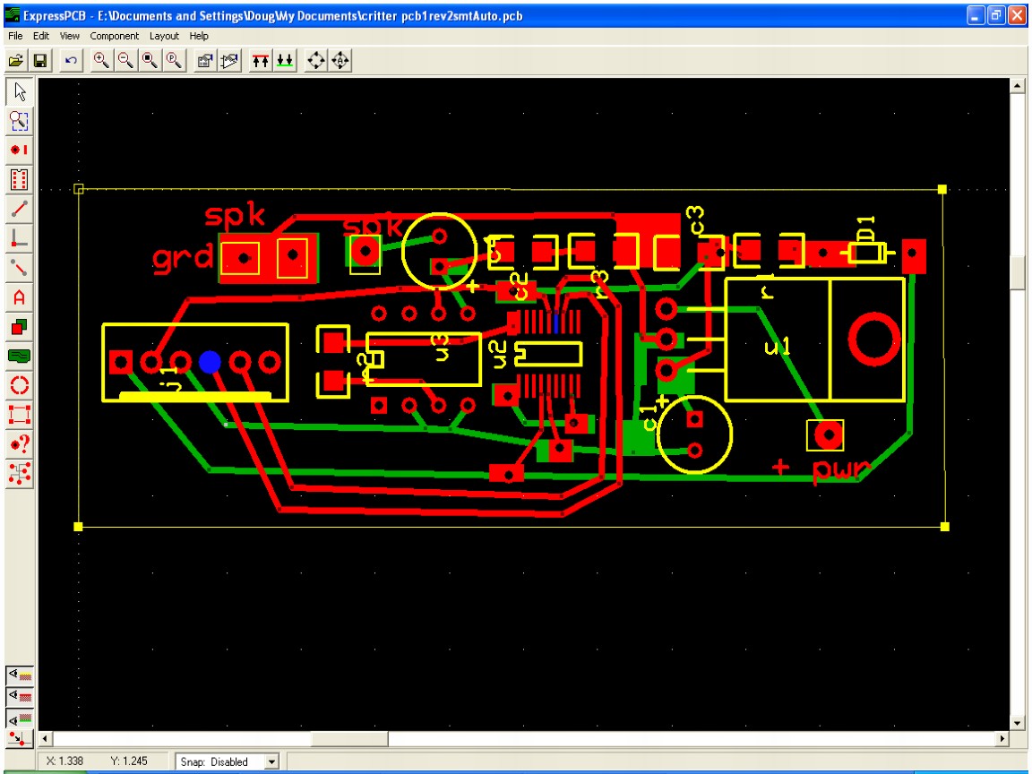

here is layout of PC board using SMD
the LM386 is not made any more , need to find a SMD to replace.
the voltage regulator is cheaper going with the 220 package .75 vers $2.50+
board in present design is 2.02 x 1.430 inches.
will try to fit into a 1inch pvc pipe but not real sure about it.
the speaker is 1 1/8" anyway.
gads this is fun trying to design something to fit into a wanted size.

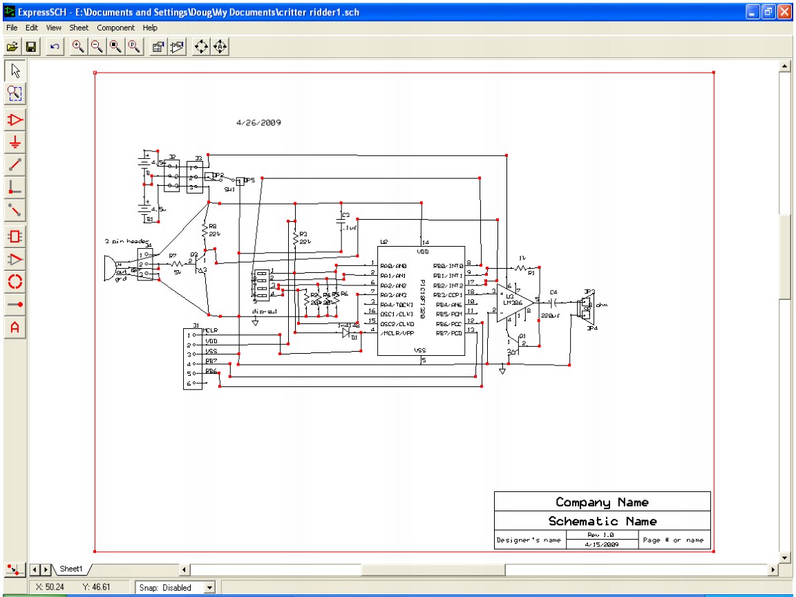

WAS hoping to wire it so plug could go on either way as my original plug is non-polarized.
purchased some polarized 3 prong plugs to avoid end user from connecting plug back on in wrong orientation (I never thought about this thus I applied power to my board and fried a 18F1320 PIC.)
yes I held a memorial service for the little Pic-ie
the plug in question is on my prototype.
attached is what I connected and got the plug backwards = POOF!
now where is that forest??
