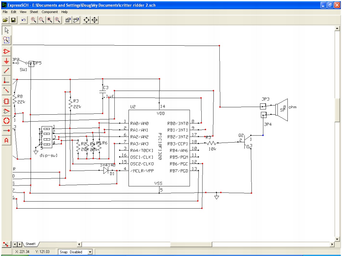

Junebug help??

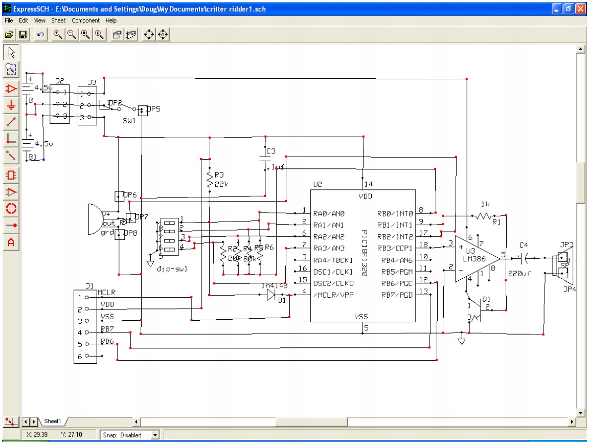

final design schematic
have built most on a breadbosrd but it should all work.
haven't tested the RA3 port/dip switch routine but it should work hopfully.
any suggestions before etching a pc board
cross the fingers etc.

Well it kinda works??
The dip switches don't affect the DELAY()
I had the poert B0 set low but realized I had it backwards.
changed to high, still no different. I read 2.5v on pin 8, not 4.5?? Dip switches take the other ports LOW. ANY suggestions WHY??
Device = 18F1320

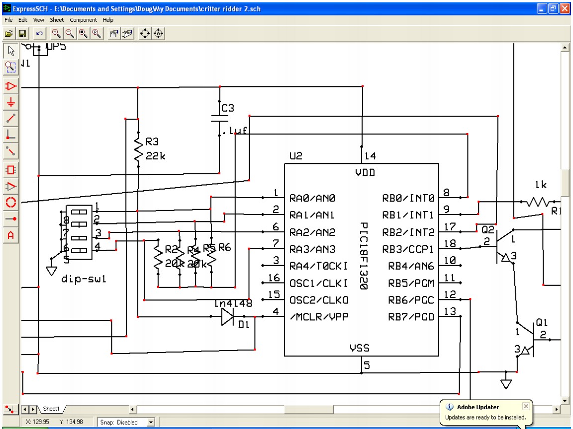

Another problem I discovered was I failed to include the 2n2222 in the PIR circuit.
the PIR goes HIGH on trigger. I have it configured for the pushbutton on the Junebug.
I made a biggy mistake etching boards- the printout came out smaller by a little bit and the dip sockets don't fit.
Need to re-etch and re-drill new boards.
Going with SMT after I get these 5 units built and working.
WHY only 2.5v on high ?? if thats what I told the PIC to do (portb.0)
Revised PIR input
added a 2n2222 to the PIR input (PIR goes HIGH(3v) on trigger so taking RB2 LOW to wake up PIC.
the 5kbase and 20k collector should work??
now hopfully the fact that the PIR wasn't triggering the PIC correctly, maybe with the 2n2222 it will??
coulds be why the dip switchwes don't work??
OH on the PC board printout, only thing I can find is I printed in landscape instead of portrait. I printed out in portrait and it looks good.
driving an 8 ohm speaker?
do I or should I add the cap to the output and base resistor value?
using the LM386 it called for a cap on the output??

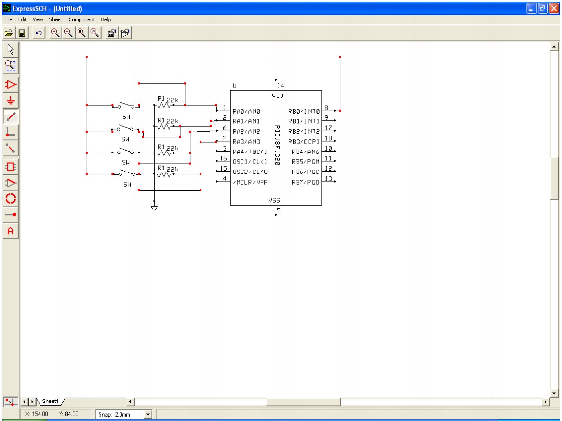

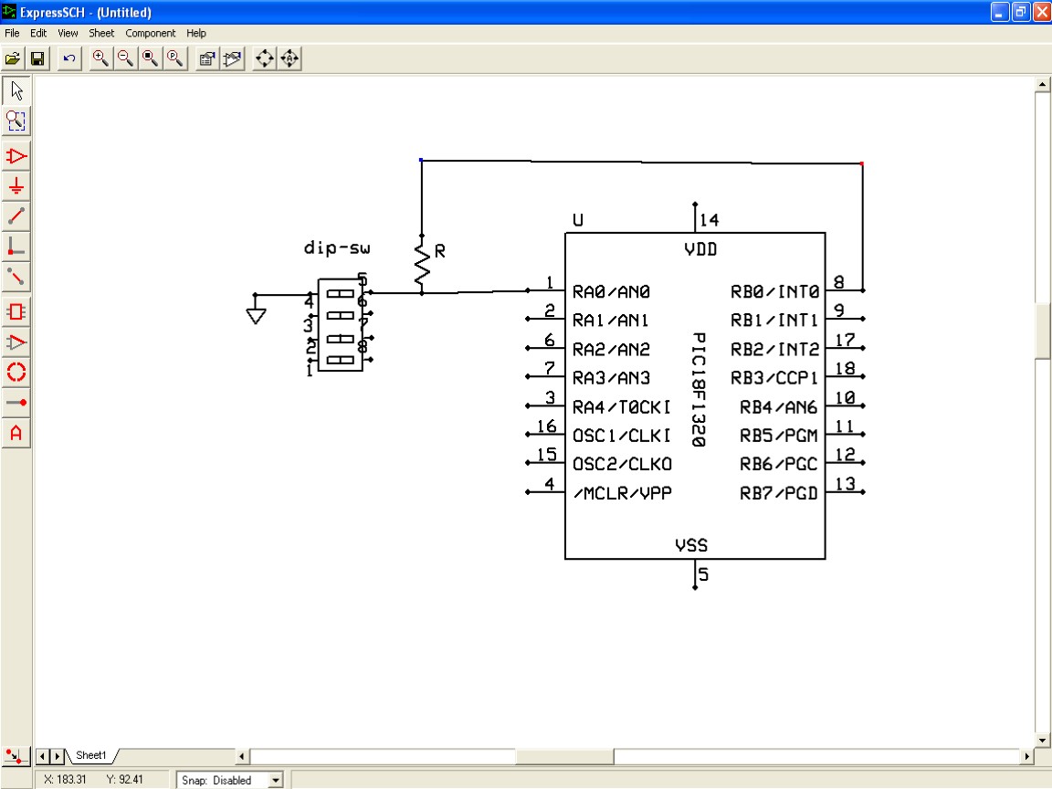

You can't see what your talking about you cut off you circuit. And the way you have the dip switch don't look like it read it right. Your making it high with RB0 and reading which is high it would work better like this

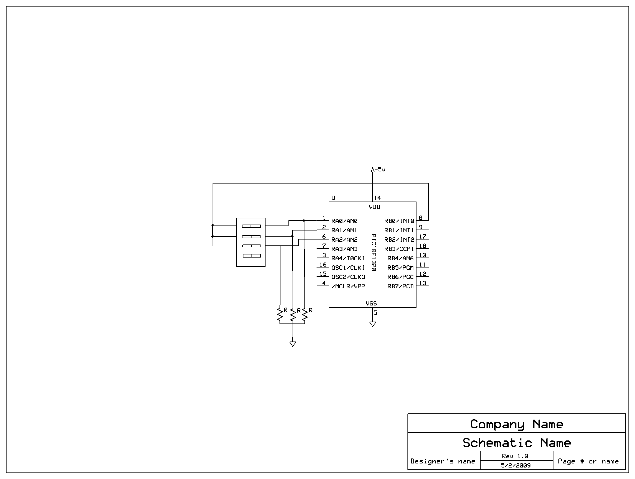

Almost the same??
end result the same???
what about the cap on the speaker and resistor from the PIC to the transistor base.

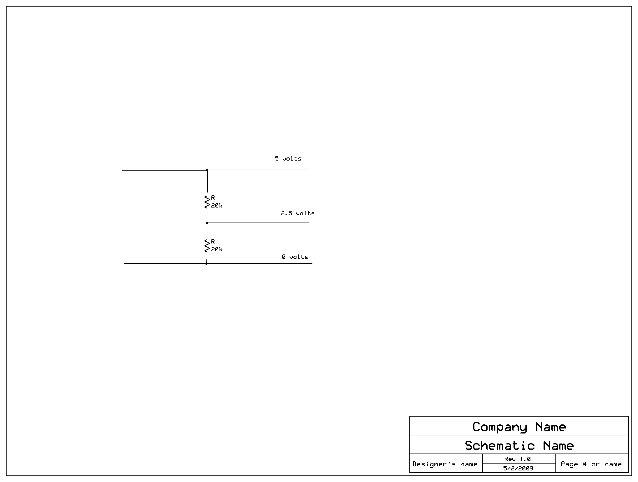

It's not the same your setup can act like a voltage divider. That's why your reading 2.5 volts
Still dosn't work??
The dang dip switch is acting like a voltage divider still??
getting only 2.4 volts on pin 8 when I have any one dip switch on.
I measured between ports pins 1,2,6,7 (no PIC inserted) and all switches off I show 44K ohms.
turn on a switch and get 0 between pin 8 and port but show 22k between ports
DANG it Im so confused.
getting late.
will configure something else??
need to simulate in TINA and move stuff around but this should work but it doesn't.

You need the switches connected to 5V or you need to set PortB.0 to output (TRISB.0=0) and make it high (PORTB.0=1).
I thought that was the ideal for using RB0 so he could turn it off when the pic went to sleep and power his switches high with it on wake up his code showed him setting it high I didn't catch it still being a input.
Right here what doing it

My bag He has the portb set right in his code I meant (TrisB.0=0) I told him about the rest where he was setting this chip up twice. I was writing some code for a 18f1320. And had portb on my mind.
He needs to remove the blue bits, change the green bit and add the red bits.
[COLOR="Blue"]OSCCON = $72 //select 8MHz internal clock
NOT_RBPU=0 //WPUs on port B
ADCON1=$7f //all digital[/COLOR]
//main code starts here
ADCON1=$7[COLOR="Lime"]f[/COLOR]              //all digital
[COLOR="Red"]TRISB.0=0               //make output
PORTB.0=1               //and high[/COLOR]
He needs to work on flow set up the chip test for Pir then make some sounds, Next time Pir gos off make some new sounds go to sleep till Pir gos off.I think that would make it more readable
This won't solve the 2.5v problem??
here is the code to date with any and hopfully all the changes suggested.
BUT I still willonly show 2.5 volts on pin 8 if any dip switch is on.
with all off it shows 5v well actually 4.5 as I am powering using 3 AAA batteries.

I cliped the resistor gong to PORTA.3 and with the dip switch on I still get 2.3 volts, not 4.5
If I have all the dip switches off then pin 8 PORTB.0 is 4.5 volts
I must have something wrong with setting up PORTS A.0-A.3??
they are inputs so do I need to DIM them in the beginning??
and TRIS is to set up a port for input??
There not one place where you set portA up as input and outputs but only for the amp and it's on portB try this and see if it works better

        trisa =%00001111          //[COLOR="Red"]sets your inputs on porta [/COLOR]

no change
I copied n pasted your post and renamed it.
I disconnected one of the resistors just to see it it still works the same.
same DELAYMS() in other words no change
I really want these dip switches but ??
I might breadboard again and leave out the resistors, have pin 8 (RA0 - RA3) connected to dip switch directly w/o resistors or feed the dip switch with 4.5 volts directly but use a transistor connected to RB.0
this way the resistors etc are connected directly to he power supply but not until RB.0 becomes HIGH
a long way around but ??
