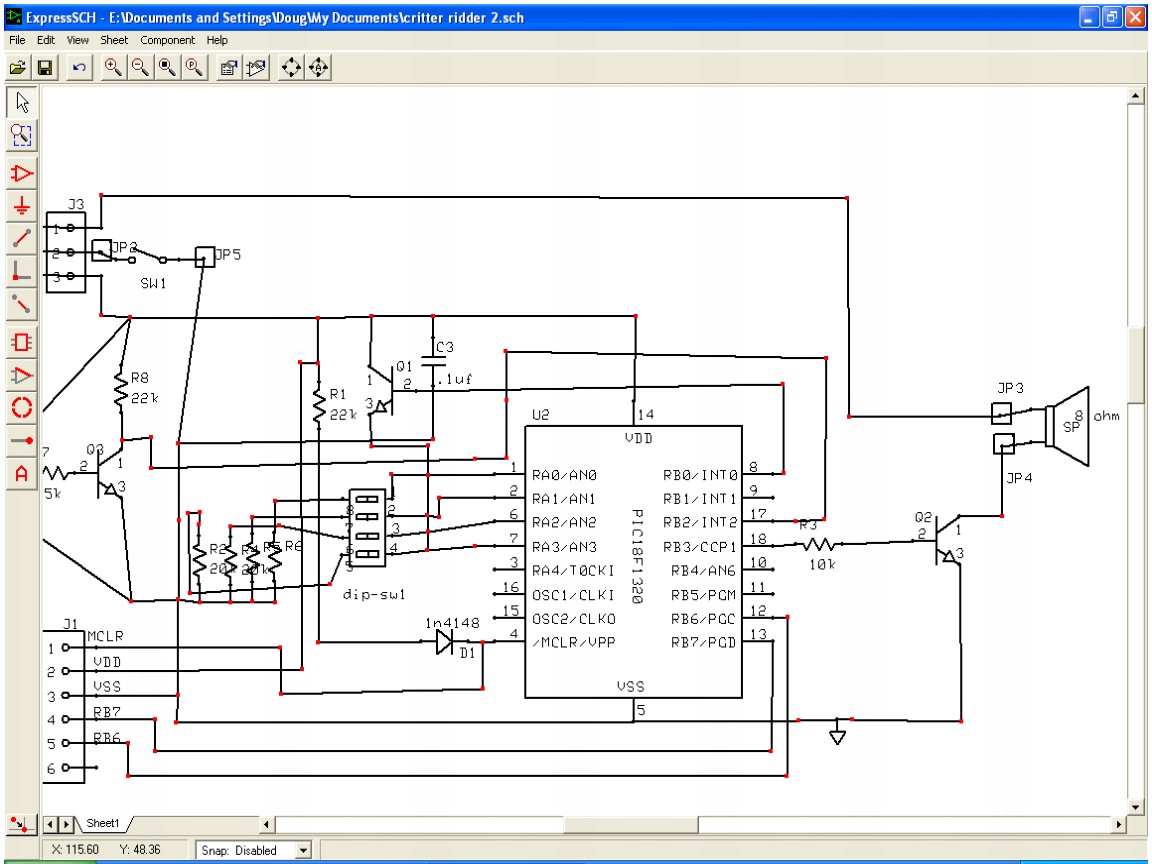

RB0 does show 4.5v if none of the dips are on.
thinking maybe a different approach?? and still utilize RB0 to read the dip switches.
reguardless how I do the dip switches before I still only get 2.5 v on any A port IF any of the dip switches are ON
with this new circuit maybe the PIC will read the dip switches??

Your using PortB.0 to make PortA0 to 3 high you pull all of them low and set 1 high with the dip switch. You poll for which switch is high. It's your code not the switch layout that's wrong If you hooked the switches up like I showed you they will read right.But you can only set 1 switch high at a time.
If you do that like you drawled it It's for sure not going to work I showed you how to hook
it up to read your dip switch But you can't read but one switch at a time you where using portb0 for power. I don't want to sound mean but your changing things before you get it to work is making a mess of it. It's the code that's not working not the switch layout that I showed you.

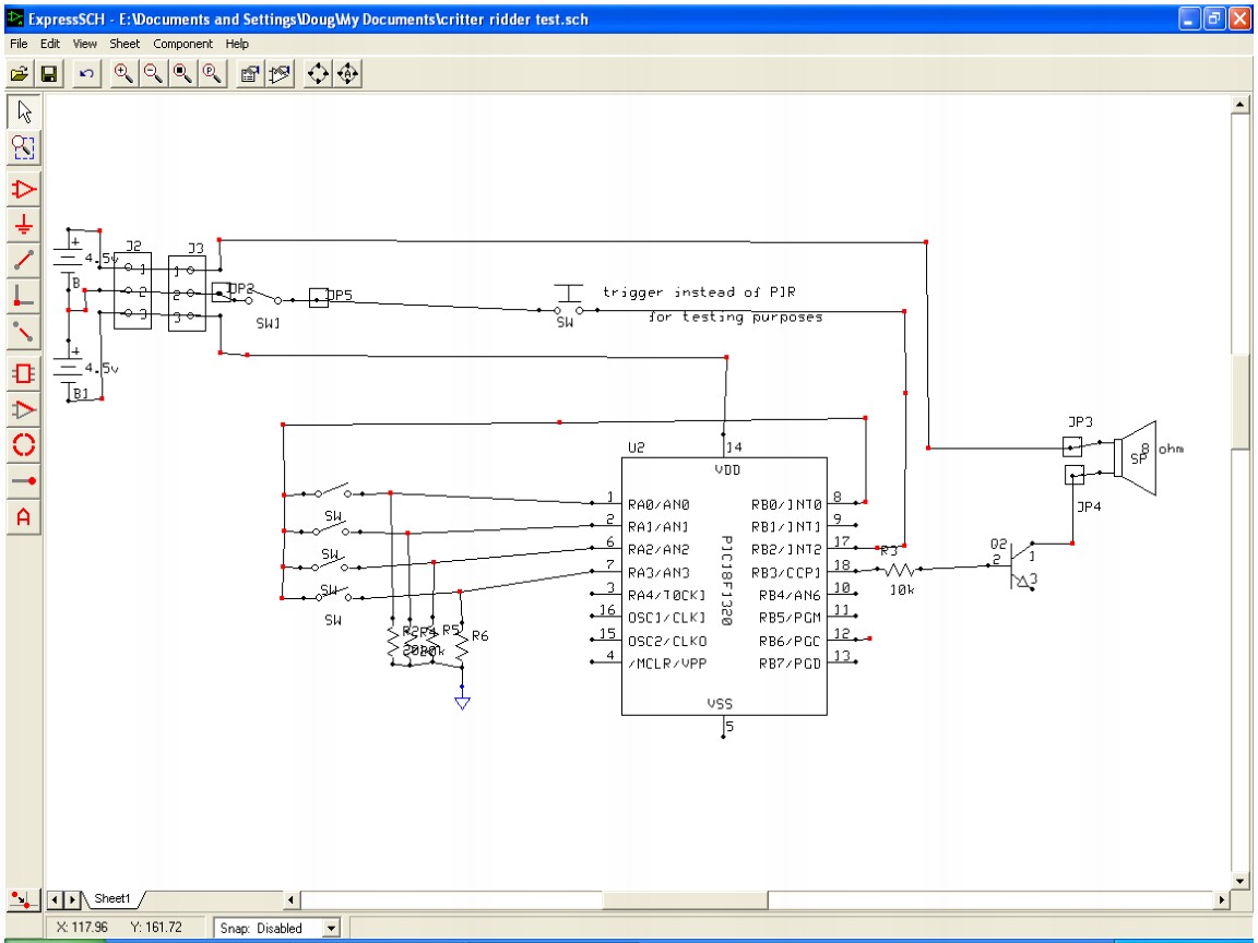

I breadboarded the circuit with-out the PIR (ground pin17 RB2) to trigger.
I have pin 8 RB0 connected to pin 1RA0 = works but not right. supposed to be 25ms delay(really fast)
I have resistors connected to RB1, RB2, RB3 connected to ground.
RB# ports are supposed to change DELAYMS() when selected port is high.
Am trying to eliminate as many component variables as possible.
Its got to be in the code as it is stuck on one DELAYMS()
which one??. I think its 100ms but not sure.

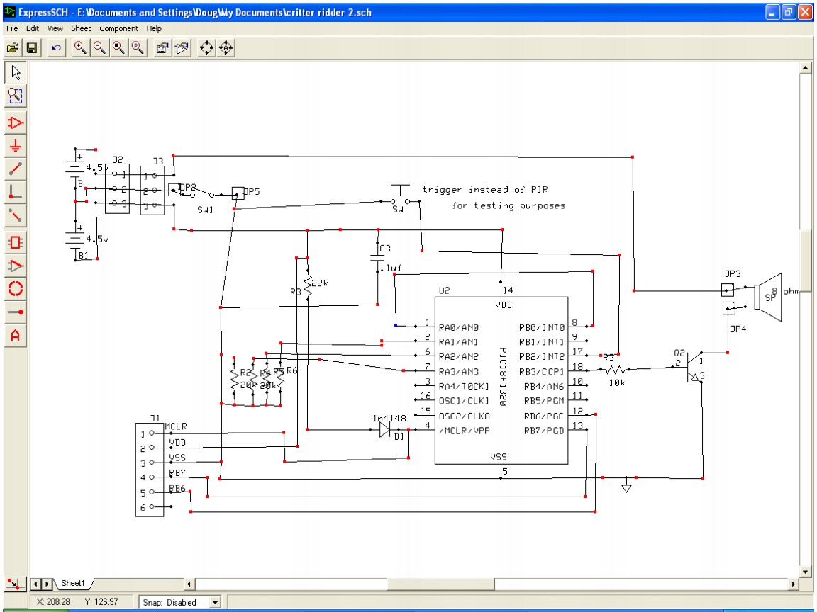

thinking about eliminating the other portsRA1,2,3 and see if it will read ONLY the variable of port1 for DELAYMS() I think its 25MS or supposed to be??
OH forgot
I read 4.5v on pin 8 before the unit is triggered
BUT
when its triggered and pin8 is connected to pin 1 I read 2.1v on pin 1 which is supposed to be high to select the dip switch variable for DELAYMS()

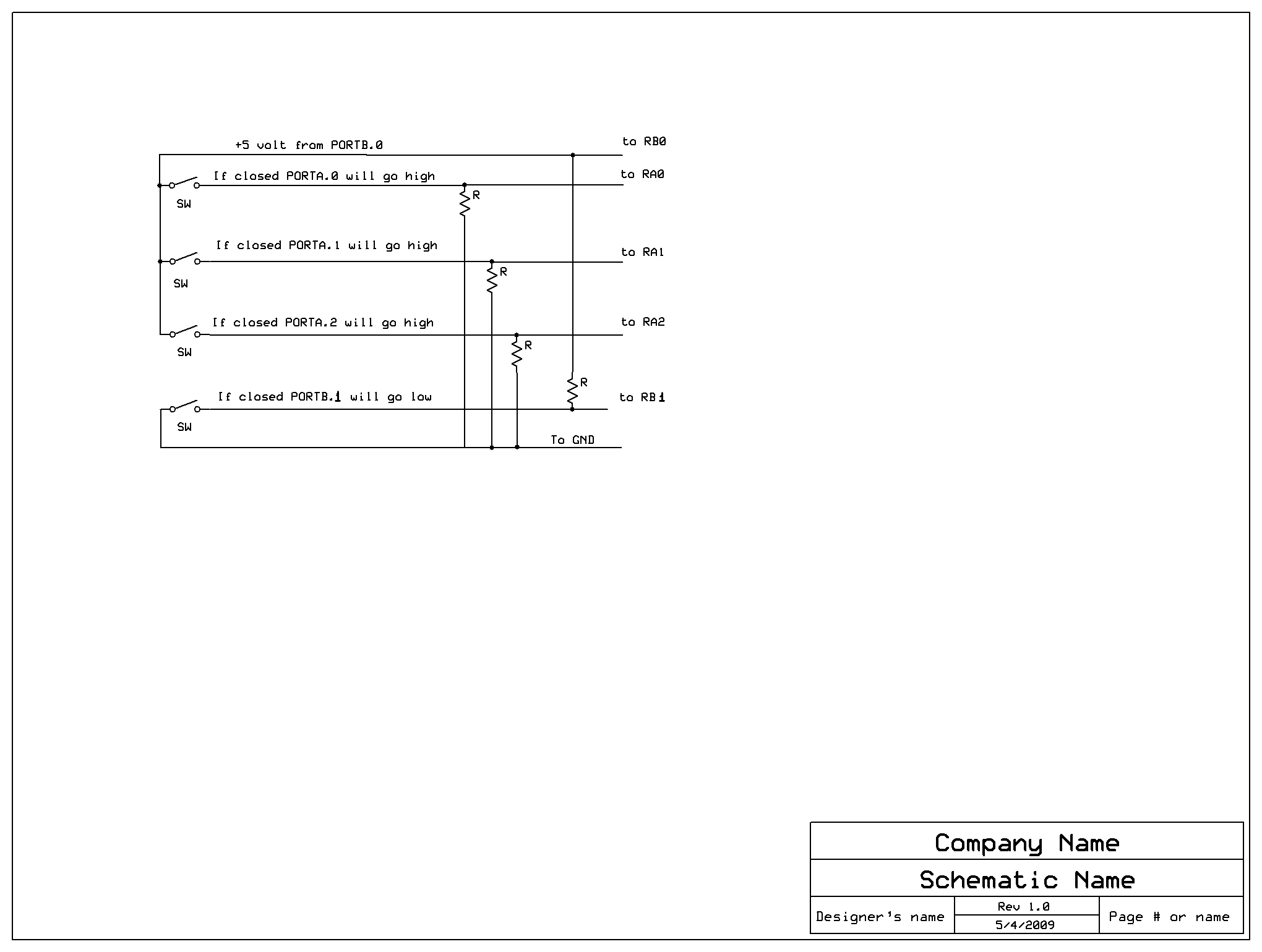

Take a look at this It mach's your code
now im confussed??
unless I made a mistake drawing my dip switches.
you have a resistor going from RB0 to RB1.

Clear drawing of test circuit
Where did RB1 come from (I need to reread my code)I found it. RB1 controls the 9v to the LM386 amp.
could have come from all the copy n paste.
Eliminate for now until I get the dips working.??

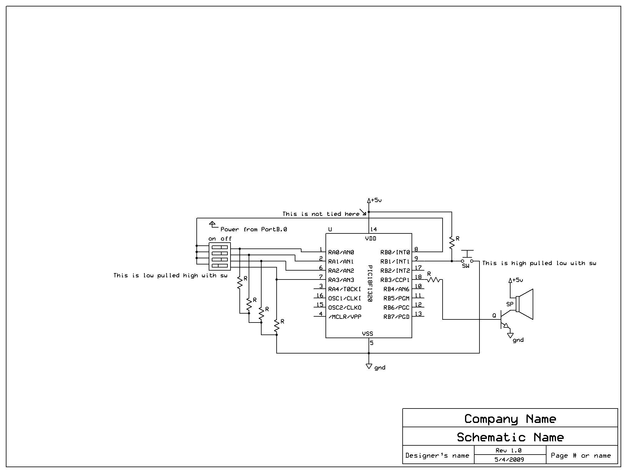

From the top Ok you want to make sound right
1. PortB0 was to supply power so you can put the pic to sleep and not use any but what the Pir used and the little the pic will use in sleep.
2 I just used PortB0 for power to test the switch your using for testing it will not be like that when you install your PIR
3. PortA 0 to 2 are to change sounds right.
So let's get this part working and then add the amp and the PIR what do you think?
I think I found it!!!
I don't have PORTB.0 set up with TRISB.0
TRIS sets the port as OUTPUT??
hopfully this is the problem

Ok I hook it up Like I showed you and it works the three dips change speed and portb.1
turns it on I was going to remove the junk out of your code that's not being used.
This code works if you hook your switches right

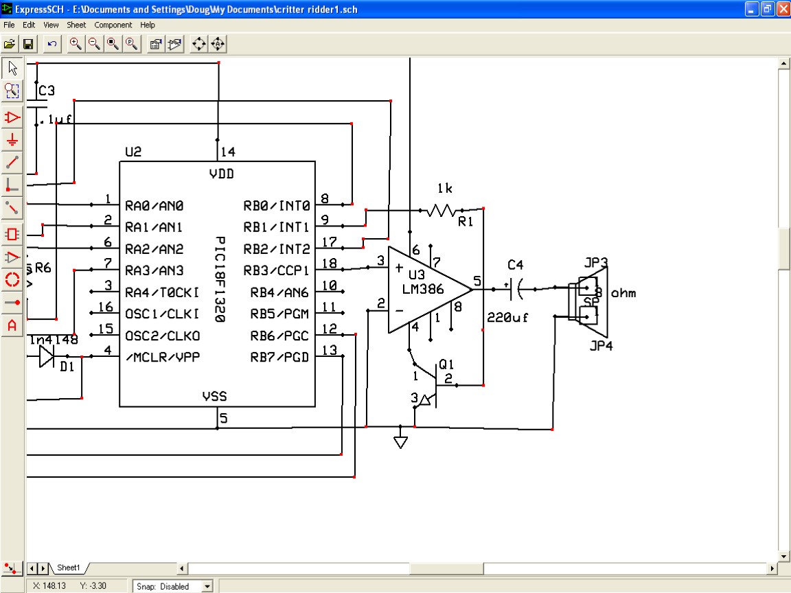

MrDeb when you was using a transistor to drive your speaker what was it I used a 2n3904 I had it laying on the table it's half as loud as a 2n2222 which I used when we started this thing. Try this
switch from RB1to grd?
looking at schematic I assume this is to act like the PIR? to trigger circuit.
havn't looked code over yet but will try your code out.
did you make any changes??
