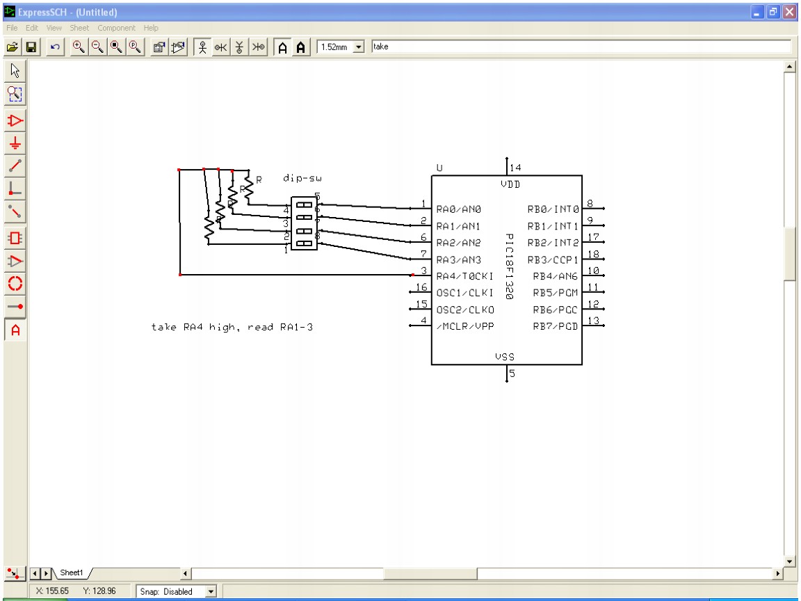

need clarification on pullup resistor connections
You will need pullups on PORTA but you can connect them to another port pin and only make it output when you're reading the DIP switches. This will reduce battery drain.
if I understand this put pull up resistors on all my 4 dip switch inputs and then read those 4ports separately??
OR
have each dip switch w/ its own pullup resistor then connect the common on the dip switches to a port, then make that port high?

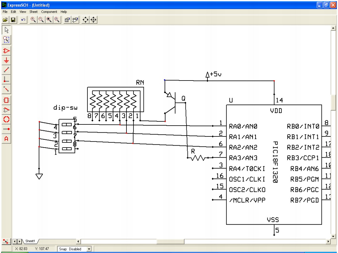

another idea to read dip switches
my first schematic was not right.
this one might just work. In this case we ake RA3 HIGH. run the dip switch read routine, then reset RA3 to LOW
this would save battery drain??
my other idea was to get dip switch 4 to INCREMENT the variable SPEED each time the unit triggers or do a random number for SPEED.??
maybe a private routine that is accessed only if dip switch 4 is LOW and canceling all other dip switches.
You got the idea with RA3 but you don't need the transistor, just connect RA3 to the resistor array. When you want to read the DIP switches you set RA3 to output and high, the rest of the time you set RA3 to input to save power.

in other words the transistor
is overkill??
I was thinking that shorting RA3 to ground is a no no ( dead short?)
change to an output?
how do I determine an output or input
is overkill??
You wouldn't be shorting A3 to ground as it would be through the resistor array which should be around 20k each.
To switch a pin to input or output you use the TRIS register. Setting it to 1 makes it input and zero output. So TRISA.3=1 will set PORTA.3 to input.

I just copied that code from a project to demonstrate where the Tris should be set. For all digital (on a 18F1320) ADCON1 should contain $7f.
Using the internal pullups on portb cuts down on external components and so is normally the best way. You can use porta but you will need the external pullups.
