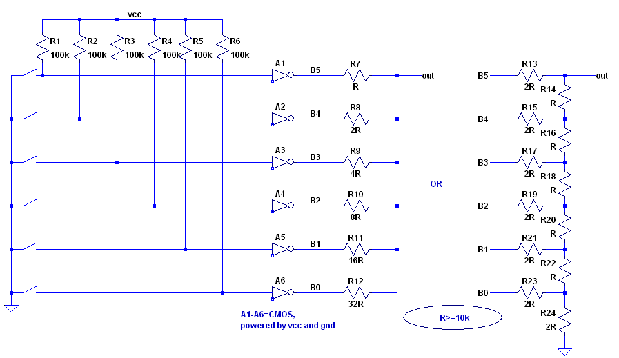

I have been told that my attempt to read a 6way DIP switch through ADC on a pic was wrong ( https://www.electro-tech-online.com/threads/digital-dashboard-circuit-review.26954/ ), so i have been googling away, and i have attached a schematic of what i have made based on my findings.
Can anyone confirm that this is an 2/r2 ladder, if it will work going from the out straight to the input on the pic.
Are there better or worse values to use for 'R' and i assume the 2R is quite literal
should these be high value, low value, or it makes no odds?
thanks again
graham
  • R2R.pdf

Looks fine, but are you wanting to read 64 individual positions?.
High enough not to take too much current, but low enough to meet the requirements of the A2D.

I think your switches need to be double-throw, i.e, the switched (2R) legs always need to be the same resistance.
Why can't you get 64 levels with 6 switches?
2^6=64.

Did you understand my comments about the switches? You might have to drive the ladder with CMOS logic (inverters, gates, FFs, whatever). Switching from +5V to OPEN won't work.

You don't need an op amp, but you do need low resistance (relative to R) for the switches in both logic states.
does this mean that my design is totally unworkable?? if so can you suggest any way of reading 6 dip switches using 1 pin on a pic (digital or analog)?
Graham
For simulation, I use Linear Technology's SwitcherCAD III, which is free, uncastrated, and fully functional. The learning curve is a little steep and a little long. I have been using it for years.
I simulated your ladder to be certain I wasn't wrong about the switches.

Here's how I would do the 6 bit D/A.
thanks - i'll look at that, and depending on how well i get on with my currnt design - i'll try building this into my next one -(im hoping to make a SMT version once my first 50 of this design are done, and i'll have money to buy new parts then, like the logic chips)
