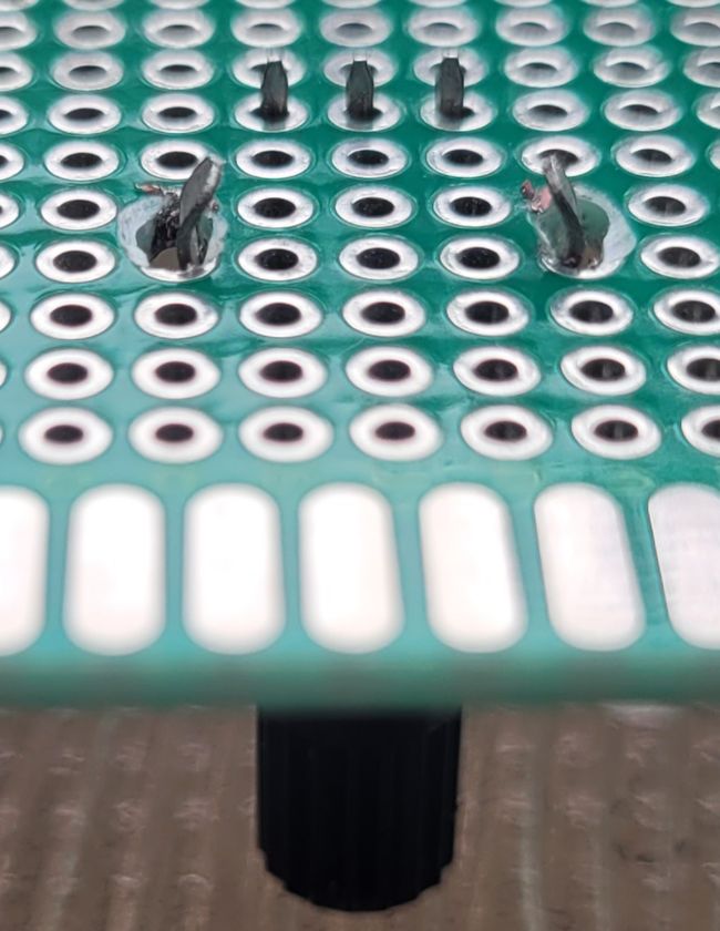

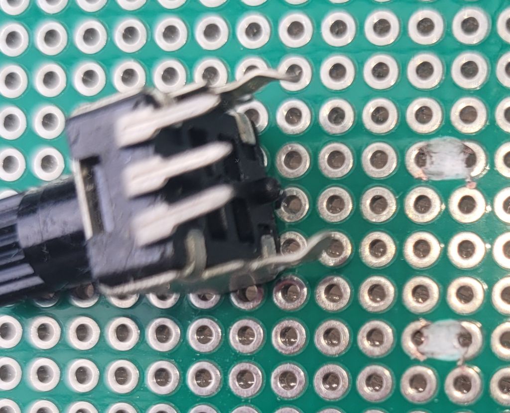

I have a personal project that needs a pot.
The pot I have has mounting tabs that don't fit in the proto PCB holes. Moreover, to make the pins fit, I had to "join" 2 pair of PCB holes.
I ground the PCB a bit with the Dremel engraving tool, then I drilled through the remaining material. Finished the job with a small file by hand. The final result was so-so and I deemed it good enough.
I don't have access to a drill press, nor to a router.
I am wondering if there is a better way to do than. Would you have any useful tips for me?
Use a small drill bit part way through the material and "rock" the drill in the plane of the wanted slot. It will mill quite a bit away. Drill an intermediate hole first if needed, then do that in each hole to join them.
Just take your time so you don't snap the bit.
I use that technique for cutting large holes in panels & boxes etc., starting with a row of holes just inside the required cutout line
Use a small drill bit part way through the material and "rock" the drill in the plane of the wanted slot. It will mill quite a bit away. Drill an intermediate hole first if needed, then do that in each hole to join them....
Well, that is more or less what I did.
I have tried in the past to drill a tiny hole between two 0.1" holes and wasn't very successful. That is why I removed some of the PCB material off first with the Dremel.
I guess one can get better at it with experience.
Next time I'll probably enlarge the existing hole(s) with a 1.5 mm drill bit and file off part of the pins/tabs.
