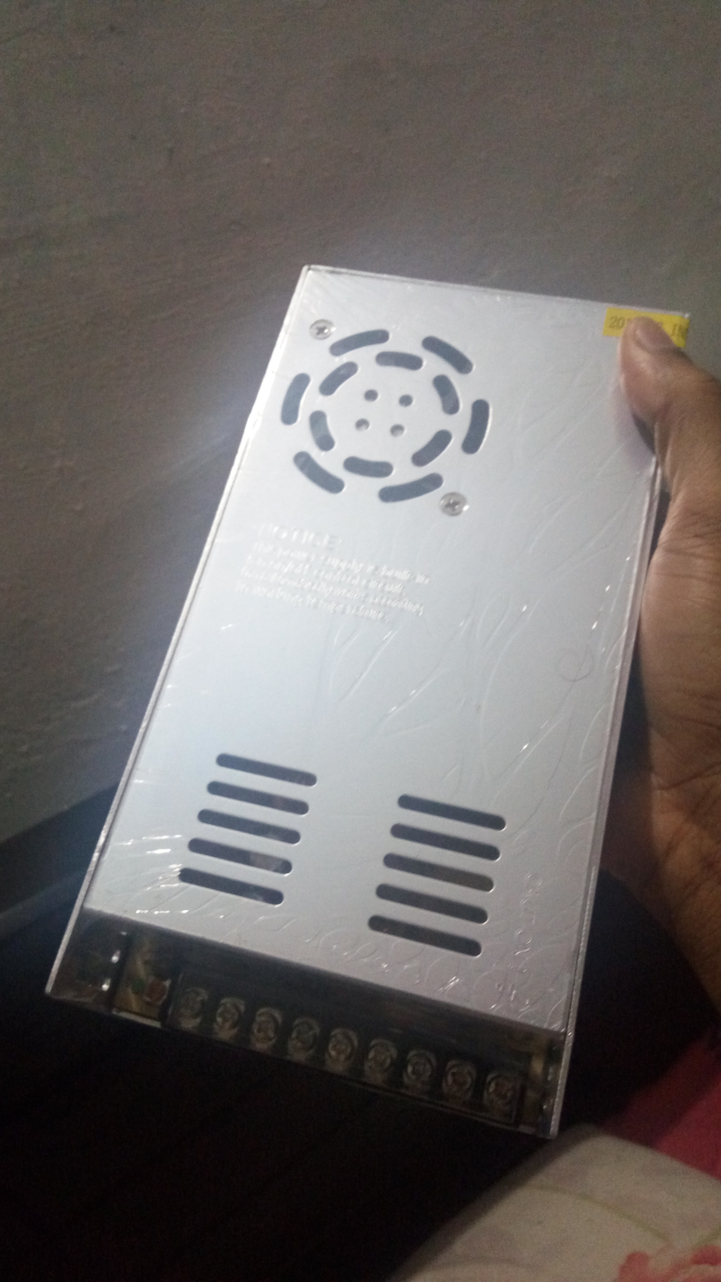

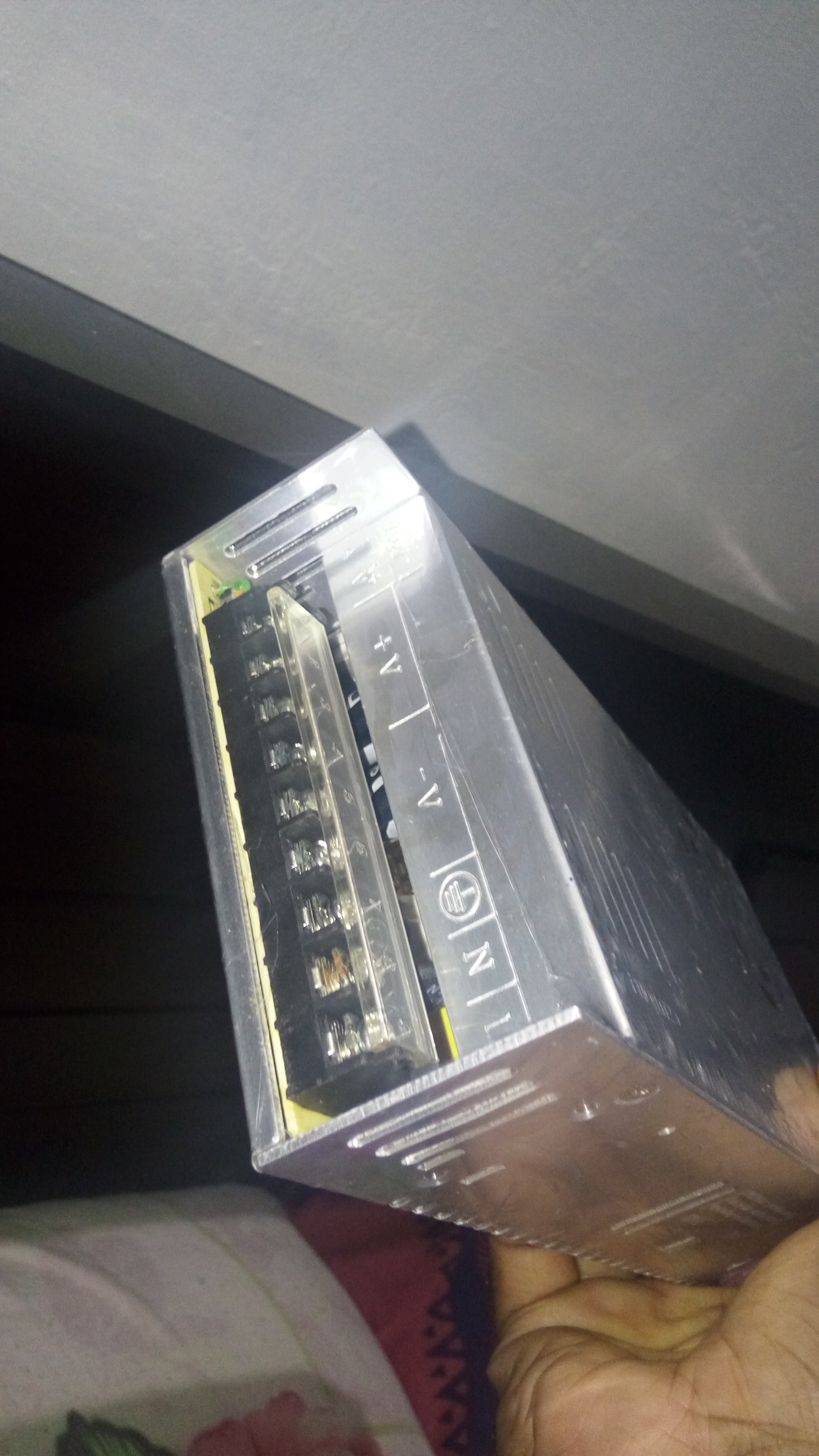

Hi unclejed, the dc-dc converter you mentioned may be helpful, i am looking for one online and found this https://www.amazon.in/DC-Converter-...scsubtag=8f2069ce-2adc-4b53-a703-13088760586a but sadly it can only output 3A-5A, my subwoofer needs atleast 10A, is there any similar circuit that you know?, my powersupply is a SMPS, and yes i was mistakenly bought it because i thought it had dual supply out, but the Ground sign of it was for earthing on the wall, not the 0v line. Here is a photo of it

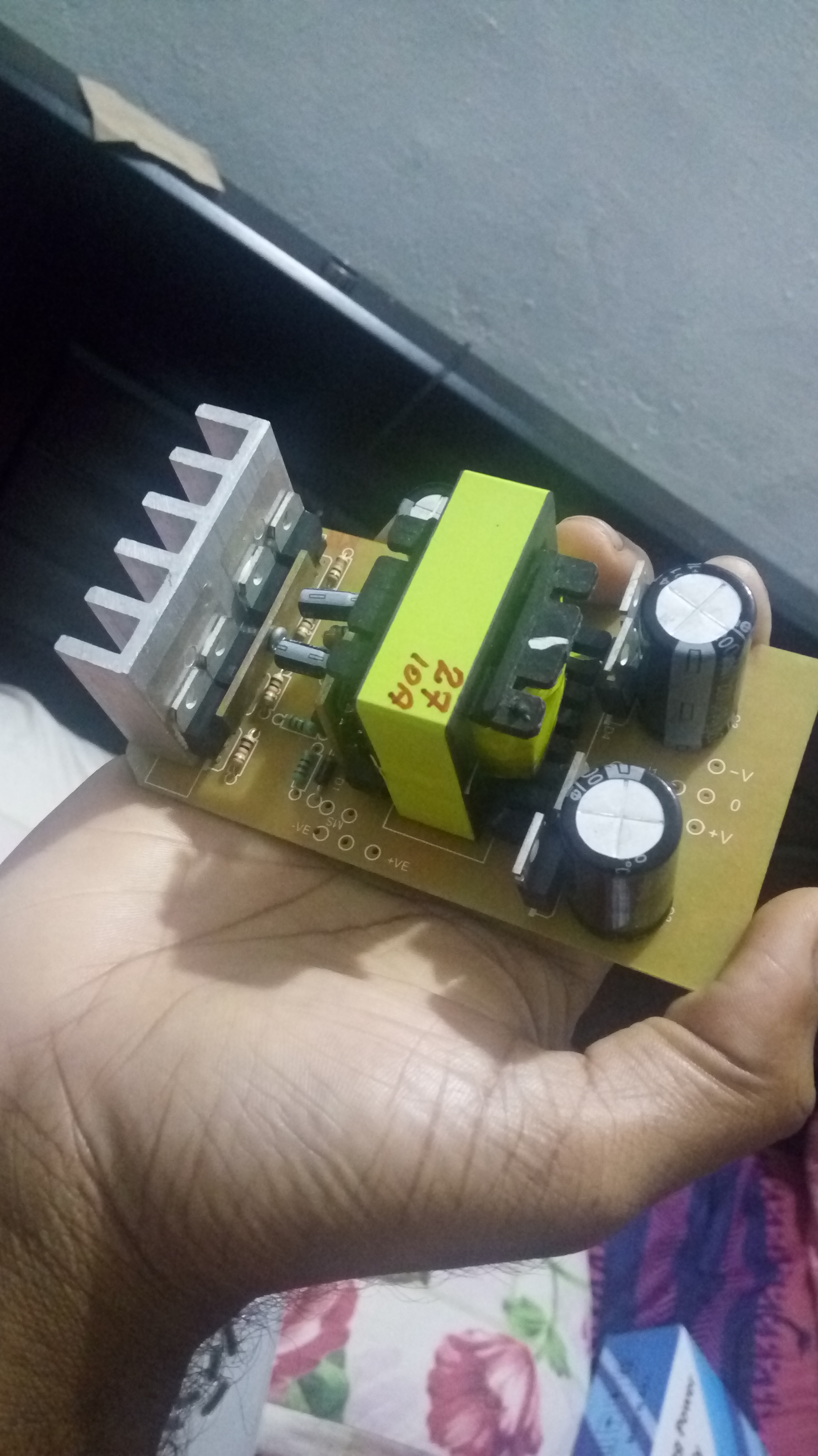

Hi guru, it's a 4.1 sound system that i want design but the subwoofer circuit board needs 27-0-27V so i bought this (attached below) to boost 12V to 27V , i want use LA4440 for 4 channels because these ics will work from single supply, and a MOSFET Amp board for subwoofer out but that needs the dual supply, the board's output capacity is printed as 400 Watts, do you think 2 MOSFETs can provide 400 watts out from just 27V 10 Amps supply?​

Didn't you see my post? With only 24V it is almost impossible for an amplifier to use 10A. If the amplifier is bridged for most power and the speaker is 4 ohms then the speaker gets 60.5W and heating is about 50W for a total power from the power supply of 110.5W. Then the max current is only110.5w/24V= 4.6A, not 10A.
Before the subwoofer amplifier needed plus and minus 12V but now it needs plus and minus 27V.
The 54V Mosfet amplifier is rated at 400 phoney Whats when it is clipping like crazy, which is about 325 real Watts with reasonably low distortion if the speaker is 4 ohms. The heating will be about 215W so the power supply must produce a current of (325W + 215W)/54V= 10A.

I'm a litle confused by your figures?, for a single ended amplifier off a 54V supply rail, I make it as less than 75W in to 4 ohms, and probably a fair bit less as it's MOSFET, and they don't do well getting close to the supply rails. Assuming it's a bridged amplifier?, then you're looking at four times the power, so under 300W in to 4 ohms.
As for the OP, BUY the correct voltage PSU - it's a really silly idea buying totally the wrong one, and then trying to add things on to make it work. You say you want 'efficient' - you've completely blown that in the first place by not buying the correct supply.
