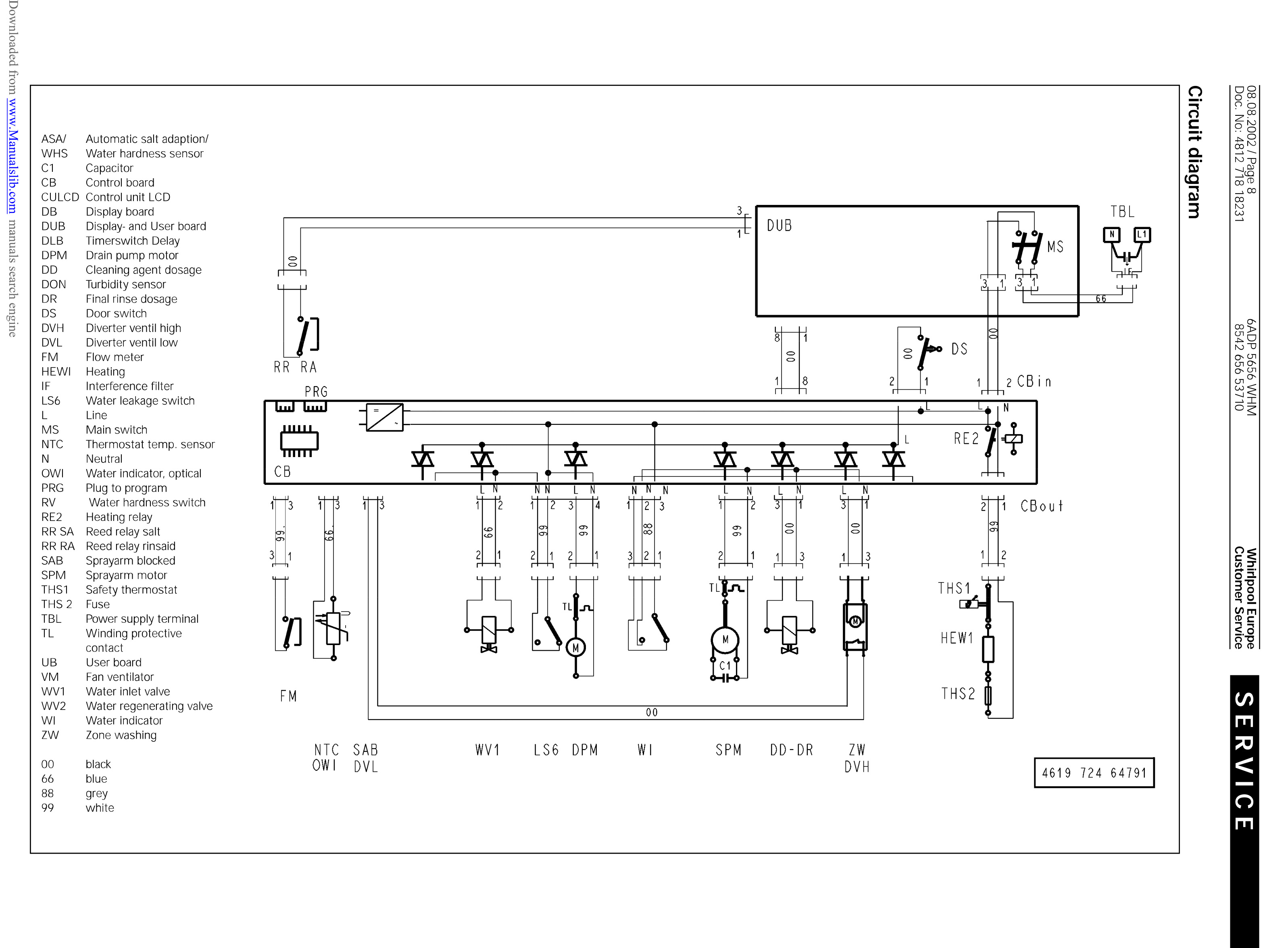

Is it possible to determine voltage from this schematic?
swervyn
Hello people :)
Wondering if it is possible to determine the voltage from this circuit diagram at the WV1 terminal?
This is the inlet valve of a dishwasher that is showing a fault code. Seems that it is either related to the inlet valve or possibly a control board short.
The inlet valve is one of the aqua stop valves with a solenoid built into the hose, like this one:
https://goo.gl/images/JGc8Mh
Power supply is 240V. I have removed the valve connector from the board and taken a reading across the terminals on the control board with the dishwasher powered up, reading shows around 70V AC
Basically trying to determine whether to buy a new aqua stop hose or if the control board is cooked, throw the dishwasher in the bin.
Preference would be to repair to save $$$ but not wanting to spend $100 on a hose that may not be the problem. Googling has not really given me any answers how to test the valve, but assume to connect voltage, turn on the water and see if the valve opens & closes as it should. The 70V reading on the control board is throwing me a bit.
Dishwasher is about 15yo so has had a good run with a few repairs by me over the years, latest being a replacement pump.
Just trying to be a tight wad and repair if possible and get another couple of years out of it :)
Plus I hate washing dishes by hand!
As far as I'm aware the inlet valves are 240V (and the schematic, such as it is, shows that), you may not be getting a correct reading because you're using a digital meter, and it's switched via a triac. Easy to see if the board is switching or not, simply connect an incandescent bulb (such as a table lamp) to WV1 and see if that lights up when the water is supposed to turn on.
If you are reading 70v, most likely you are reading current leakage thru a snubber circuit.
Nigel's idea is a good one. Drive a small incandescent light bulb and see what it looks like. and measure the voltage across it.
Emphasize small, certainly not more than 25 watts. I doubt the control circuitry is designed to supply more than 100 mA or so, and if you overload it you may damage what was a good board.
The crude schematic shows a triac feeding the valve (which is what you're likely to use), and triacs don't often come particularly tiny, so it's probably at least a 1A triac, so there should be no problem. However, a pygmy lamp would be a good idea anyway.
Thanks guys, will try a small lamp later today and report back. If it is indeed 240V, should I then be ok to apply direct voltage to the valve to check open/close operation?
Ok, latest update is 240V test lamp did indeed light up when machine cycled on, so seems control board is ok. (And showed 240V with multimeter). Pulled hose & valve out and connected to water supply & 240V and the damn thing worked. I did whack the valve a couple of times with a wrench first which may/may not have fixed a sticky valve. Powered up and off numerous times and the valve worked fine. At this point I realised I could not be stuffed trying to resurrect a 15yo dishwasher so went out and bought a new one lol. And typically researched online the one I was going to buy and ended up with a completely different and more expensive one :banghead: Had the valve shown a fault or the control board shown a fault I would have been more satisfied, the machine has had a minor leaking problem for a while and I just figured it is not worth the hassle of trying to diagnose the fault code so opted for the easy way out.

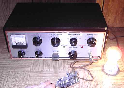

My mind hurts LOL never hurt nothing using a lamp as dummy load in my life even works to see if a CB is outputting power
Here one on a transmitter
Here is a nice setup
