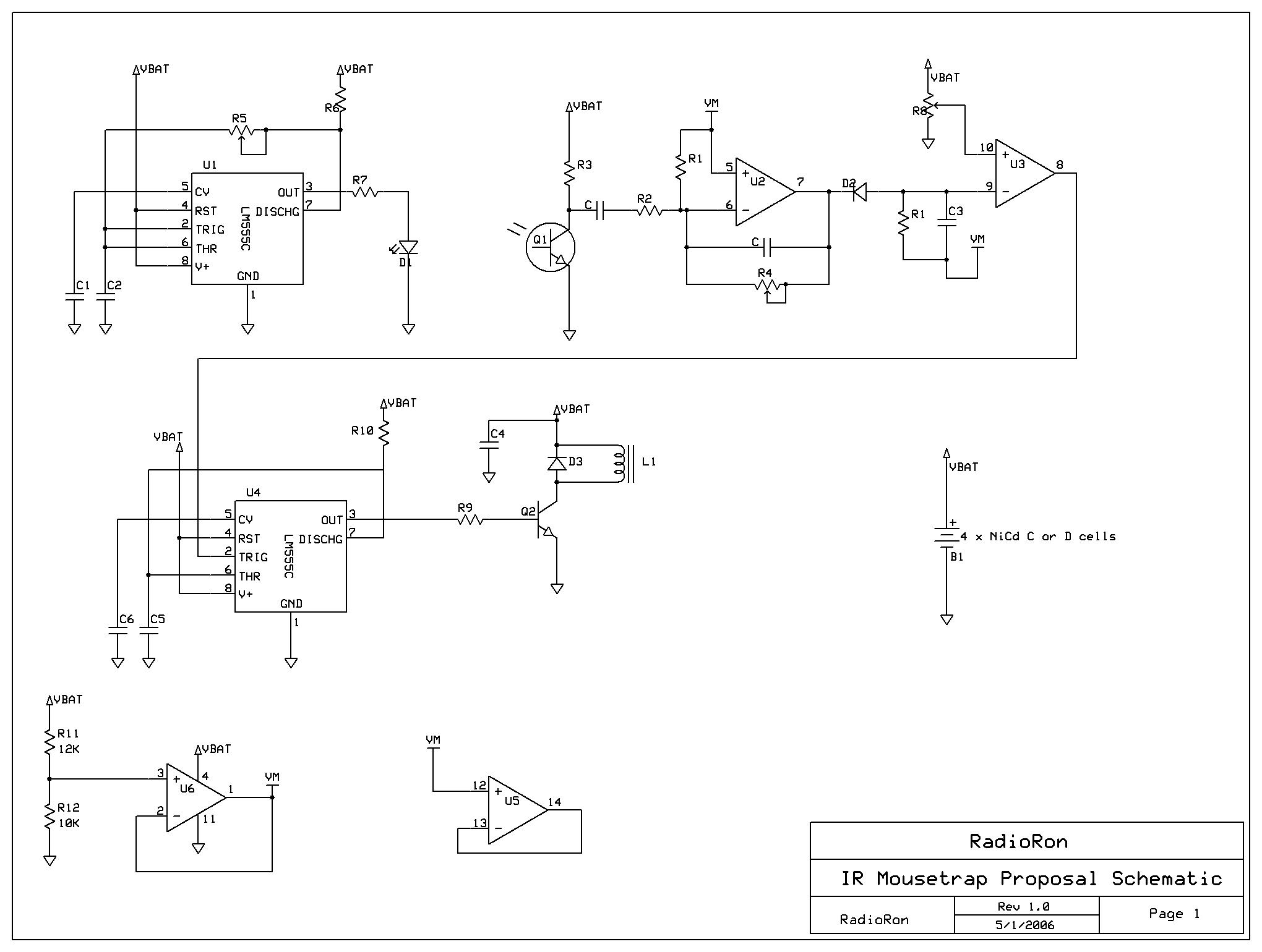

The attachment is my first attempt at a schematic for this. Refer to it for this discussion.
I copied your transmitter without changes except it is powered from 4.8V VBAT. The receiver circuit has been modified to operate from a single power supply instead of +/-12V. The specific changes include the addition of R1. This provides a DC bias to the negative input that is referenced to VM which is a voltage that is halfway between 0 and VBAT. (please note that I made a minor mistake, R11 should be 10K). This VM is supplied by U6 which is an op amp configured to buffer the voltage generated at the junction of R11 and R12. We use an op amp this way to make sure that VM has a low equivalent output resistance. In this way, when we attach it to other circuits those circuits don't interact with each other depending on how much current they push or pull into VM.
The next change is that R1 and C3 are connected to VM instead of ground. This ensures that the quiescent bias point for U3 is 2.4V.
To connect the receiver output to your monostable, we first look at the polarities of the signal. When the IR beam is not broken by a mouse, you will be receiving a strong IR signal, so the 5KHz AC will pass to U2 and be amplified. In this case the output of U2 should have a large 5KHz AC output. D2 along with R1 and C3 work together as an AM detector. When there is a large AC output from U2, then the voltage on C3 will be below VM. When there is no IR beam being received, the voltage on C3 will be at VM. U3 is used as a comparator. When the IR beam is being received, the lower-than-VM voltage on C3 will be compared to the voltage that you adjusted at the slider of R8, which should be just a bit below VM or about 2.2 V. So when you receive the IR beam, the output of U3 will be high or near 4.8 volts. When the IR beam is broken, the output of U3 will go to ground. So this tells us the polarity of our output; high = no mouse, low=mouse in trap.
Since the trigger input of U4 is active low (when it goes low it triggers) we already have the correct output polarity from U3, so we can hook these directly together. So U3 output is connected directly to U4 trigger input.
More discussion in the next message.
My apologies for such a large graphic (I have to scroll left and right to see it all).
I have left the component values off intentionally to give you something to figure out.
The output of the monostable, U4 is fed directly to the solenoid driver Q2. I did this because I can see from the data sheet that U4 when triggered will put out a high and otherwise will remain low. The transistor is configured as a common emitter amplifier so it will turn on when the output of U4 is high and off otherwise which is what we want. You need to calculate the value of R9 as it is important to choose the right value here. You also need to choose an appropriate type of transistor for Q2. The most important parameter to watch for is the maximum collu77777777876yu (oops, my cat just walked across the keyboard) collector current and power disipation.
U5 is on the schematic because I didn't like the idea of using 741 op amps. So I chose a typical quad op amp device instead, where there are four op amps in one IC. In this case, the Vcc is at pin 4 and -VDD at pin 11 which is common to many types. U5 is a spare op amp so I've wired it up to not misbehave and oscillate. Your job is try and pick a better op amp from the many types available. The key parameter is to consider the dynamic range of the op amp output. It would be best if you chose a type that can swing fairly close to VBAT and GND. I've already picked my favorite and we'll see if we agree on this once you make your pick.

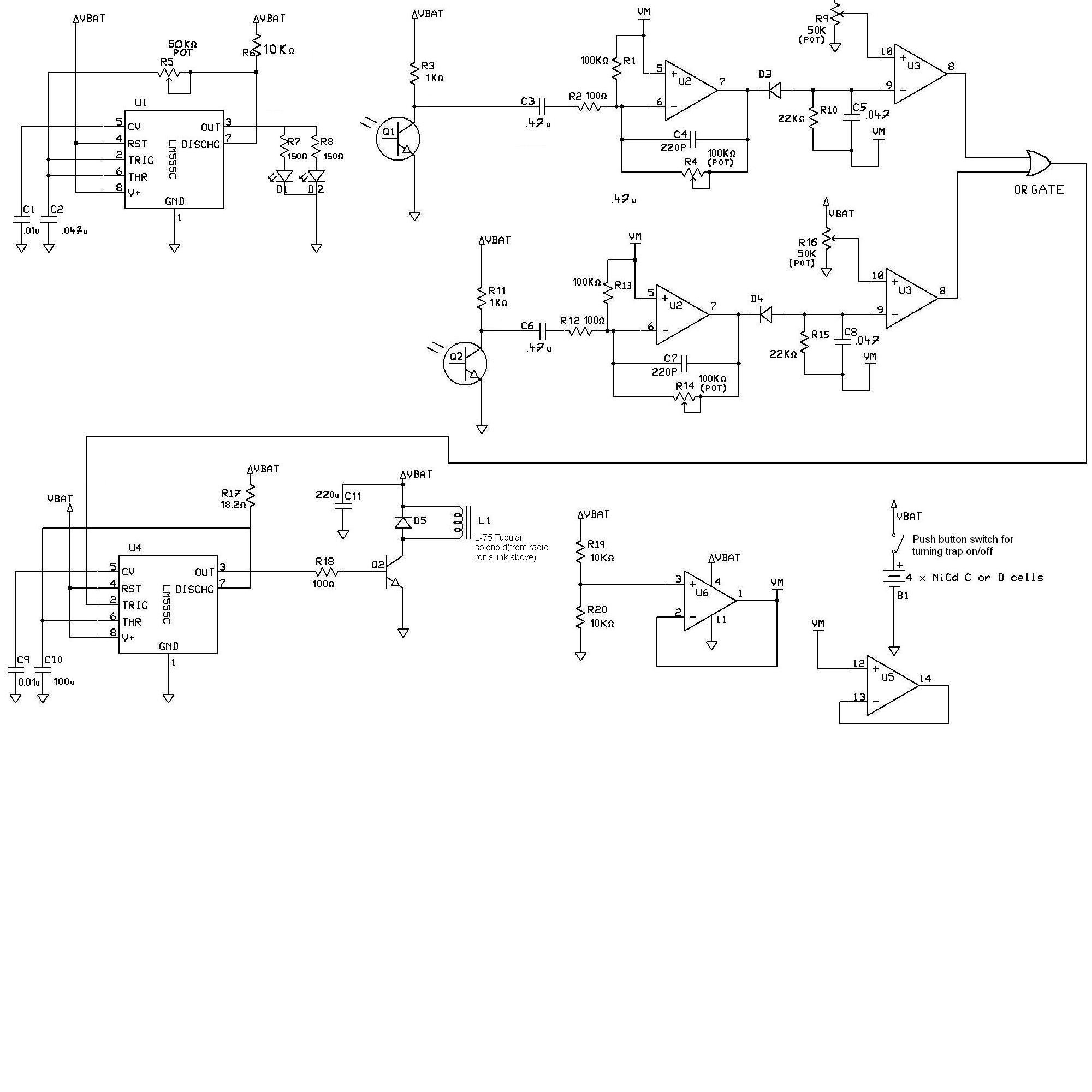

id just like to ask a few questions before i start working out the component values uv left out..
i can only see 1 IR diode/transistor. i really need 2 beams as it will pick up anything that moves if i dont.
C3 is the .047uF capacitor and the second R1 is 22k resistor from my circuit right? would 10k be ok for the first R1 resistor (the new one u added)?
thnx a lot :)
I forgot the other IR transmitter and receiver. The transmitter IC U1 should be able to drive two LEDs without much trouble in parallel, so the simplest way to have two transmitters is to add a second duplicate R7 and D1, also hooked up to U1 pin 3. Beware though, that this will force U1 to drive double the output current, which depends mostly on the value of the two resistors R7 and the new one. I recommend that you set the resistor values for a peak current of 20 mA instead of what was on that other circuit you are copying. They are using 45 mA per LED, probably to span a larger distance. In yours, start with a lower current and see if it works first.
For the second receiver you will be forced to duplicate quite a bit of circuitry, including all the circuits from Q1 and R3 all the way up to the output of U3. The second IR receiver needs its own sensor (Q1), amplifier (U2), detector and comparator (D2 and U3).
Once you have the second receiver, we can logically OR the two detector outputs together using an OR gate, or by using some diodes. I will leave this for you to figure out. The OR'd result will drive the TRIG input to U4.
Sorry about the two R1 labels. The first one should be roughly similar in value to R4 but this isn't critical. U2 is configured as an inverting amplifier and as such the junction at pin 6 is a summing junction. So, when we include the first R1 we are "adding" whatever voltage is at the other end of R1 to the voltage that is on the left side of R2. Since the left side of R2 has a DC blocking cap, only the AC voltage comes through there. So we are adding the AC from Q1 collector to the DC at the top of R1, which is VM. This is how we bias the op amp up to 2.4V for single supply operation.
R1 (the second one) and C3 are indeed 22K and 0.047 uF as you had before. The resistor and capacitor are chosen to have a time constant that is fast enough for the capacitor to discharge if the 5KHz being received and rectified at D2 disappears but not so fast that the circuit doesn't charge up C3 fully to begin with after a few cycles of 5KHz. Its an AM detector. You can study those more by looking up simple AM detectors used in AM radios.
We can review and give more advice once you have a schematic of the entire setup with component values as best you can work out. Don't show us little bits of the schematic, show us the whole thing, as context is often important to us.

Calculating resistors R7+R8
Photodiode used: Fairchild QED233
Most performance parameters specified at 20 mA.
Voltage drop for photodiode at 20mA is typically = 1.2V
Timer used: LM555C
Output voltage drop(high): when 5V (close to 4.8V)@100mA the output voltage is 3.3V typically.
Resistance for this output = (5-3.3)/0.1 = 17 ohms
Output voltage when putting out 20mA = 5-(0.02 x 17) = 4.66V
But I will use 2 LEDs each taking 20mA so the output voltage will be: 5-(0.04x17) = 4.3V.
4.3-1.2=3.1V
3.1/20mA=155 ohms
so I will use a 150Ohm resistor before each photodiode.
Calculating resistor R18 (R9 in previous circuit)
Current needed: 40mA.
Output voltage when putting out 40mA = 5-(0.04 x 17) = 4.3V
4.3/40mA=107.4
so I will use a 100Ohm resistor for R9
so here is the circuit with values added, plz tell me if u think it needs altering, thnx :)
Those values seem OK. I do have a couple of other issues to mention though. You have included an OR function which in principle is correct, but in practice you have to watch out for polarities of inputs here. What I mean by this is that the output of each receiver is what I would call "active low". This means that when the mouse is breaking the beam, the receiver output will be a logic low, or in this case, 0 volts. When the IR beam is not broken, the output of the receiver will be high, or nearly 5 volts. The OR function that you have chosen is supposed to work with active high inputs, not active low inputs.
Let's review the OR gate for a second. When each input is low, the output of the gate is low. When one input OR the other input is high then the output of the gate will be high. If both inputs are high, then the output will also be high. This means that both IR beams would have to be broken for the output to go active. Is this what you intended? I thought you wanted it to work such that breaking either beam would sense the mouse is present.
When you are dealing with active low inputs (or as some might call it, negative logic), then you can get an OR function using an AND gate. Its easy to see how if you go through the basic logic. The AND gate will have a high output when one input AND the other input are high. This means that if either input is low, the output is low and when both inputs are low the output is also low. So in fact the AND gate performs an OR function for active low signals.
If you must use an OR gate there is another way to fix the problem so that you are indeed getting an OR function. All you need to do is to flip over both D3 and D4. This will flip the output polarity of the op amps following the diodes so that when IR beam is being received the op amp output will be low instead of high.
Another minor issue with the OR gate is that you don't specify a part number and you don't label the pins. Your schematic is incomplete in this regard and difficult to review. For example, if you are going to use a quad OR CMOS gate, and you showed the other three unconnected gates, we could tell you that their inputs must be grounded to avoid trouble.
When I first suggested a schematic I forgot to include the second IR transmitter and receiver, so you have drawn them in which is good. However, my original thought was to use a quad op amp (thats four op amps in one package) and I see that we now have a total of six op amps. In this case, we need to choose the actual part numbers. When we do, we will choose to have a quad op amp and a single op amp. In this case, we don't need U5. I only showed U5 before because it was an unused spare and we must always show how we have connected our unused spare gates and op amps.
What type of op amps shall we choose. We should go with ones that are rail-to-rail output but otherwise the circuit isn't too critical, so many types will work. Everyone has their favorites and there are several types that are available at low cost from many vendors. Do you have any opamps already that you want to use? What are their part numbers?
Looks like I'm a little late for this one, but here's another way you could do that. In this design, the IR beam is pulsing at some frequency, and picked up by a phototransistor (which is connected as a tuned amplifier). The R-C-D circuit at the collector acts as an AM detector, and the output is fed to the trigger of a monostable multivibrator. When the IR beam disappears, the MMV pulses the solenoid.
Doing it this way, you can turn down the power to the LED (with that variable resistor) to just a little more than it takes to prevent the thing from going off.

hmm this part here:
''When one input OR the other input is high then the output of the gate will be high. If both inputs are high, then the output will also be high. This means that both IR beams would have to be broken for the output to go active. Is this what you intended? I thought you wanted it to work such that breaking either beam would sense the mouse is present.''
i need the trap to close when both beams are cut as i dont want the device to trap anything like a small insect or something. I dont really understand what u mean here, as you said when the mouse is cutting the beam, the reciever output will be a logic low, so when both beams are broken the inputs to the OR gate will both be low and as u need high, it will output a low wont it?
i dont have any op amps, ill need to order the right ones, and yes that would be a good idea to use a quad op amp, but if theres 6 op amps in the circuit, we would need another quad op amp (dunno if u can get chips with 2 op amps in).
i_build_stuff: im gonna stick to the circuit iv already got, but thnx very much for the suggestion anyway :)
