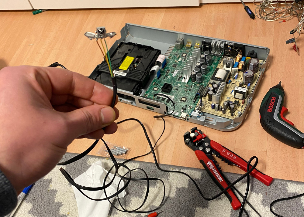

I wanted to exted the ir diode on reciever behind the tv but i accidentaly connected cables wrong and now its not working. I bought new diodes i changed but still isnt working.
Anyone have any idea what the problem could be And how can i solve this?

I mean emitter i removed from reciever and i wanted to extend because i have the reciever inside of tv-sideboard i connected 3 wires and send the emitter behind the tv.( i have done this allready twice before in my recievers and it worked) but this time it didnt work.
I bought new emitter i installed direct in reciever but isnt working anymore with original and will the one i bought.

Im going to send 2 pictures i think that will explain exactly
1-st pic i removed from reciever
2-nd i extended with 3 wires because i want it to a place my remote controll can reach.
after i did this it is not working anymore so i have ordered some more but its not working with them too.
I have tried to connect it back on reciever but still not working.

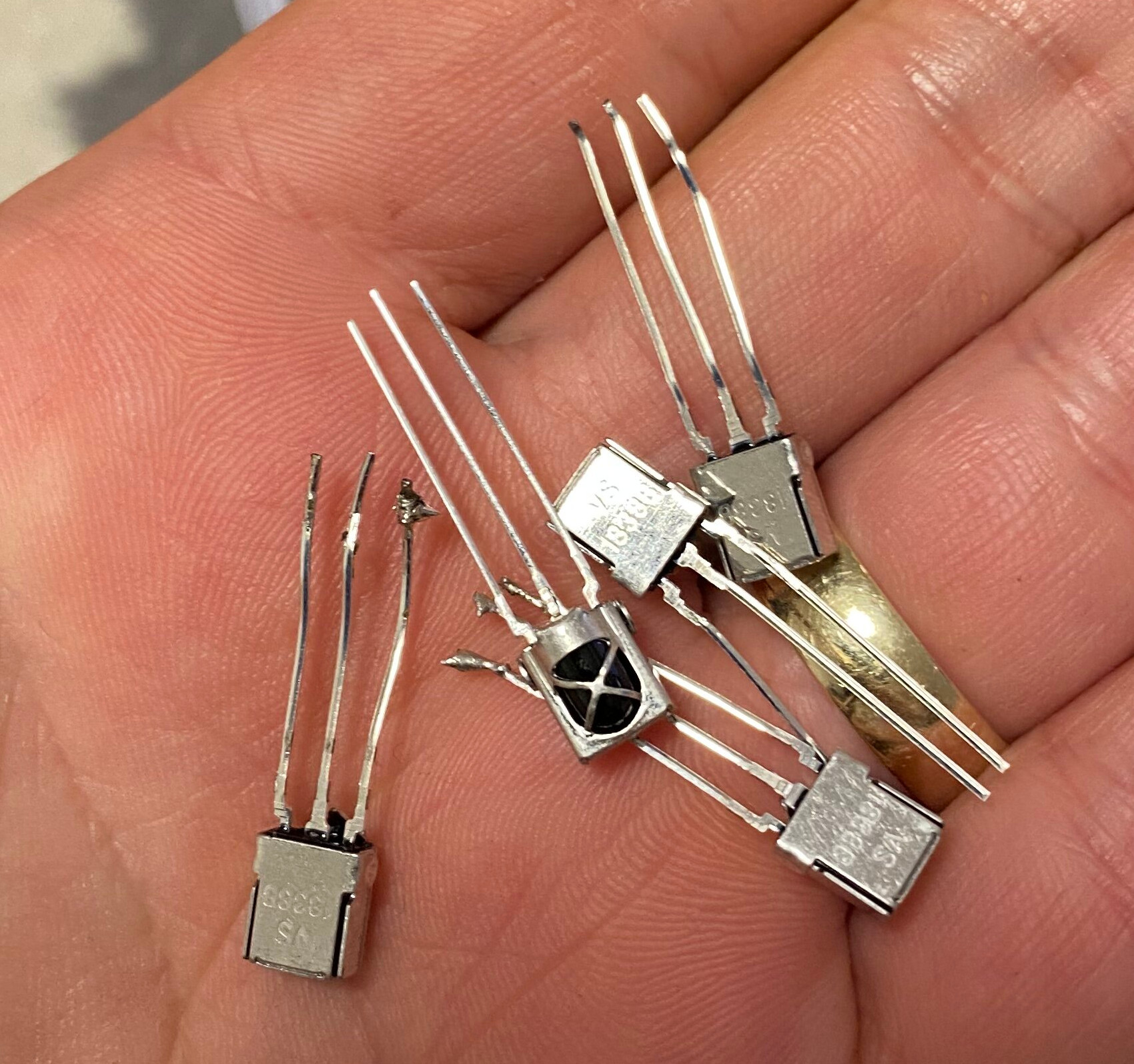

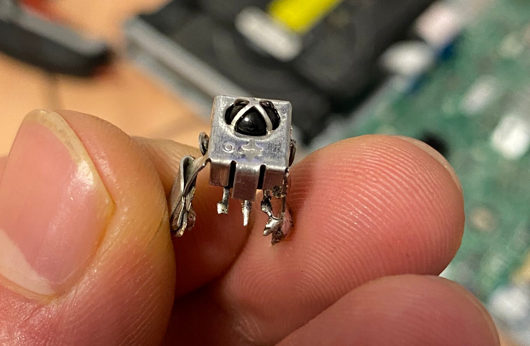

What's printed on the old and new receivers?
f you have a link to the datasheet you think it is, post it.
Damaging the IR receiver is probably easy to do.
See if you can measure the voltage on the pins to what you think is ground. You should probably see +5, +5 and ground, if the reciver is not installed, that should be OK, just note that it isn't.

old reciever CB1963
New reciever VS 1838B

I can't find the datasheet on the CB1963, but the VS part is likely a good choice. Reversing power likely would kill the sensor. The VS part, basically as some noise immunity.
Not all IR controls work at the same frequency, but probably would work a little if your really close to the sensor.
I guess, you could have figured out how to connect using some reverse engineering.

I would start checking pin compatibility first of all.
In my experience (and I've replaced a LOT of IR receivers over the years), the frequency makes sod all difference - it might slightly limit the maximum range, but still MUCH further than you would ever need. In fact we only ever stocked one type at work (TFMS5360), and used that as a replacement for all.
Biggest issue is the pin connections, different types often have different pinouts.
