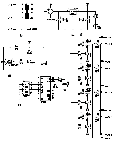

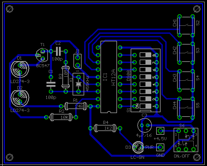

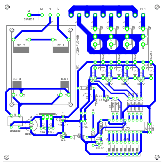

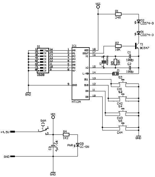

I have a new project, but would need some help. Its an infrared remote control with multiple buttons. The buttons would be used to control the relays. But the reciever is not to be based on a PIC and also the transmitter (remote). Can some body help me out with some schematics.

Here are the schematics of a 4-channel IR-remote switch using Holtek HT12A (TX) and HT12D (RX)
No Pic necessary for that.

You can built one such remote controller with HT6221/HT6222 multipurpose encoder. Please follow the datasheet to be able to customize the chip for your purpose. HT6221 can encode 32 keys and the HT6222 can do the same for 64 keys.

That one should work.
As blueroomelectronics already mentioned the circuit is based on "Anykits" schematics.
If you are interested PM me for the Eagle files.
