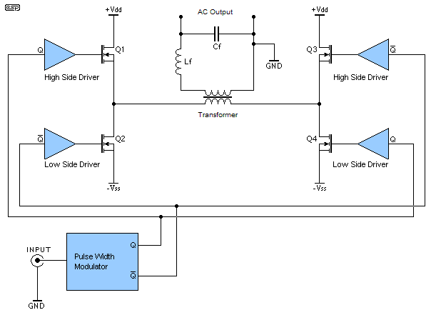

The answer to your question will depend on the switching frequency, current, output frequency and maximum and minimum duty cycle.
Here's a simplified schematic of a typical class D output stage in an inverter.
puresine-inverter-gif.12169

The thing you're calling a "Class D" inverter is simply a Single-Phase Full-Bridge inverter. Of course I know what a Full-Bridge is and how it works. thanks for the diagram, it helped me to learn the other name of Full-Bridge.
I don't want exact figures for a certain inverter and of course, I know it depends on these parameters, I want to know HOW it depends.
Yes a class-D aplifier is effectivly a full H-bridge inverter, but the same rules apply.
Both will need to reject the switching frequency
* for an audio Class-D anywhere from 100kHz and higher
* while a power inverter would have around 10khz [dependant on power level).
Both have a low-frequency cutoff
*in the case of the class-D it will be ~30khz to reject switching and other components polluting the audio
* the power one will have one to reject freq higher then the fundemental (say a cutoff around 100Hz).
Both have a output quality to meet
So it's not really wrong for someone to post what is done for an audio amp which only differs from the power counterpart by just specifics.
The exact same design requirement's for the output filter applies to both, just numbers are different.
With the 1/2*pi*sqrt(LC) equation you can find out the L*C value for the cutoff you want then its all about power really.
The filter could be made up of really high-L and really low-C, but then you just won't be able to get much current through the inductor.
Likewise a really low-L and a really high-C will effectlivly do the same thing but from a voltage P.O.V. good old reactance
truth be told simulation is the quickest solution to this. try some values, sim it and see how it responds to static and step-changes in load. where needed re-ballance the L and C.
Then have a look at the output voltage & current quality to see if it meets what you want.
one piece of advice I would suggest a 2-stage filter (if you plan to draw any significant current that is). The first is tuned to really reject the switching-frequency (the 2nd major frequency component in the output spectrum), then do the one for the power fundemental.
This way the power filter doesn't have to dissipate the HF associated with the switching freq, and thus stop the inductor-core from heating up un-nessasarily (plus you cna make that switching filter really tight at that freq)
