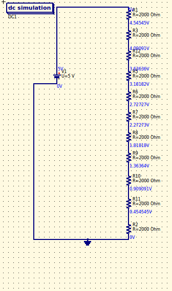

I was just showing the spread of voltage where is he getting the reading he got don't no.
This is with all 2 k

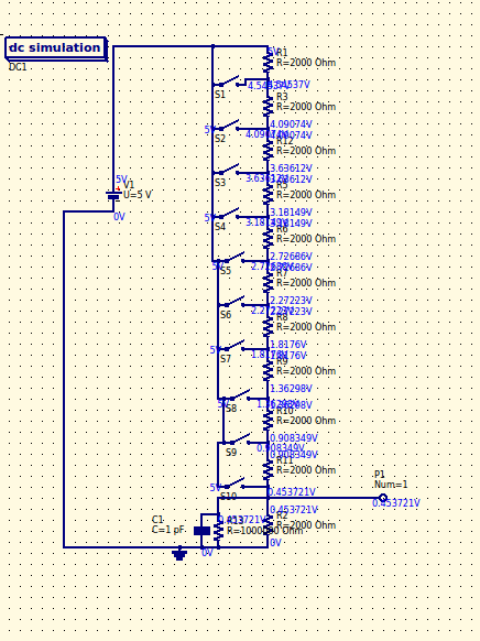

I entirely understand that Burt and I know you understand why a pullup or pulldown is needed to have a defined idle state. But MrDEB needs the details spelled out since the question has been asked before AND he peobably has said resistor in the wrong place.
Burt, your switches are shorting out a whole bunch of resistors. Move them so the taps get connected to the input with a large pulldown on the input. Post 126 works. However, so will post 1637 (page 90), probably.

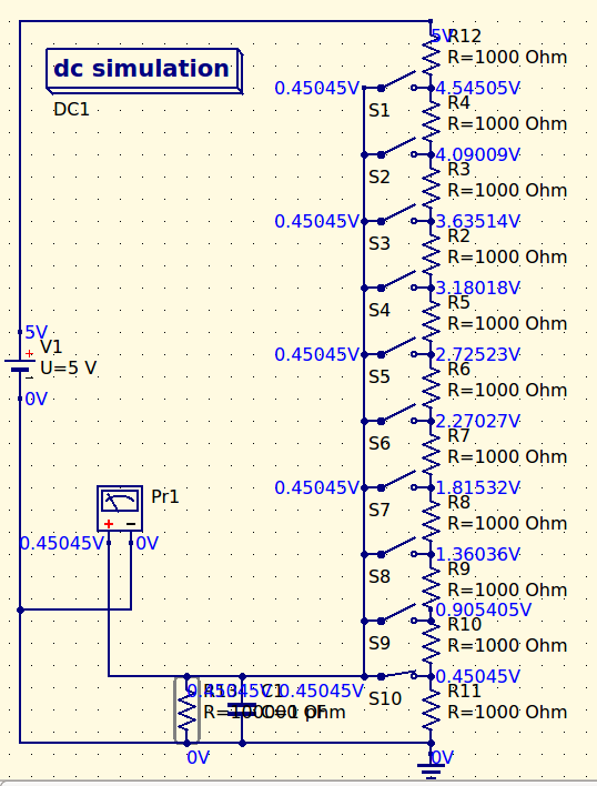

That just give 10 values it works too i can't see how he got 184, 256, 276,309,320,363,384,407,431,461
i was just playing with qucs
this is how i do it
i cant see how he got them crazy values.
I get a 400 plus mV between switches hes showing 50 mV and less
don't make sense to me.
And I don't let it go to 0 volts ground anything under 400 mV is error.
and using a Pic 16f1825 I couldn't press the buttons fast enough to not get the right readings
And I tried a arduino to they both worked out about the same.

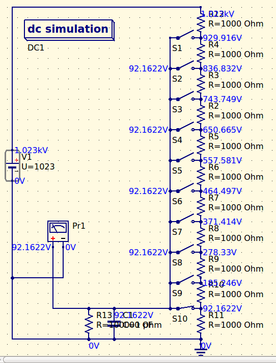

Also, if you want to use the simulation to find out what the ADC reading would be, just replace the 5V supply with 1023.
Could be easier than converting back and forth.

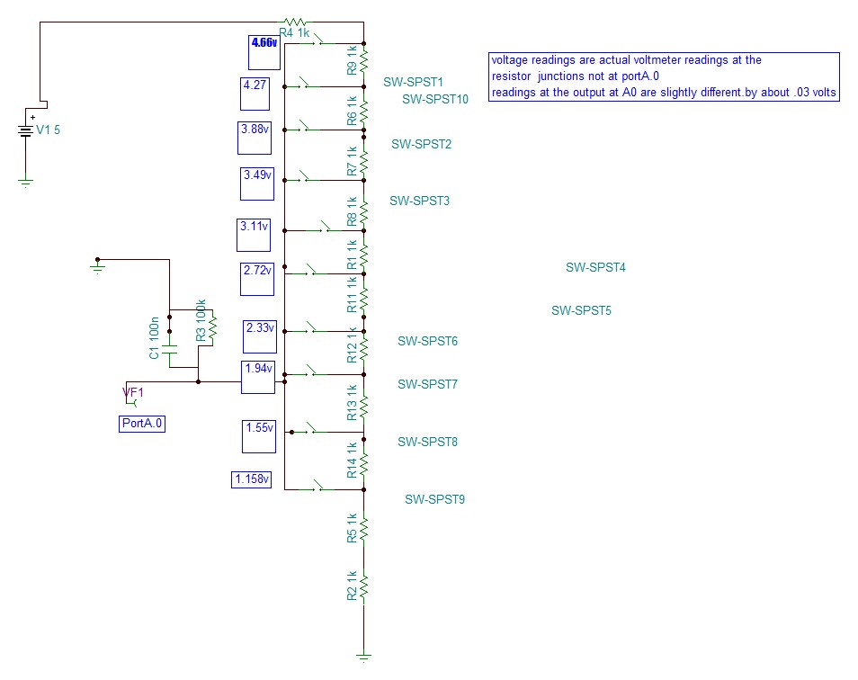

I have 12 resistors in series (2-1K to equal the 2K resistor. That leaves 10 resistor junctions between V+ and Ground
I measure 4.66v between V+ and ground (I have the Pickit2 powering the circuit)
the A0 input to ground = 99.8K
From ground end of ladder to V+ end = 11600K (remmber there are 12 resistors.
voltages starting from the first junction (after the 2K resistor) 1.72v
at the V+ end the junction measures 4.32 volts
Will draw out a diagram.

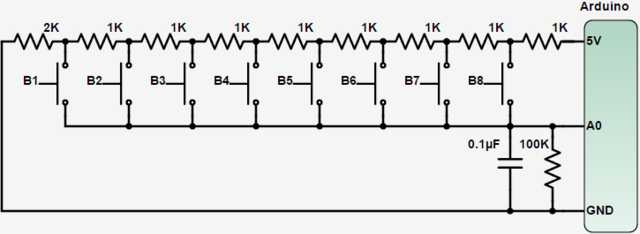

I have 12 resistors in series (2-1K to equal the 2K resistor)
I think most of the examples everyone is showing are using all 1K resistors, so get rid of the "2K" resistor and just use a single 1K in its place.
Then, try this code:

It uses the reading directly from the ADC chan 0 instead of converting it to volts.
If you look at the cases there's some wiggle room added to each one... that should take care of any adc inaccuracy/resistor tolerance.
The first limit for button 1 (case < 100) may be a little tight, so you could always increase that a bit to say 125, but there's probably enough slop in the others to work ok.
Why are people using 11/12 resistors. All that is required is 10 resistors and the calculation is switch = (ADCin+51)/102 - must be integer maths.
