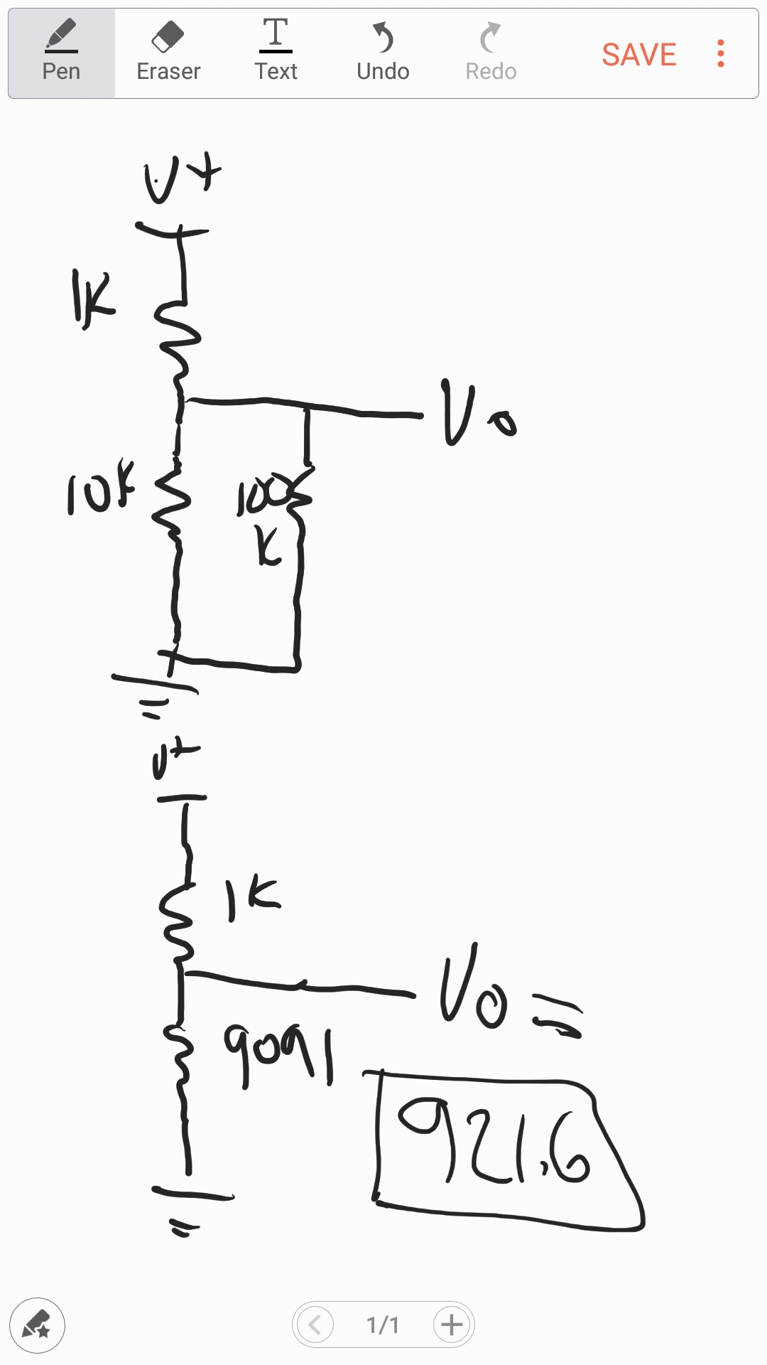

Interesting Bert. Your readings are all just a little lower than mine. I did not account for the 100k pulldown resistor, which would lower the reading somewhat.
Considering the top switch, the voltage divider would have 1k on the top and 10k in parallel with 100k = 9091 ohms on the bottom. Re-calculating the nominal value with pulldown resistor results on an expected value of 921.6 ohms. I'd say the math and your results agree!
Sorry I neglected to include the pulldown resistor in my calculations. I didn't think it would have that large of an effect.

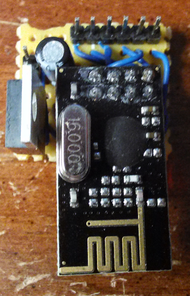

The nRF24L01 2.4G Wireless Transceiver Module i lost 4 of them
Add some of these and you could play wireless.

Jon what did you draw with I'm looking for a app like that.
Here are the calculated steps for the nominal resistance values including the 100k pulldown resistor which I originally neglected. Pretty close to Bert's measured values.

Calculating the bounds for each step based on resistor tolerance is a simple but tedious exercise. Perhaps MrDEB could learn something if he tried it.
Consider one step as an example. The top switch has a single nominal 1k resistor on the "top" of the voltage divider, and 10 1k resistors on the bottom in parallel with a 100k resistor.
The lower bound may be computed if the top resistor is 1% high while all the resistors on the bottom are 1% low. R1 = 1010 ohms. R2 = 10 × 990 ohms in parallel with 99k ohms = 9k ohms.
ADCout =1023 × 9000/(9000+ 1010) = 919 counts.
Reverse the high and low tolerances to find the upper bound, which equals 924 ADC counts.

Ahh, actually, it's a very big deal to understand "where the 10k eesistor came from". If you don't understand that, you are lost.
In this ladder there are a total of eleven 1k resistors connected in series from Vdd to ground. Consider what happens when the switch closest to Vdd is pressed. You have a voltage divider. A single 1k resistor on the top, and ten 1k resistors on the bottom (neglecting the pulldown resistor for now). Resistors in series add. 10 × 1k = 10k. If you look at a classic voltage divider picture, R1 on the top = 1k, R2 on the bottom = 10k when the first switch is pressed.
When the 2nd switch is pressed, the R1 of the voltage divider = 2 × 1k = 2k, and the R2 = 9 x 1k = 9k.
And so on and so on and so on.
But the situation is complicated a little. In our voltage divider R2 is paralleled by the 100k pulldown resistor. Look up how parallel resistors add.
