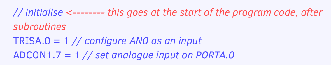

In his posted code, he has the command
SetAllDigital
which not surprisingly, sets all of the ADC inputs to digital I/O. I don't believe the ADC module does anything to override this because, as I explained previously, the Swordfish example file includes code to set up the analog input.
The Input(PortA.0] should take care of the Tris command, but without the next line, PortA.0 is a digital input because of the SetAllDigital command.

Well I think Jon may have hit on the solution (see post #215)
As for the FUNCTION I tried with and without the +1 *500/1023 and both work the same or that's what it appears.
