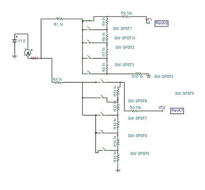

Finally got back to this project design.
Decided to use the ADC on portA.0 and A.1 for the 10 switches
Looking at using A.2 for the game selection option to free up an additional pin.
Here is a schematic for the resistor ladders. In simulation I have a voltage span of 4.17v to 2.5v. IMO plenty of range to distinguish between button depresses. Only one press at a time anyway.
One issue that may arise is taking the port input to a logic level different than 55uv. Have parts ordered to actually build the ladders using 1% resistors
