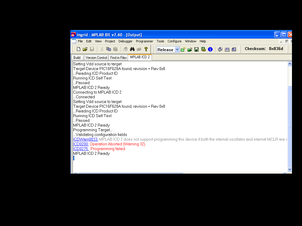

Thanks to William, my Inchworm now works. I am trying to program a 16F628A, but the error msg says "MPLAB ICD 2 does not support programming this device if both the internal oscillator and internal MCLR are selected." Operation Aborted (Warning 32).
Where and how do I make this adjustment to turn off one or the other in MPLAB? If that is what I am to do.

Change the config setting in your code. Change _MCLRE_OFF to _MCLRE_ON or _INTOSC_OSC_??CLKOUT to another setting.
If you have a hex value for your config then work it out yourself. Maybe someone here that thinks hex values for configs are a good idea can advise.
The ICD2 is not generally a VPP before VDD programmer, the Inchworm+ had a small PFET added to address this but it's a workaround. You have to toggle MPLABs target power control manually every time.
Just follow Pommies advice and add the _MCLRE_ON if you're using the internal OSC. You will lose MCLR as an input pin and have to use a small pullup resistor on it when in use. 22K is good.

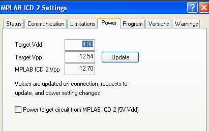

Programmer / Settings / Power
Uncheck "Power target circuit from ICD2" make sure the EXT5V jumper is open and your target (firefly) will shut off. You can then erase/reprogram a PIC with MCLR & INTOSC active.

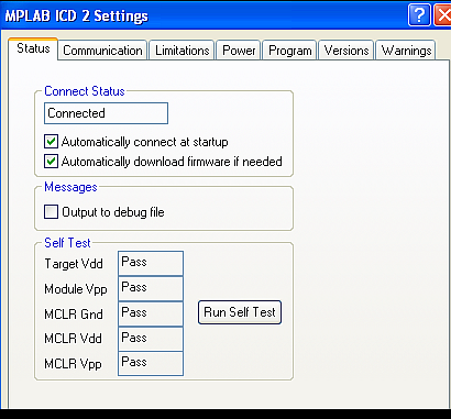

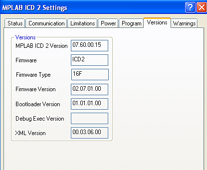

I'm getting a new error msg now. #32
The MPLAB is using a newer OS than that which was installed with this system's version of MPLAB IDE. This newer OS may not work correctly. We reconmend
And that was the end of the error msg. I looked in programmer - settings - error, but that was it of the msg. Looking on the Micrchip web site is daunting for me - I don't know what I'm doing, but I'm learning as I go.
I've re-installed the OS using your instructions, hoping that would fix the problem, but no go.
I thought that it would be easy to "burn a chip", now I know better. Any help with this?
I tried your wrk around with changing the settings but I'm guessing with this error nothing will work.
Charles

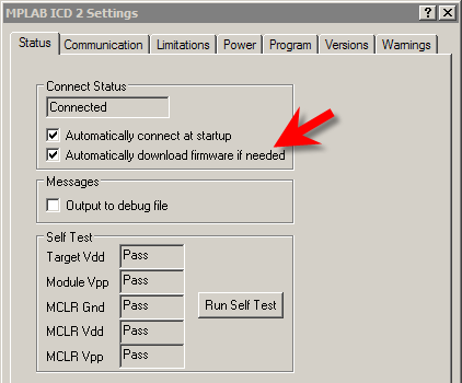

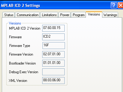

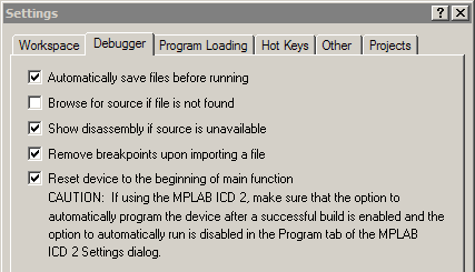

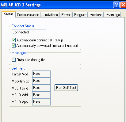

You should never have to download the OS after it's installed the first time. There is a setting somewhere to enable automatic OS download. I'm running the same firmware as you and MPLAB 7.60 (make sure you're running the latest MPLAB)
Here are some screen shots from MPLAB. Make sure your version is the same as one of the screenshots.
William

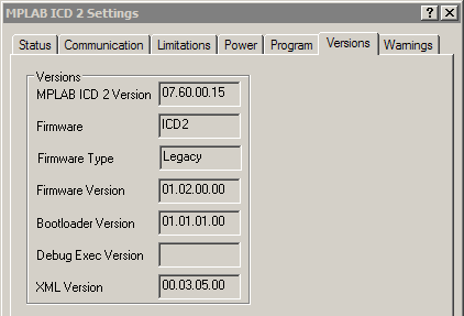

How do I change this now?

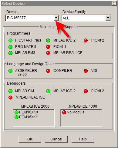

The bootloader versions are identical, the reason for the Legacy and 16F and the Firmware revision is normal as I had an different PIC selected on the config menu so a different OS will show. I'll try it with a 16F628 (not A I'm assuming)
Edit, figured it out.

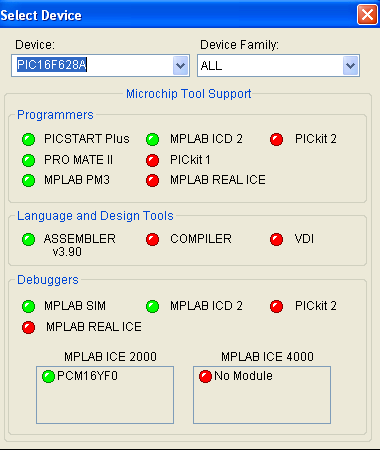

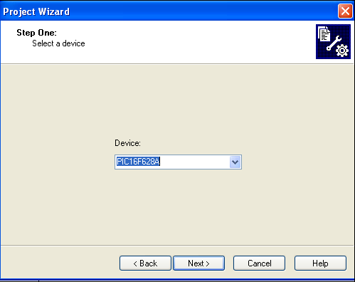

You need to from MPLAB choose the PIC you want to program / debug first (It will then automatically download the proper OS)
You have a 16F877 chosen, you need to select a 16F628
So from MPLAB
Configure / Select Device
And change it to the 16F628
William

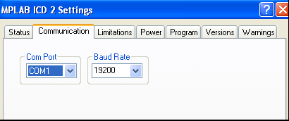

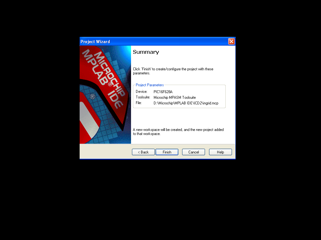

Here's some of the screen shots after each option. In configure/select device it's the 16F628A that I select.
The version does not change.
Again the code that I am using was not written by me and I can't change any of it or the device will not work correctly - as I did before (but it did program?)

Hmm what PIC is on the inchworm? A 16F877-20 or 16F877A.
This is the screen I need to see.
Connecting to MPLAB ICD 2
...Connected
ICDWarn0030: MPLAB ICD2 is about to download a new operating system. If MPLAB IDE is just starting, it will appear to "hang" at the splash screen. Please be patient. MPLAB IDE will finish it's intialization after the OS is downloaded. (Note: You may wish to select to ignore this warning in the future.)
Downloading Operating System
...Connected
Setting Vdd source to target
Target Device PIC16F88 found, revision = b1
...Reading ICD Product ID
Running ICD Self Test
...Passed
...Download Operating System Succeeded
...Passed
MPLAB ICD 2 Ready
