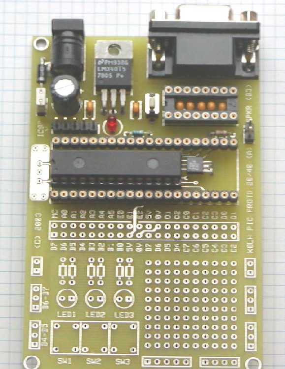

The first general purpose PIC proto' board I designed (2003) had a 28 pin footprint within a 40 pin footprint which allowed me to use either type of chip on the same board. I wish I had had the foresight to install 10 pin dual row connectors for each port (great idea)...
proto-28-40-board-jpg.19671

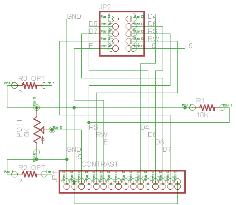

I made a few LCD adaptor boards. It allows you to connect a 1x14/16 LCD to a standard 2x5 port in the 4 bit mode. No need to dedicate pins to the LCD if it is only used during debug.
lcd2x5-png.19672
lcd2x5sch-png.19673
It is single sided. The red line above R1 is a jumper.
I can post pdf's of the foil or the eagle files if anyone wants them. Not a difficult board to layout.
EDIT: R2_OPT and R3_OPT can be used in place of the 5K pot.
3v0,
Hook the LCD backlight Anode to VCC and put the backlight Cathode on the unused connector pin where I can drive it with a sinking PWM signal and that adapter would be perfect...
I have a similar manufactured adapter but they hard-wired the backlight to power pins (with appropriate dropping resistor) and the R/W pin to ground. It's got two unused pins on the 2x5 connector but I can't cut the backlight and R/W connections because they're buried. Bummer!
Mike

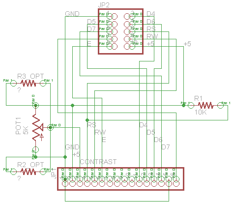

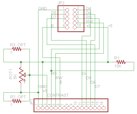

Changed as requested. Also made the board a bit easier to etch and solder. The pdf fils is a foil pattern that can be printed and etched. The zip file contains the Eagle sch and brd files.
1b_sch-png.19676
1b_brd-png.19677
3v0,
Very nice. "Perfect" does indeed apply. I'll take two (grin).
I meant to edit my post to say it would be nice to have the backlight cathode available on the connector so that I could drive it with PWM or ground it but I couldn't edit my post.
btw, I wouldn't be opposed to a installing a couple jumpers if those small traces between pads is a problem...
Mike

Are you saying you want the anode hard wired to +5 and the cathod to the connector pin. As in I have is bas awakards? If you think I still do not understand mark up the schematic using a paint program.
The lines between traces should not be a problem with a decent setup. The thin lines here are .012 and I have used .001. The .012 is quite dependable but the .001 traces need to be verfied after etching. Most of the time they are good.

Yes, backlight anode to VCC and cathode to the connector. Sorry I didn't notice it in your first updated drawing.
Mike
