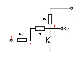

Impedance for a BJT stage, with collector-base feedback resistor

Hi, I use Shekel's method to find this "real" Rout.
The Shekel's method is described here by Electrician
https://forum.allaboutcircuits.com/showthread.php?p=165051#post165051
The circuit diagram that I use

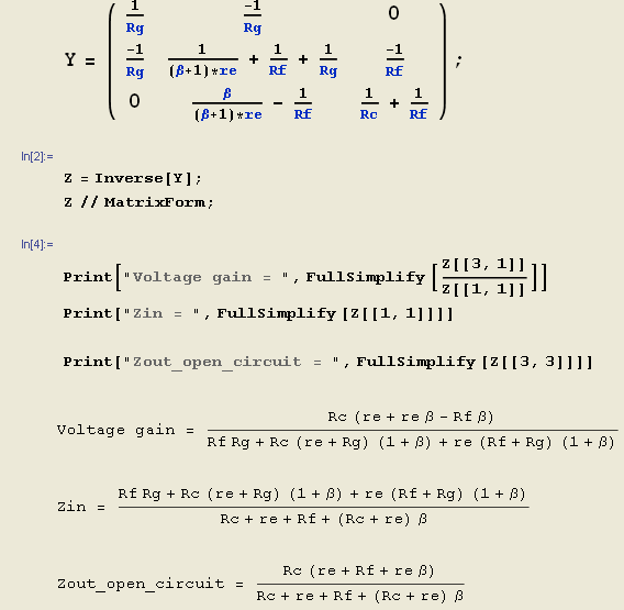

The Y matrix and the Voltage gain ; Zin and Zout_open_circuit
13-png.61273
Zoc = (Rc (re+Rf+re β))/(Rc+re+Rf+(Rc+re) β)

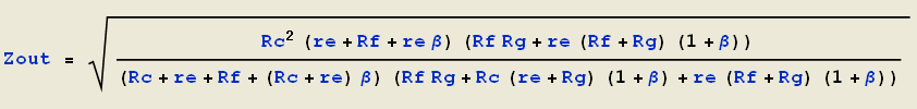

I also find Zout_short_circuit
14-png.61274
And Rout_Image = √( Zsc * Zoc)
15-png.61275
Rout_Image = 307.4855304
For
Rf = 47000; Rc = 4700; Rg = 10000; hie = 4000; Hfe = β = 180; and re = hie/(hfe +1)
I am sure that we can use this method also to find Zin_ Image.
I hop that Electrician tell me how to do it.
I add Mathematica 7 file
