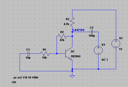

The simulation show that Rout = 280R
And I think that the main problem with Rout = 1020 ohm is the Hie value that Ratch assume.
Hie = 10K ?? ----> re = 10K/101 ≈ 100Ω---> Ic = 26mV/100Ω = 260μA ??
If I assume Hie = 2.2K (Ic = 2.28mA hfe= 200) and then use Ratch equation to find Rout
Ro = (Rg*Rf + Rf*Hie + Rg*Hie)/(Hie + Rg + Rg*Hfe) = 295.89504Ω
Rout = Ro||Rc = 277

Hi Jony,
How did you determine that Rout was 280 ohms?
I build this circuit in LTspice And I use AC sweep to find Rout vs frequency
And Rout vs frequency
11-png.61077
I change the BJT to 2N3904 and for F = 1KHz Rout = 210.718Ω
Also, how did you measure an hie value of 2.2k ?
I used this equation to find Hie
Hie ≈ re * (β +1) ≈ 26mV/Ic*(β +1)
Of course to find Hie I can also use the LTspice (Hie = 3.378KΩ).
Or we can use the this datasheet
https://www.electro-tech-online.com/custompdfs/2012/02/2N3904.pdf (page 5)
And when I use the simulation data for Hie and Hfe and use Ratch equation to find Rout
Rg = 10K; RF = 47K; Hie = 3.38K Rc = 4.7K; Hfe = 300;
Rout = Rc || (Rg*Rf + Rf*Hie + Rg*Hie)/(Hie + Rg + Rg*Hfe) = 4.7KΩ||219.9Ω = 210Ω

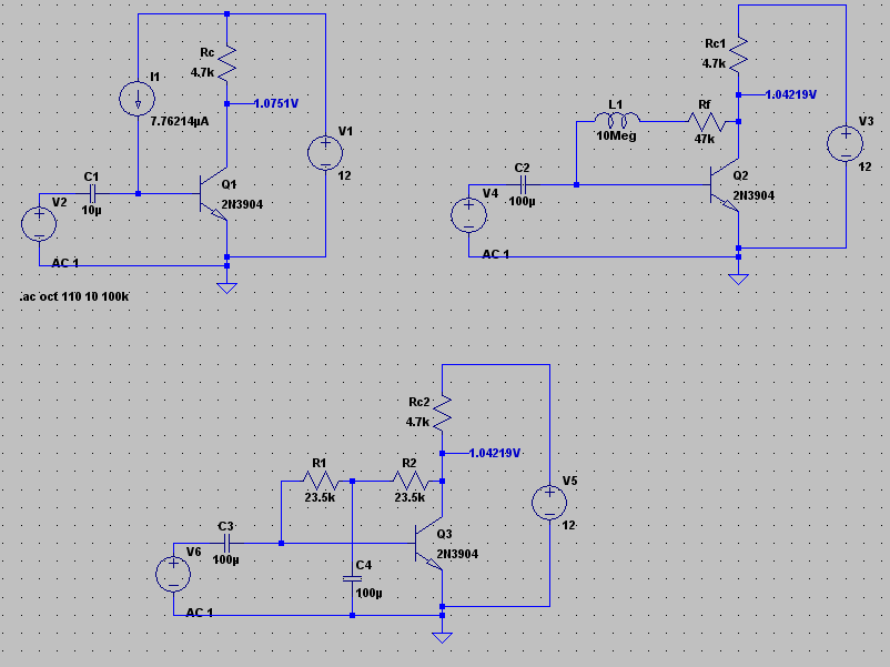

Also, what technique do you use to measure hie in a given circuit like we are looking at with the original transistor circuit?
Here you have the three technique that came to my mind to measure hie in this circuit
I used the first method (current source and AC analysis).
And I'm also in the team that thinks that Rc is a part of a amplifier not a load.
That is why I includes Rc in my Rout calculations.
  • Draft29b.asc

Hi Jony,
(see post just before this one)
Wow, where did you get a beta of 300 from? That's a pretty nice transistor there :)
Typically we were expecting an Rout of 300 to 400 ohms. The formula i had posted earlier in this thread was:
Rout=(R3*R2)/(R2+R3*B+R3)
and in terms of the new variables we had been using this comes out to:
Rout=(Rc*Rf)/(Rf+Rc*hfe+Rc)
Looking on the data sheet you linked to, i see at 1ma hfe=120, so using that:
so with Rc=4.7k, Rf=47k, hfe=120 we get:
Rout=358.8
This is close to what i measured in the circuit simulator.
Using these same parameters and hie=3600 and hfe=120 from the data sheet, i use:
RT=(Rf*Rf+Rf*hie+Rg*hie)/(hie+Rg+Rg*hfe)
and get:
1989 ohms.
This fairly high value was typical of what i was seeing and that's one of the reasons i brought up some questions about the formula for "RT".
Granted the formula i posted isnt perfect either, but it doesnt require measuring hie so it's a little easier to use too.
BTW, you dont need to do a frequency sweep as we would be happy with values at 1kHz only, no problem, since we are considering output resistance here rather than the more typical impedance which would be frequency dependent.
You should also be using an AC current source on the output not a voltage source, even though you are measuring the current.

What we need to do is set this up in spice like Jony did and MEASURE hie.
All we have to do is agree on a value of h[ie]. I am just calculating the output impedance, not measuring h[ie]
Just as a reminder, the output impedance is NOT the impedance with the load resistor RL connected (and RL is not Rc, Rc is the collector resistor which goes to Vcc).
Certainly that is true. The General Immittance Theorem ignores the value of what is designated the load impedance.

BTW, the way i came up with the output impedance was using the standard output perturbation method. One of the simplest ways is to just use a current source on the output and calculate the voltage deviation and the current deviation and then take:
Rout=dV/dI
which of course is very straight forward.
If you want to do a simpler example using GIT that you mentioned, that would be nice i guess. We can do a simple voltage divider with R1 on top and R2 on bottom fed by a voltage source Vs:
Vs o---R1---+---R2---o GND
where we take the output from the junction of R1 and R2. We want to calculate the input resistance and the output resistance (call it impedance if you like). This should be simple but lets see how it goes :)
Before we depart from the transistor circuit however i think we should clear up the equations a little. Make them into explicit equations for Rin and Rout.
Also, a non linear analysis using some Spice data would be very nice too, to back up the linear method.
