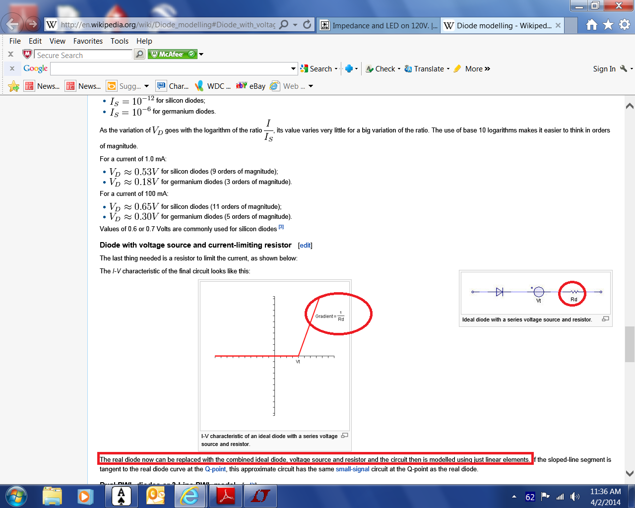

What do you mean by PhD diodes, idealized diodes? Something that takes into consideration the bulk resistance? Rd is not mentioned in the link, but they do have a circuit with an idealized diode with a source voltage and a resistance they call "R". They show several methods of calculating that current. I used a source voltage of 340 volts and calculated the Vf at R=0 to be 1.53 volts and at R=100 Vf is 1.35 volts. Those figures appear reasonable, don't they? Vf doesn't change much either.

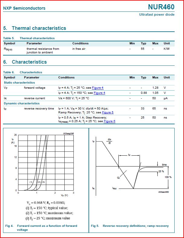

Have a look at this. Read far enough to see the curves defining the parts that make up Vf. You will find that by adding Rd you get the slope I defined earlier which will limit the current and increase the time constant. Also matches the spice models.
I think you are referring to piecewise linear models. I don't think you have enough segments in your model to be viable at those high currents. I would use a graphical method instead. Don't forget that the transient pulse period is very, very small.
https://en.wikipedia.org/wiki/Diode..._voltage_source_and_current-limiting_resistor[/quote]
Ratch
It is called Rd. See attached.

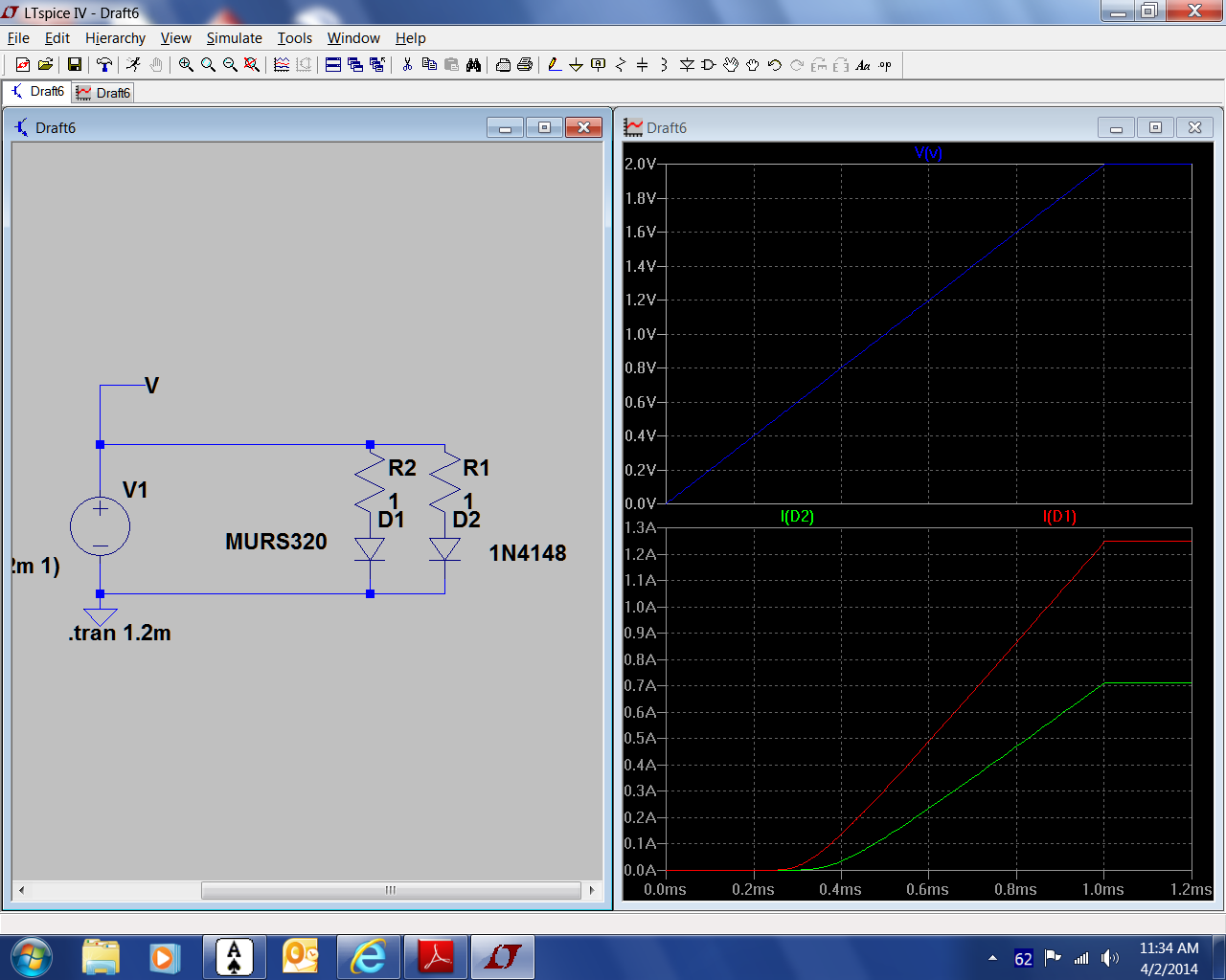

Also see a simulation of 2 diodes. One with a higher current rating than the other. You can see the difference that Rd makes in the slope of the curves.
Two different diodes, two different curves. Schlockey's diode equation allows for two input parameters: one is "n", and the other is the reverse bias current. You can't expect to extrapolate the whole curve with just two straight lines, especially at the higher currents.
Why don't you do a run with the values I used. R=0.1 ohms, step source voltage = 340 volts, and C = 1 uf in series and pre-energized to 170 volts with polarity to aid the source voltage. Graph the voltage across the diode and the current. That willl be a good test of Spice.
That's what post 14 was, except with 170 volts. You won't like it any more now than you did then.

You didn't comment on post 82 about adding Rd (diode resistance) to make the model complete. (Don't you just hate variables?):)
So using your math model add .53 ohms to the large diode in my simulation, in post 82, and 1.8 ohms to the small diode and see if the curves don't come very close. Without Rd the curves go almost straight up (as you have pointed out) after a small current flows. If you like that, add 17.5 ohms to the little LED and see if it doesn't match. Pretty cool.

The Rd is inside the diode not outside of it. Vf is measured across the diode. So higher Rd - higher Vf. - higher current higher Vf.
Evidently there is not enough bulk resistance in a junction diode to make any difference. The power diode in post #88 can output 20 amps continuous with a Vf of just over 1.5 volts.
