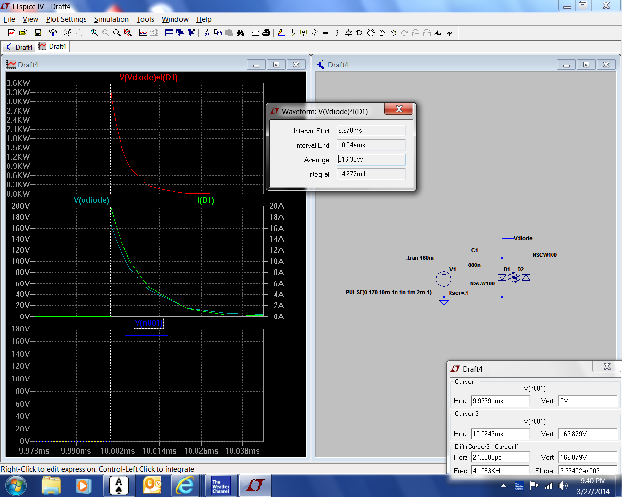

I don't think you have to have a resistor or worry too much about the inrush of current. Here is why. Let's assume that the voltage is 120 volts at 60 Hz, the capacitor is 1 uF and the total resistance of the everything is 0.1 ohms. Furthermore, let us assume that the cap is energized backwards so that it aids the voltage which turns on at the worse possible time in its sinusoidal cycle. What do we have?
We have a voltage of sqrt(2)*120 volts peak. Double that for the voltage from the cap gives 2*sqrt(2)*120 volts peak. Dividing by the resistance gives (2*sqrt(2)*120)/0.1 = 3394 amps peak into the diode. Ouch!
But look at the time constant, RC = 0.1 usec. How much energy will be dissipated in the diode for, say 5 time constants, after which the inrush will be finished? Since the period of the sine wave is about 17 msec, and 5 time constants of the inrush current is 0.5 usec, we can assume the sinusoid will not change much during that time. Anyway, it turns out that the diode accepts 11 nanojoules of energy during that short period of time. Any worries?
Ratch
I think the diode response to the high current messes up your calculation. I never tried to calculate it. Just knew a current limit was needed. Anyway here is a simulation of it. 14 mj.
First of all, I found an arithmetical error in my calculation, and I now get a value of 60 millijoules instead of 11 nanojoules. The diode will not heat up much from that little energy. From looking at your curves, it appears that your time constant is much larger that what I used. I can show you my calculations if you wish.

I don't think the calculations would be to meaningful since most LEDs aren't spec'd there anyway.
The time constant is longer than yours because of the led Vf response to the high current. It is not like a standard diode where the drops stays pretty constant.
Anyway here is an led from Osrom with pulse curves.
https://www.osram-os.com/Graphics/XPic9/00115417_0.pdf/LR T68F - TOPLED.pdf
Pretty conservative, but.
I just ran my calculations from 0.1,1.0,10.0,100.0 and 1000 ohms. They all came out to about 60 mjoules. It appears that increasing the resistance raises the time constant, but it also lowers the inrush of current which keeps the energy of the transient at a constant level. I assumed in my calculations that the resistance would be constant for such a short time period, but I have no way of knowing its true resistance level or variation. Interesting exercise.
Ratch
With 1000 ohms the RC contant might be big enough for the voltage to drop away from the peak before the capacitor gets fully charged :)
