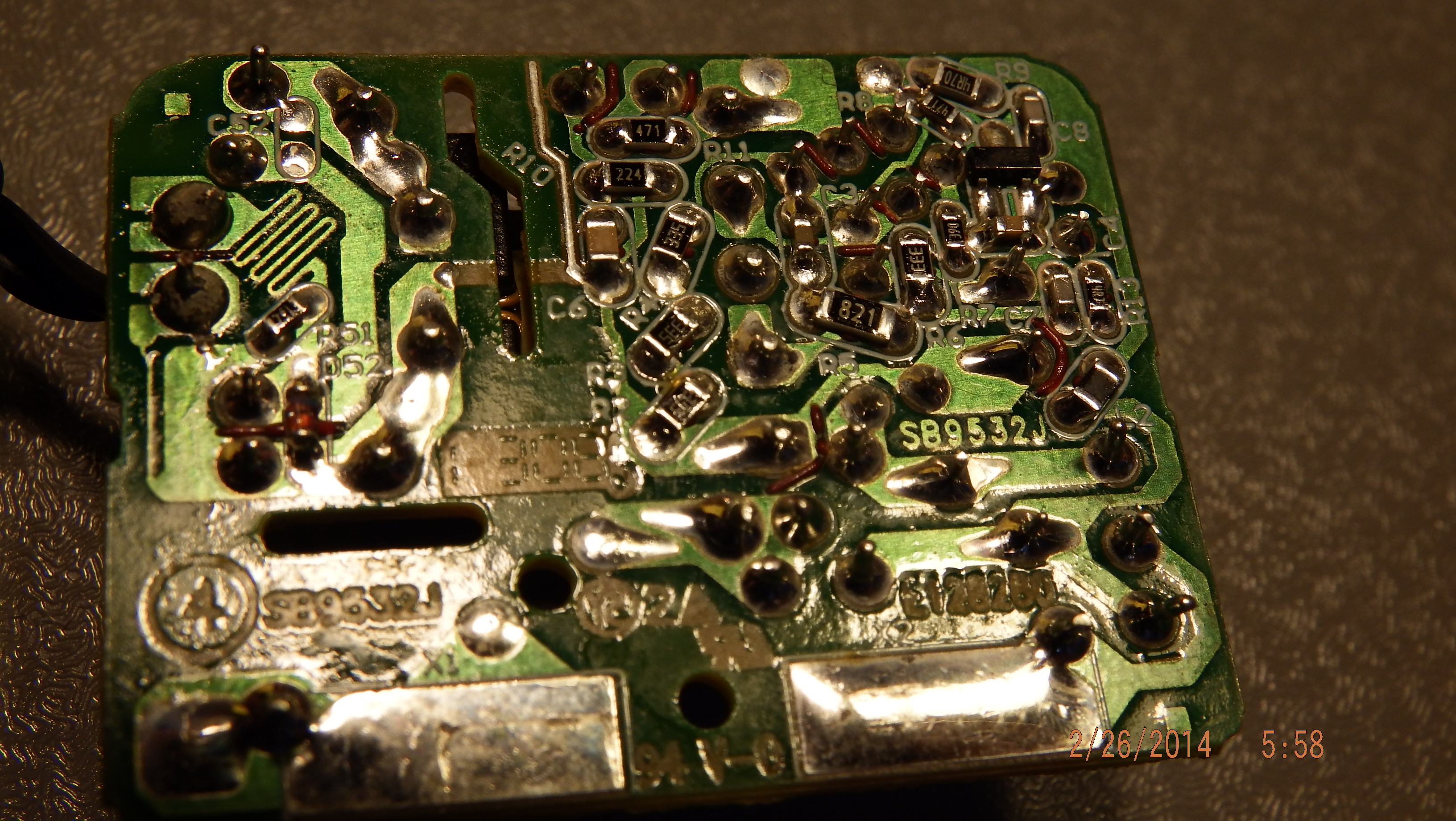

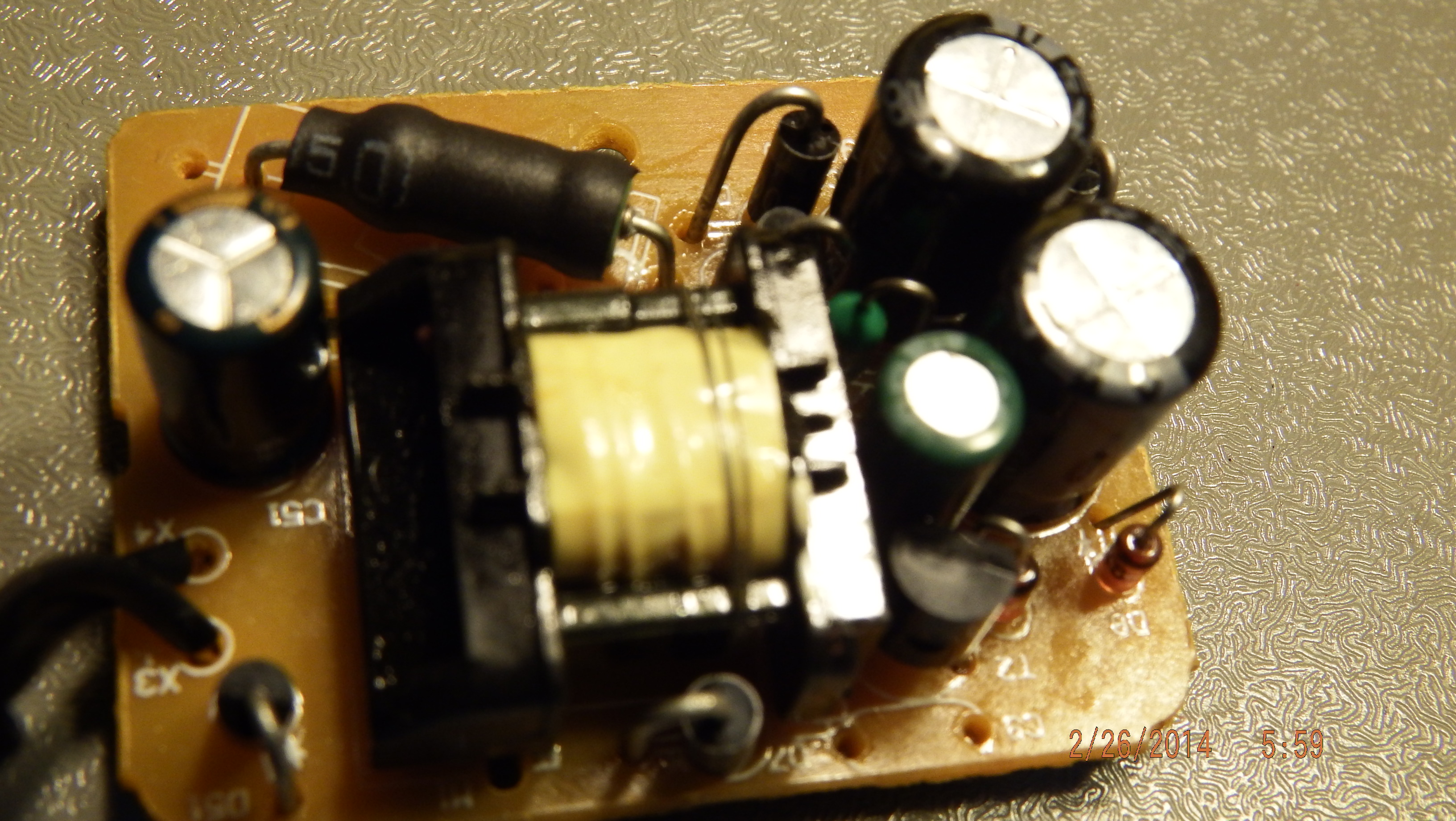

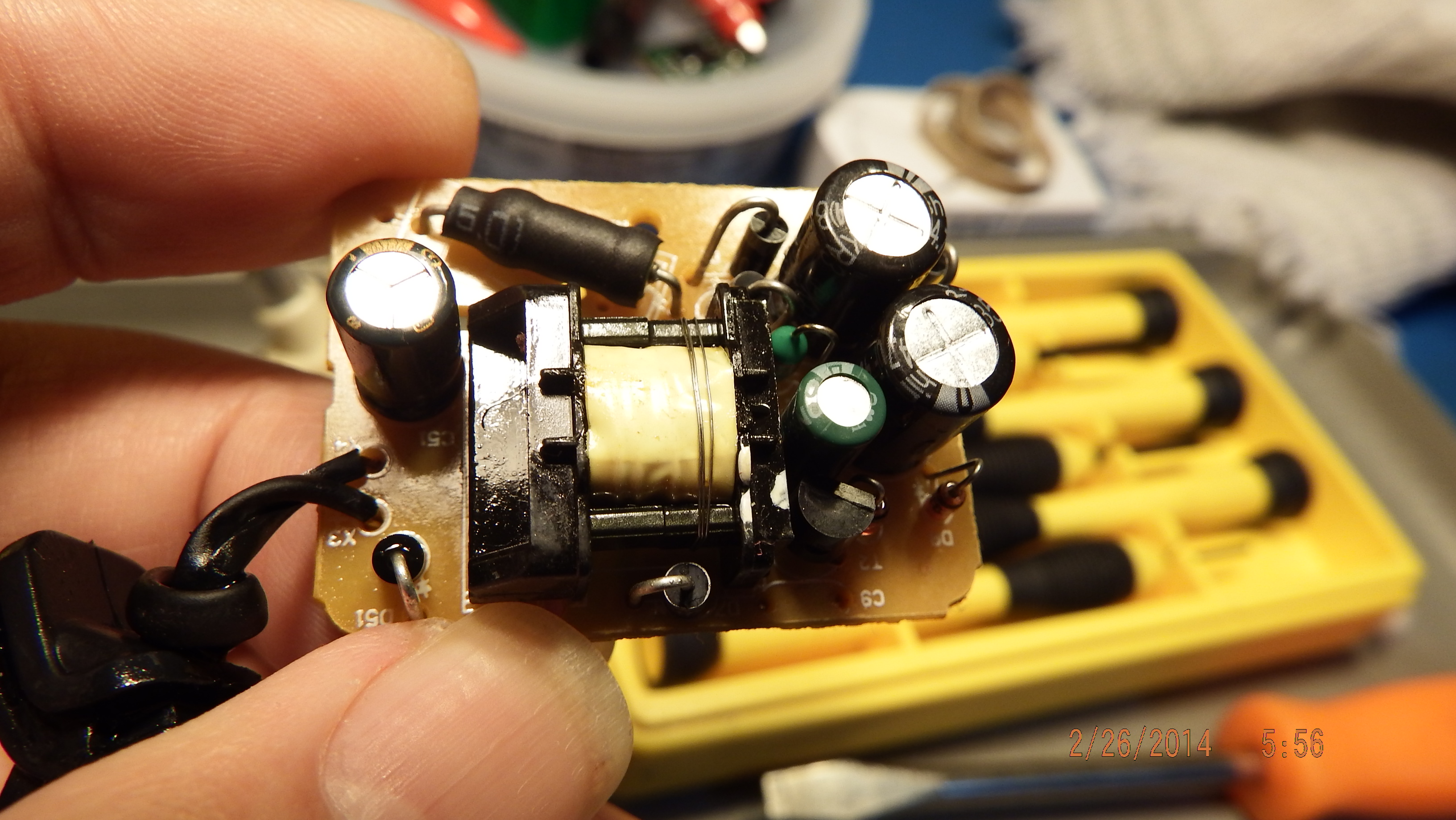

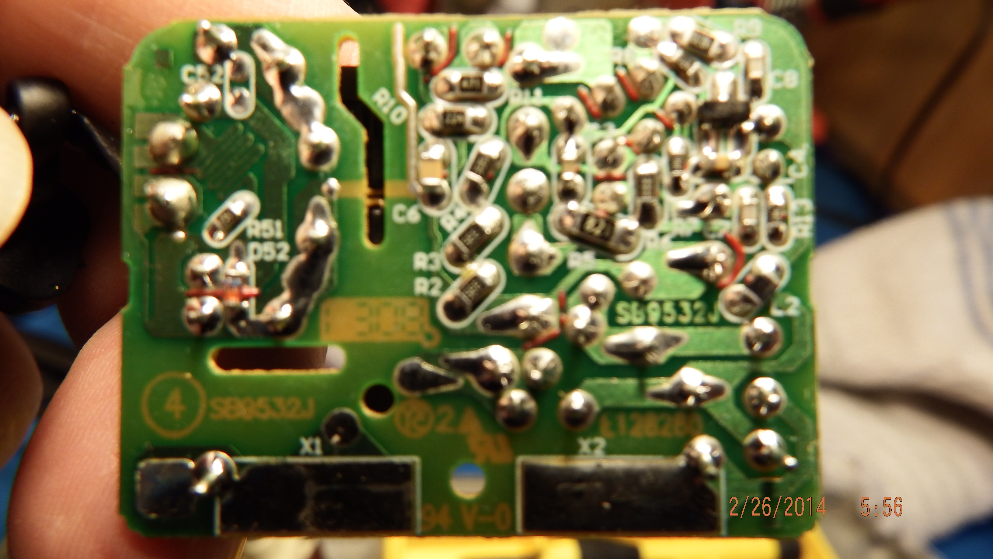

DSCF0124.JPG DSCF0125.JPG DSCF0126.JPG DSCF0127.JPG ]
No, I didn't check them out. I assumed they're transormerless, which is a bad thing to do.
You're probably right. Most of them have enough room for a small high frequency isolating transformer. But some of them are so small, they don't seem to have enough space even for a capacitor.
After something breaks, I usually open it up to see how it works. So, I have pretty good idea how cofeemakers and toasters are built. But none of these little power supplies broke on me yet :(
Sometimes I will open up a good wall-wart for the fun of it. The last one was a Motorola phone charger. I must say that the quality of the PCB and components are very good. I was impressed.
I use some gas or brake fluid to weaken the glue for about 15 - 30 minutes to help open them easier.
We need a fabrication specialist to tell us if that kind of current will damage a diode.
That's why I would use a 10 to 50 Ohm resistor if I had to build it right now. It only costs a cent, if not less.
