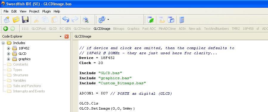

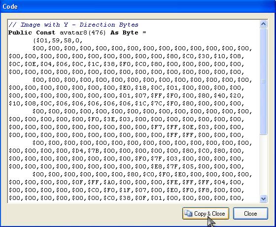

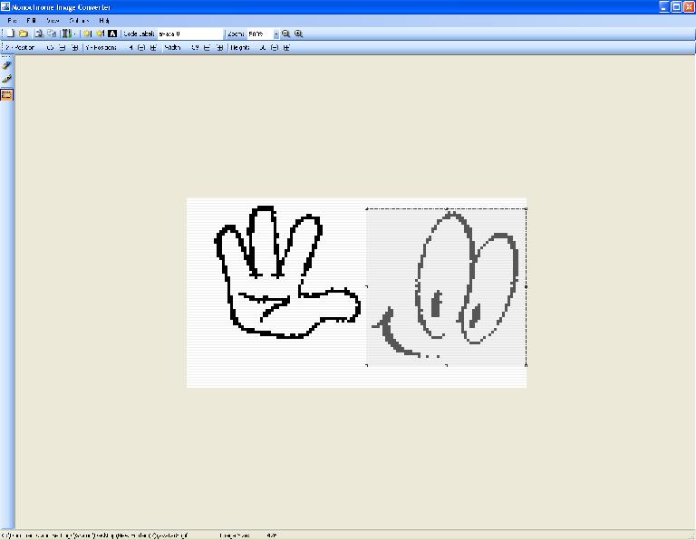

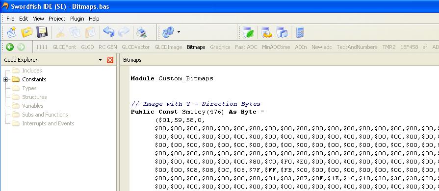

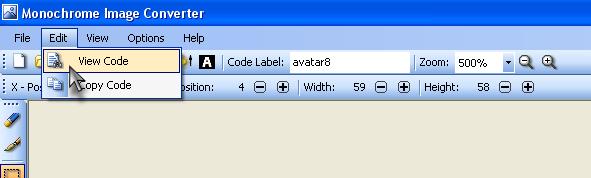

It depends on the picture as to how much data it will hold. If you’re using a 128 * 64 pixel image (this is just an example for GLCD's), image size can be up to 128 * 64 = 8192 bytes. Why? Well that’s because it needs to know whether to put a 'dot' or not on every co-ord.
If your using Swordfish, displaying images is pie on GLCD's, maybe this would help you, I'm not sure?
Use the free download Monochrome Image Converter and then crop the image that you want, it will create the code, and presto - graphic images
