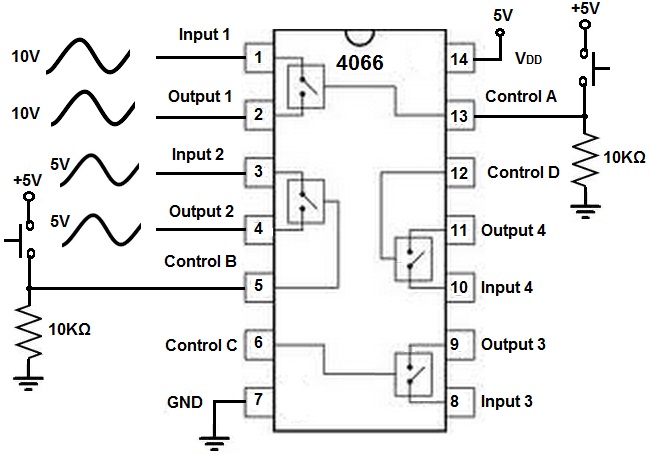

DF If you want to switch 3x64 to 64 independent analogue audio signals then cmos bilateral switches will do the job,( a lot) If you want to switch same numbers MiDi ( cannot think why ) that is a different ball game...
There are much better analog multiplexors than the antique 4066. Mainly lower on-resistance, but you can also get more switches per package. If he needs many inputs to 1 outputs then a 16:1 mux is easy to get, like the Analog Devices AD7502 for example. To be honest I was not clear on what kind of switch configuration the OP needs, ie. many to 1 or 1 to many, or as Can mentioned cross point.
