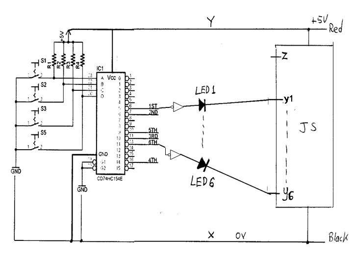

Like this: ?
notice common of now named switches y1-y6 (S1-S6 were confusing me as they share the same name as S1,S2,S3,S5 to the left of my diagram) is not connected to anything anymore, its just as it was on the USB joystick board from the factory, and does not share continuity with my 0V GND wire.
Is that correct now? I want to be sure, before I do something wrong and blow something up ;)

Ok, plugged in and put on the joystick test utility again, now it seems a bit better, when powered up, none of the joystick buttons are on... But selecting any combination of S1,S2,S3,S5, will also not yield any change.
Point of interest: If I just touch wire 'z' to wire 'x' (this was a last resort test), all six of the buttons y1-y6 become active.
One thing I dont understand about this circuit is that wire 'x' and wire 'z' are not common, so how can it complete the circuit ever, unless I wire them together (which makes all six permanently on)
Getting 5V between y1-y6 and X when all of switches S1,S2,S3,S5 are open
Getting 1v between y1-y6 and Z when all of switches S1,S2,S3,S5 are open
I get the same 5v when I try activate y1, this is on wire X
I get .5v when I try activate y1 (so it drops .5v), this is on wire Z

Tested the inputs, they work perfectly, chip is wired fine aswell.
The outputs: Seem to be great aswell, I get a mutually exclusive Low output for each corresponding gear. ie (y1 is high 5v+ in all possible gear combinations including neutral, except for 1st gear.) This is using wire y as the anode on the multimeter.
This seems like a good thing, the circuit seems to work perfectly, except its not activating the gears on the joystick.
Im am so sure that it has something to do with the fact that wire 'Z' on my latest diagram does not have continuity at all with 0V gnd, whereas that is the common opposite terminal for all the joystick buttons y1-y6.

Ok tested now,
I just measured across Main black wire on joystick 0v GND, and wire Z (which is the common ground for the y switchs), and I get +4.5v... so I take it its an active high circuit and I will need to add the inverter IC?
I understand how the circuit works, how we are introducing voltage to each of the y1-y6 terminals, but what I'm saying is the joystick circuit has this ability already, take a look at my drawing below, the joystick had 6 little rubber buttons which go over terminals y1-y6, obviously I've ripped the casing apart and the little red rubber buttons are not there anymore, but if the joystick is plugged in and I just jump the terminals between y1 and the common track, y1 activates... Thats why I was confused about the way we've done it now, I just thought the solution was going to be a far simpler one... I am glad its not because I've learned a lot from this experiment.

that sounds correct. a 74HC04 is a great solution but just about any hex inverter (no that's not a Wiccan thing) will do the trick, though.
Ok, I'm about to retreat to the garage to solder on my new CD74HCT04E on the stripboard. Will return with the results within then next 1 hr.
DAMNIT!!! still not working. Seems all y1-y6 buttons are on as soon as I plug the circuit in.
I tested some things though:
If i put the meter between pin Vcc and Pin GND of the 74hc154e when the GND of the entire circuit is connected to wire y1-y6 common (see joystick diagram above), I get +2.5v in NEUTRAL. If I ground the entire circuit to the 0v GND input from the USB, I get a +5v.
Done some testing from the beginning of the circuit, it seems there were a few errors on the logic inputs/outputs of the '154.
I tested Low/High's when in each individual gear:

3 days ago, I had a feeling that you were missing something. I had intended to ask you to do some measurements to resolve this, but you seemed happy yesterday.
What I suggest you do is:-
1. disconnect the new circuit from the Joystick
2. connect the negative probe of the meter to x (ie. on the 0 Volt line)
3. Measure the voltage at y, it should be +5 Volt based on your previous statements, but I want to be sure.
4. measure the voltage on Z.
5. short y1 and note the voltage on Z. Is there any change?
5. measure the voltage on y1.
6. short y1 and note the voltage on y1. It should be about +5V.
Write a table of these results of steps 4 ~ 6 so we can see them clearly, ie.

this sounds like your joystick controller uses active low. the clue is that it selects 5 or 6 buttons. I suspect you got something the wrong way around on your labeling of the joystick circuits.
Voltage is +5.11V (Y here is the main Red +V supply line, not to be confused with the y1-y6 inputs)
Voltage here is +3.87V
Negative probe of meter is still on X, positive probe is on Z.
y1 shorted to X... before short: 3.88v, after short 3.36v (Is this how you meant for me to test this step? I'm not too clear on the details).
Negative probe of meter is still on X, positive probe is on y1.
When y1 is not shorted = 0v
When y1 shorted, voltage goes to +3.5v

There is no need to do the table. I have extracted the info I need.
Re your question about point 5, I quote:-
Yes. I assume by "after short" you mean that the voltage was measured with the short on. So "during short" would be more accurate.
It looks to me that the IC in the JS is operating from a 3.9 Volt supply. That's why y1 goes to 3.5 V when the s/c is applied. Note there is some small inconsistency since Z falls to 3.36 V when the s/c is on but you said that y1 is 3.5 V. They should be equal. But this is not important. If you wish, you could check this by moving the probe from Z to y1 while the s/c is on.
I conclude that the inputs are active high.
So I don't know why there are 5 or 6 ones on the screen when you connect the circuit.
I suspect that the 5 Volt from the inverter is affecting the JS in some way thus causing it to show strange results. As Philba said, you would think the JS inputs were AL.
So I suggest that you use PNP transistors to switch the y signals.
Do you have any PNP transistors in your junk box? Virtually any small signal transistor will do.
So if you don't have 6 in the junk box, buy some such as the
PN200, BC327, BC328, BC556, BC557, BC558, BC559, 2N3906, or similar.
You won't need the inverter.
I'll post a circuit later.
before you wire up transistors, try running the 154 from the joystick power. it should work down to a Vcc of 2V.
Yes, Try Philba's suggestion, but I don't know how much current the Z output will source. Note that you may need to connect the common end of R1 ~ 4 to Z also. But try them connected to +5V first.
I need you to do one more test. Set your multimeter to measure current and connect it between Z and y1 (+ probe to Z), measure the current. I expect it will be less than 10 mA and possibly much smaller.
I have attached 2 options for you to consider if Philba's suggestion does not work.
Red LEDS should suffice. The point of the LEDs is to offset the voltage since they have a voltage drop of 1.7 ~ 2 V. The LEDs may not glow but that does not matter.
I did not check the output connections, but you know which ones to use.
I just did a cut and paste on your drawing.
EDIT. Another possibility just occured to me. Use Philba's suggestion, but power the 74HC154 (and the resistors) from the +5V and the 74HC04 inverter IC from Z. The input protection of the 74HC04 should prevent the Z line being pulled towards +5V.
YES! It works!... Well, 80% working....
Gears 1,2,3,4 work perfectly
Gears 5,6 seems to activate all 6 y1-y6 buttons, not sure why.
In order to get it to this stage, I did what Len said at the 'EDIT' of your post, connected the '154 and resistors to +5v, and the hex chip Vcc to Z. But one major thing to note. I disconnected the wire which commons the ground of the new circuit to the ground 0v of the joystick, if thats connected nothings works at all, all y1-y6 are off. So how on earth is this new circuit getting power??? If the new circuit ground is not connected to the ground of the power source??
Any ideas on gears 5/6?
EDIT: Ok, I've tested the '154 inputs in each gear.
Negative probe on on isolated new circuit ground. And Positive probe on the entry side of each resistor. It seems the highs are 1.8v, and the lows are 0v. This is true for each gear, except 5,6, where the highs are 0.8 volts and the lows 0v. I suspect that 0.8v is not high enough to register a High on the '154, thus all four inputs are low, which yields a combination of many results. Should I change the value of the resistors to a lower Ohm value?
Thanks again for all your guys help, and thanks for the drawings Len, hopefully we dont have to use them though.
