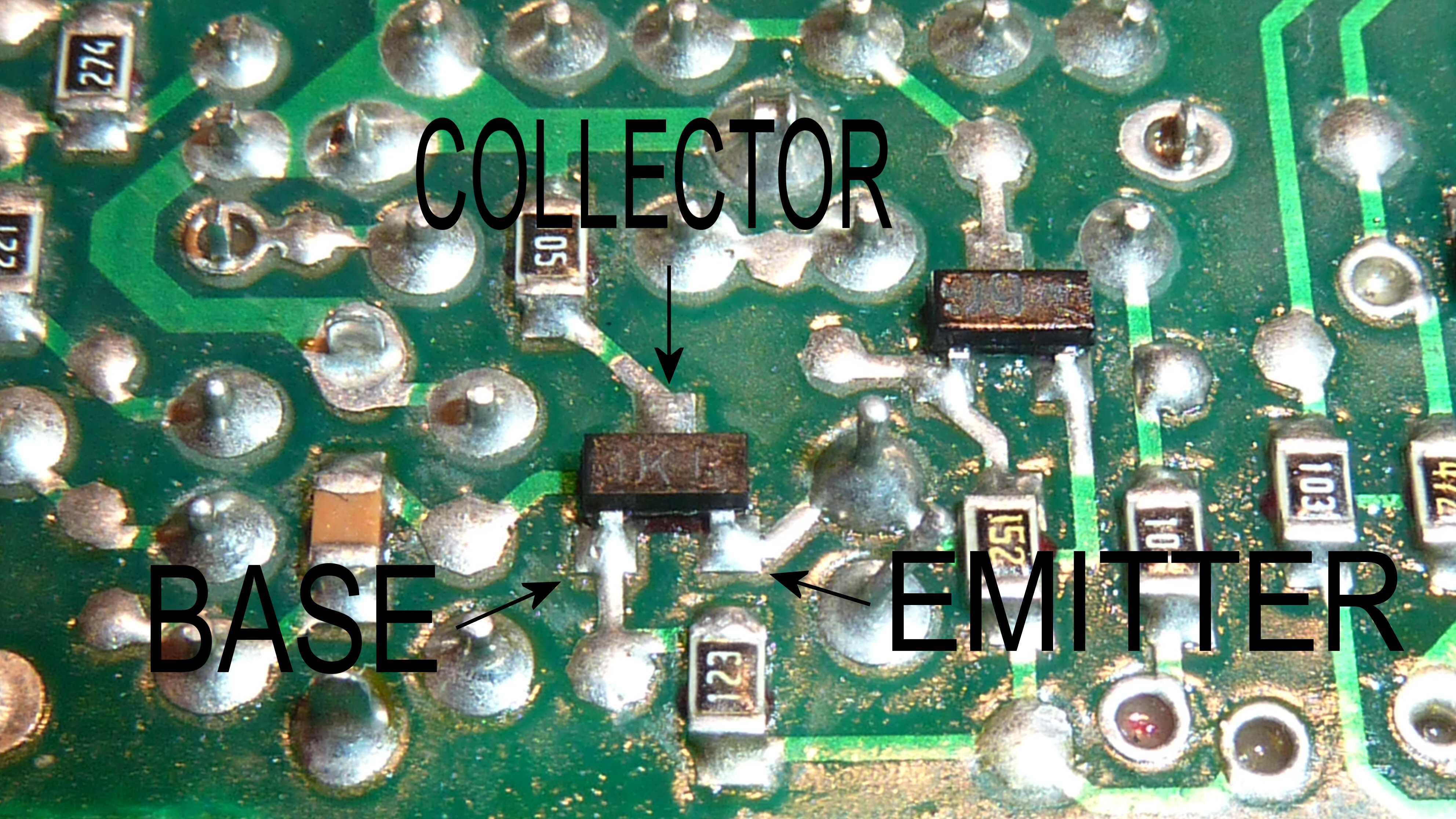

Identify SOT23 device. marking is 1K
fastline
Quick story, this is a small, battery operated micro controller for a single motor load. There is 1.3V being lost between the battery and the motor and so the nominal voltage of the battery is 3.6V but if it is dropped to just 3.3V, the IC will initiate a slow shut down sequence probably thinking it is out of power and needs to maintain enough to turn on the charger transistor.
I went through most components trying to find voltage drop and this one SMD component came up on the radar because it is losing .8V. Now, if it is a diode, I get it, but if it is a transistor, that V drop is a bit excessive. My in circuit diode testing has not proven this to be a diode yet so I thought I would ask.

I've got alot of old circuit boards with SOT23 packages marked " 1K ", they are all NPN transistors. That doesn't mean yours is a transistor though (although it is quite likely) as manufacturers just seem to pick random numbers for SMD parts.

We need to see the board really, but the sot23 device (if it is a transistor) should be a BC848B, the pin-outs are the same as the photo that SYE has sent you. You need to check that transistor for short/leakage with a suitable meter, but disconnect the motor first to avoid false readings. The small caps on the motor are just interference suppressors and should be ok. If the transistor checks ok then its probably the I/C.

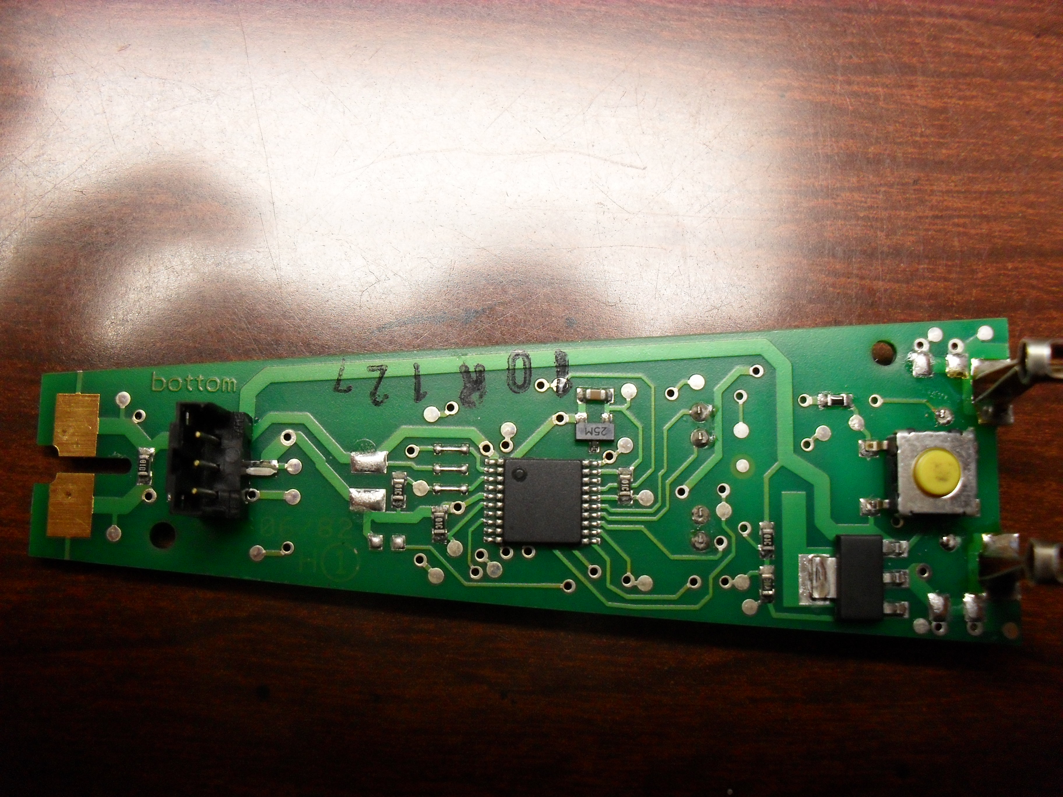

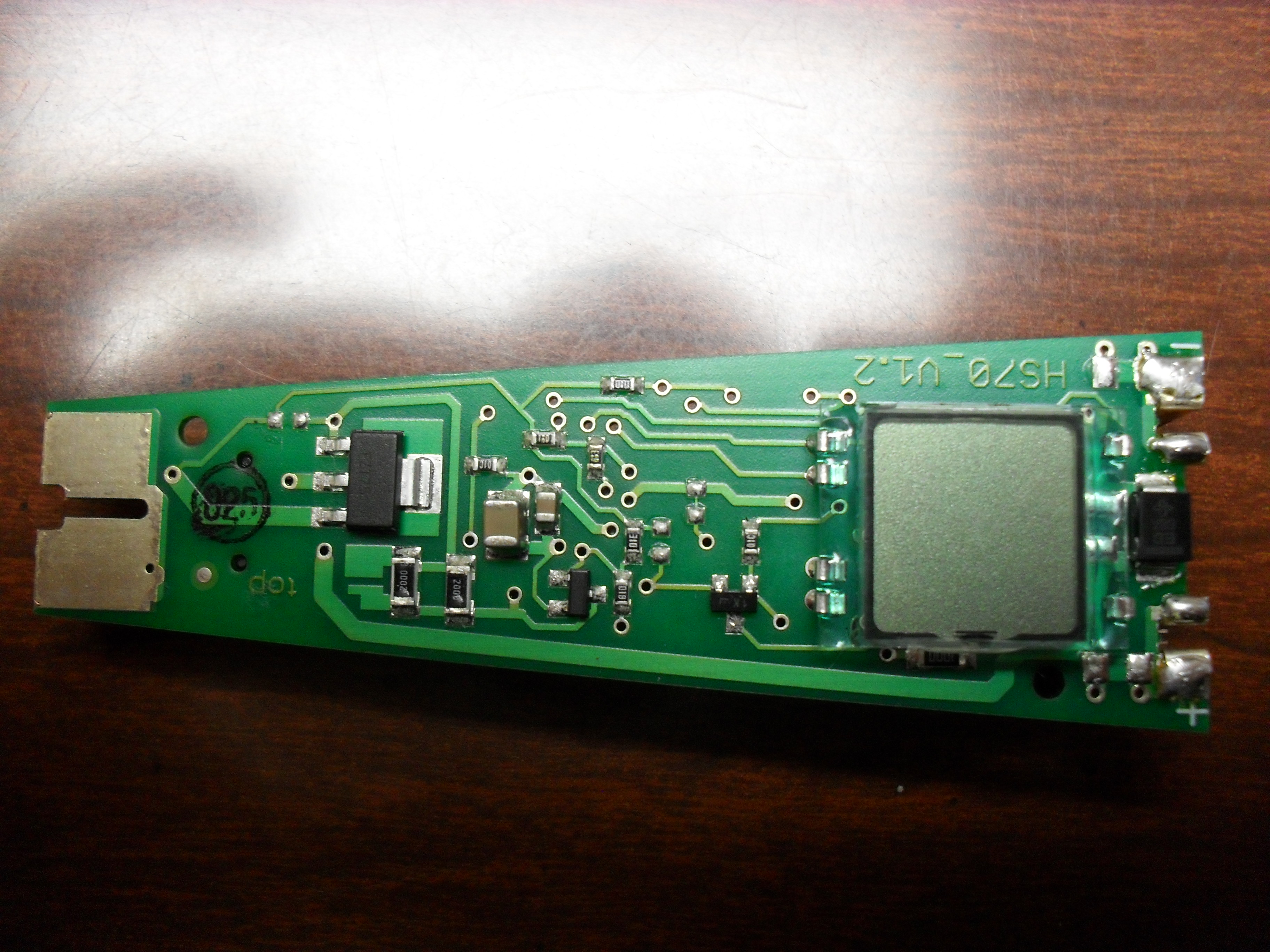

Here are the pics. The one switch button is the on/off button, the 3 pin plug is the input from the battery, and the contact pads to the left of it are for the DC power supply input.
The two tall arms by the switch are to connect to the motor load. The LCD just monitors the battery life I believe (always showing low which is concerning) and has an LED under it that lights up when running.
Pretty stupid simple circuit. Curious what you guys think of it! I am baffled.. I have never heard of ICs failing like this. I thought they either worked or didn't
If these do not have high enough resolution, let me know. I am on my lowest setting. I have 2 more to go but are usually difficult to load to forums so I rarely use them.

I agree with you about the microcontroller, if the LCD is working ok then it's probably alright.
I'm a bit confused about the part marked " 25M " , if it's a transistor then it doesn't appear to have it's collector connected to anything, if it's a diode then it's not connected in the way I would have expected.

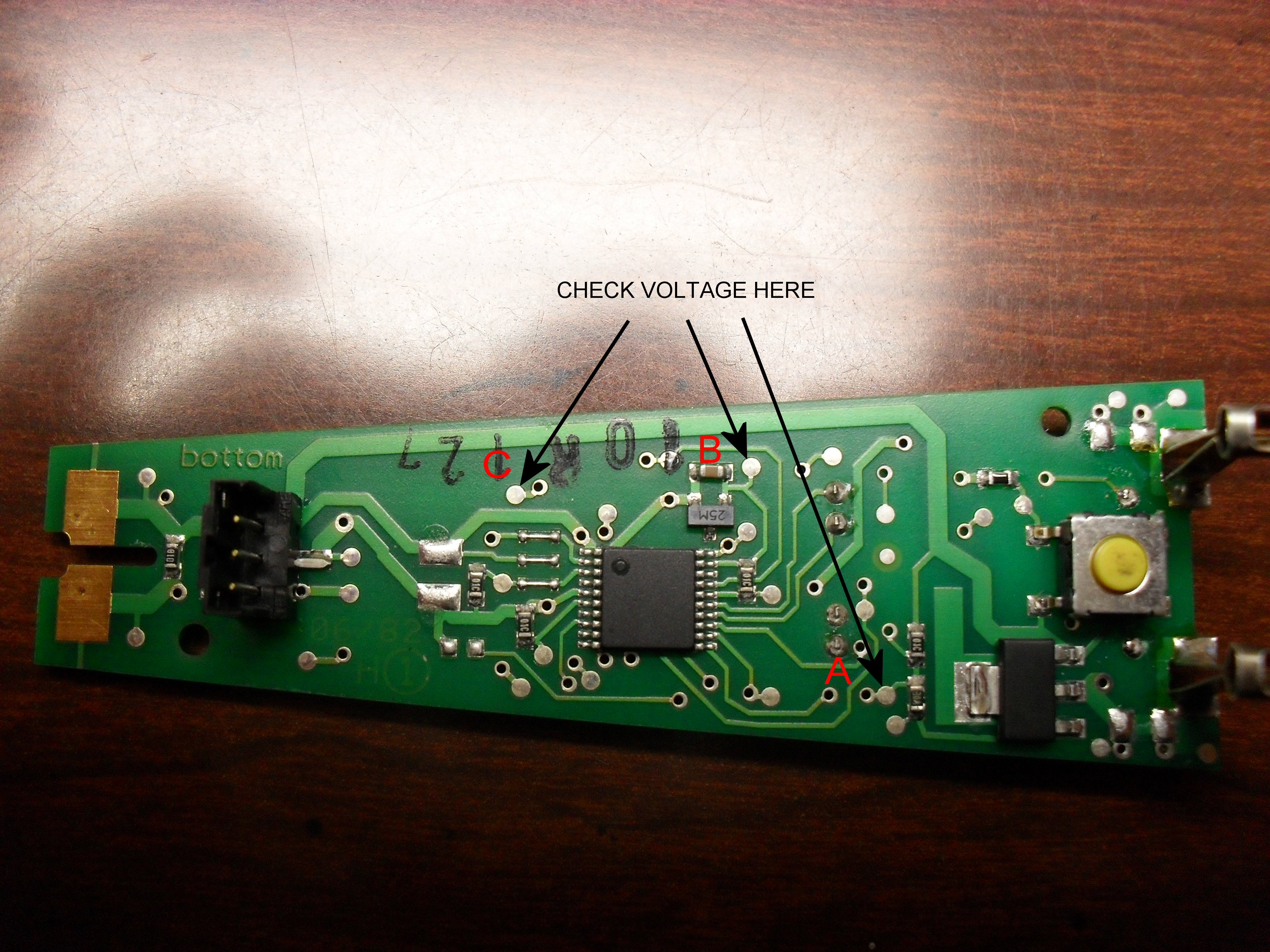

Could you check the voltages I've marked on the board.
Will do. I have testing this circuit with another battery pack as well as our lab power supply to monitor current and voltage drop. Even with the lab supply, it would not start a load reliably until I boosted it over 4V. The battery pack is 3.6V. the wife also mentioned it seems to run slower than it did when new which is inline with reduced voltage to the motor.
bat voltage - 4.0V
A - 3.0V
B - 2.7V
C - 3.5V
These are all with the circuit turned on but no load attached. I cannot get the load started with just the bat. I have to start it with the charger and then remove the charger and difficult to do unassembled but if that is what it takes, I will find a way. 5
This is the voltage to base\gate of the big transistor (I can't see any markings on it but because of its configuration I assume it's an NPN bipolar) next to the power switch, having 3 volts there should mean that your motor would run and if it doesn't I would suspect this transistor. However if you reckon it runs ok with the charger connected I'm a bit confused. It should work.

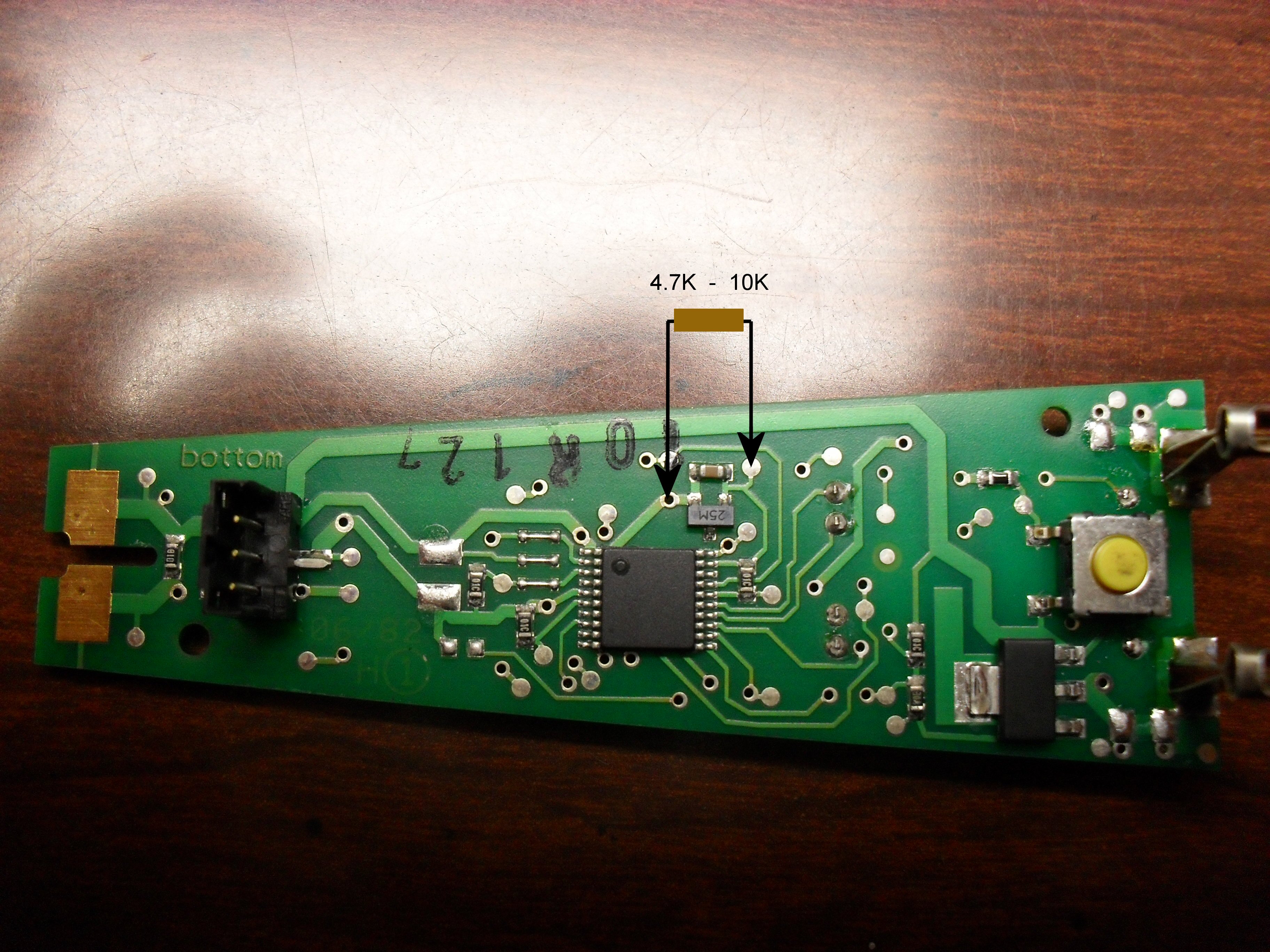

The part marked " 25M " is a Voltage reference. This should read 2.5 volts. Having 2.7 volts there may be why the micro thinks the battery voltage is a bit low.
I had thought that this was the sense output from the battery, but I'm not sure now, it seems low though.
You could try replacing the voltage reference with something like a 2.0 volt zener to fool the micro, might work, might not. I'm running out of ideas.
I think the charger works because it charges at a higher voltage. I will try to do some voltage testing with the charger plugged in
As a quick and dirty test to see if the voltage reference is faulty solder a resistor in parallel with it, the value isn't critical, 4.7K - 10k should do the trick. Pick a value that will bring the voltage on pin 19 down to less than 2.5 volts.
I installed a 4.7K across these pins and test showed exactly the same performance. Failed to start the load and battery indicator still showing the voltage to be low on the LCD when it is not..
